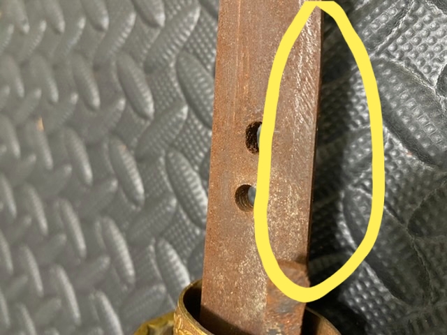

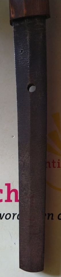

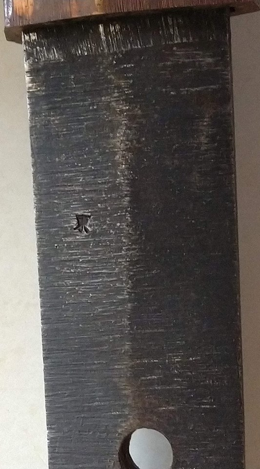

Here is the tang as requested. Looks like no marks. Looks like the two holes seem to add up to story that blade was replaced in a new handle. But it doesn’t look recent by any means. It was likely done by the original owner or by my relative?? but any all documents you may have on this story or anything else is much obliged!
Any care tips?
Thanks!

Update, as you posted the new pics as I was typing: Dang! That nakago (tang) is not a normal Type 95 nakago! This would imply the blade was made special for an officer rig, yet I don’t see why they would do the serial number, unless maybe they expected to get it back, like a rental.
 "Update, as you posted the new pics as I was typing: Dang! That nakago (tang) is not a normal Type 95 nakago! This would imply the blade was made special for an officer rig, yet I don’t see why they would do the serial number, unless maybe they expected to get it back, like a rental."
Altered at a late stage or even pulled from a mounted sword, and just chopped short, and remounted, so the mekugi ana is moved, and the hole for the end screw removed......

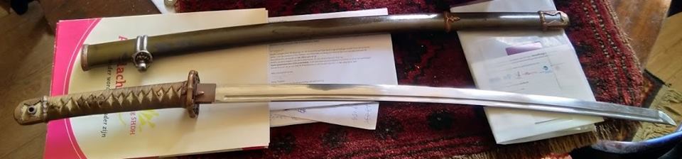

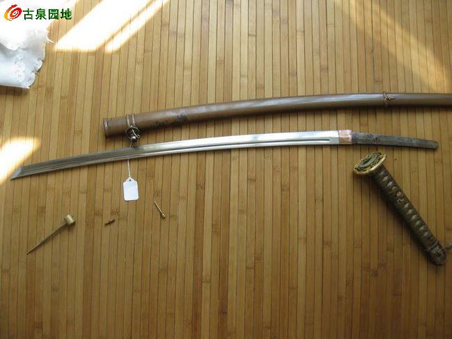

 And here we have another, posted by Leen Van Ochten on the Fb page. This one probably pulled at an earlier stage in the manufacturing process.
 Just chopped short, and remounted, so the mekugi ana is moved, and the hole for the end screw removed...... And here we have another, posted by Leen Van Ochten on the Fb page. This one probably pulled at an earlier stage in the manufacturing process.

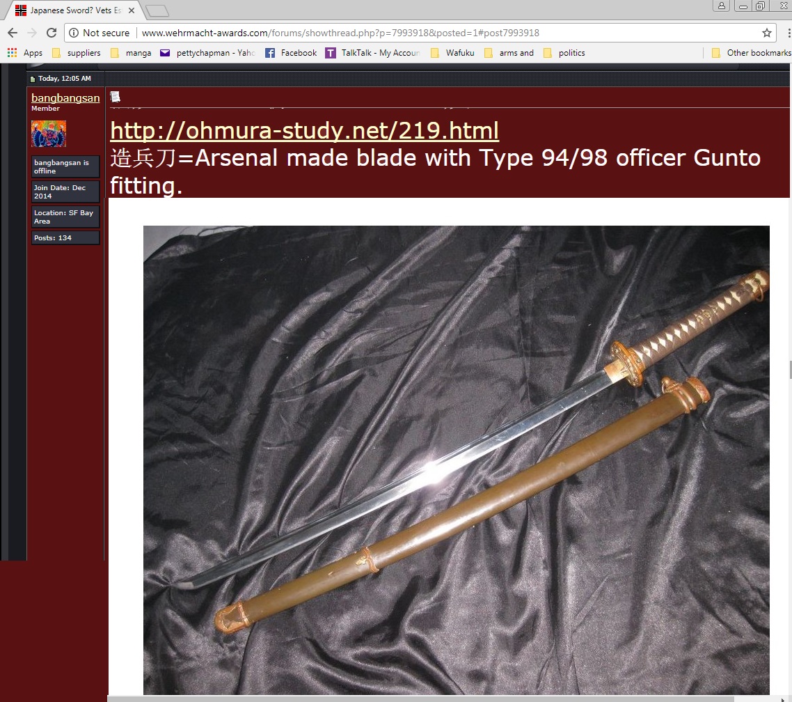

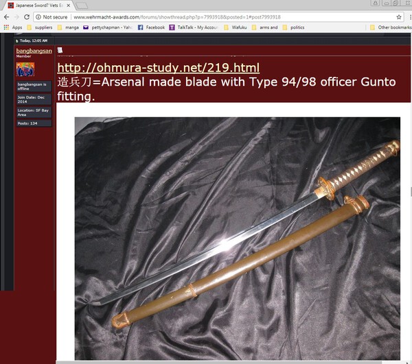

The photo That I post awhile ago and the other photos you post are 造兵刀 Zohei-to, a lot of  people confused them as 村田刀 Murata to.
It has arsenal made blade with blood grove but no Ser# on the blade, use type 98 mount.
The OP sword is modified(look like wartime work) NCO blade cut the partial tang to fit into type 98 handle,like many remount Koto.
Here is the link about 造兵刀 http://ohmura-study.net/206.html
 Not unique, but certainly not common. Here is one from a sellers site, posted some time ago by Bangbangsan.

I personally don’t believe it came out of the factory as is. Look at the pictures where the mune and the Habaki meet. There is an obvious gap. I think it’s a field work.
 To fit a blade to a hilt you either file/grind the tang to fit, or you excavate the hilt to fit. In this case it looks like the tang was altered, so we need to look for evidence of recent work, or a 70 year old patina on the reshaping.
 I other words, lots of detailed pic's of the tang.

Here are more detailed pics of tang. And deeper groves of the blade.
Let me know what y’all need more close angles of.
I can’t thank y’all enough! Let me know what y’all think.
Would cleaning rust off tang help identify any marks?

No need to clean the tang, it should have one or two arsenal mark, but nothing special.

This is plainly a repurposed 95 blade as the serial number, extra hole and cut-down nakago demonstrates. It is therefore entirely different to one of the unstamped arsenal blades which I believe are what you are referring to, Hamish? This is why we are discussing it.
The photos are not great, but the third one in in the post following Hamish's post clearly show where the nakago has been ground down. The blade was made to fit the tsuka, not the other way around. The second drilled hole is particularly crude, too. The original still shows the thread from the screw that used to hold the 95 tsuka.
