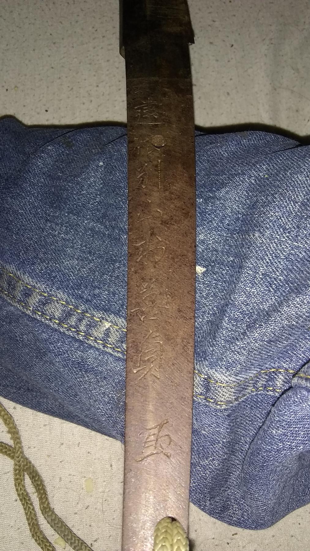

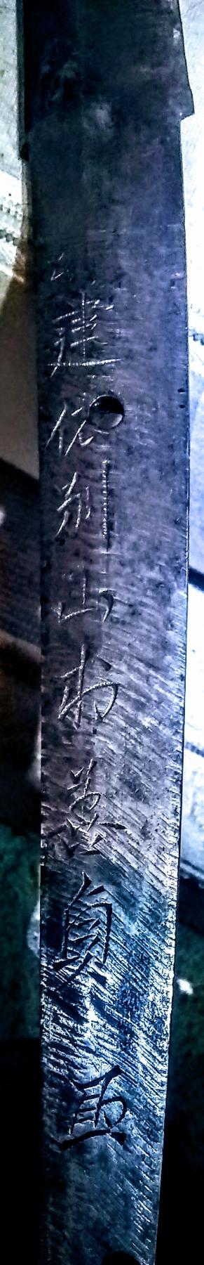

Help translating, hopefully not a gimei or at least a good one
Mjordan8691
建依別山囗善貞(花押)
Tateyoriwake Yama(?) Yoshisada + kaō
Tateyoriwake is an unusual name, originating in Japanese mythology, and appearing on at least one other sword posted to this site
http://www.militaria.co.za/nmb/topic/30320-help-translating-gendaito/
making me think it is a name used by a specific group or school of smiths.
Yama-something Yoshisada would be the specific name of the swordsmith (or his art name). I can't make out the kanji after Yama.

Sit down and broke out the old elbow grease, did some image editing, hope this helps.

I know the blade is ruined, but you might like to have some info on the smith. He was an army swordsmith (star stamp) and is from Kochi prefecture, Tosa City.
He was born in Meiji 33 (3 April 1900) and was still making swords in 1977. Here is a page from the "Gendai Toko Meikan" by ONO 1971 p.110.

Thank you very much. I'm excited to learn this. There is an inscription on the other side as well. If it's not to much, when I can I'll clear it up some and get a good pic.
