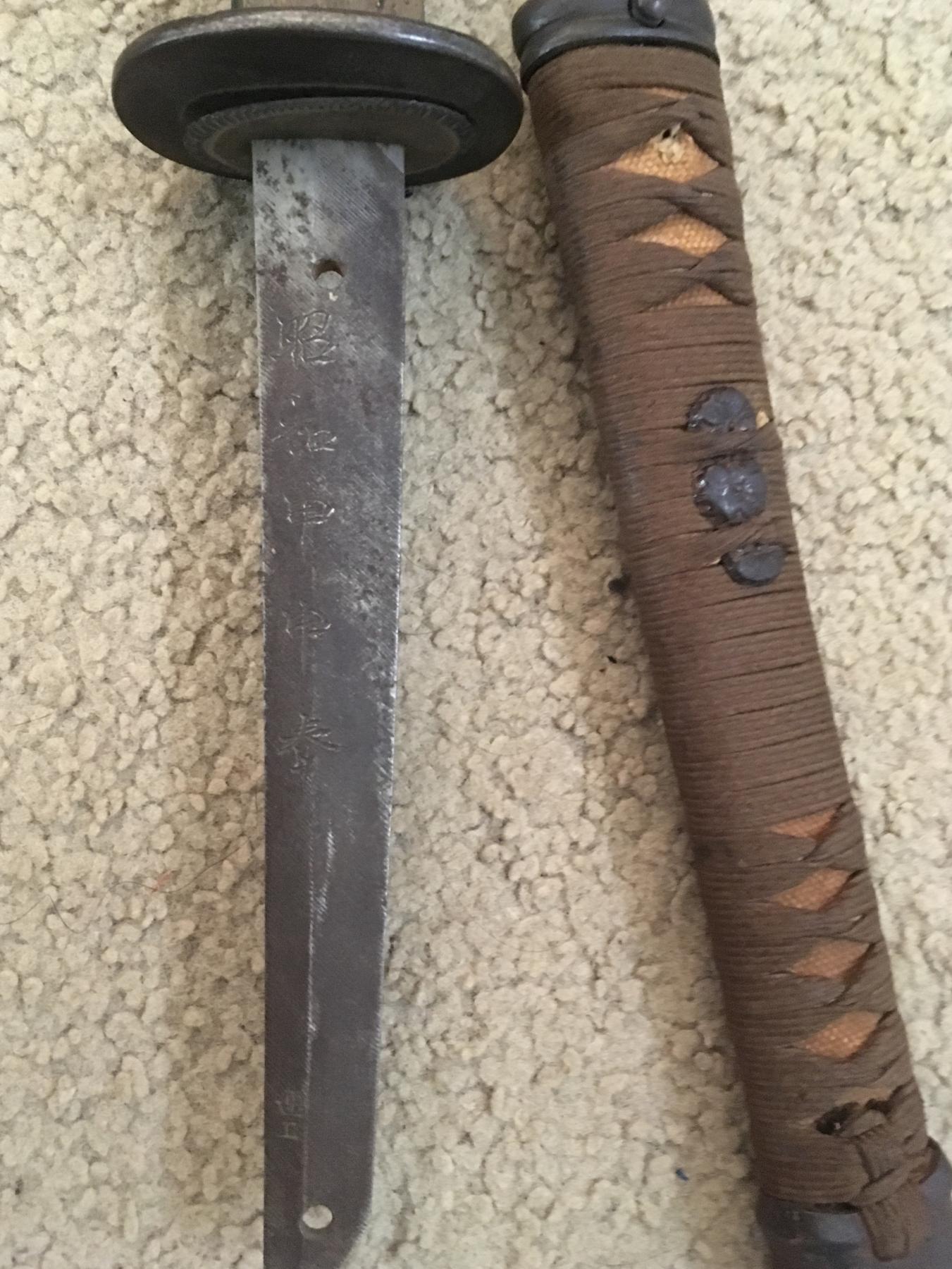

Found another '44 with Ren and "I" stamp. Don't have the serial number on it, but have messaged the owner. Hopefully he's still active!
Like Neil's, it's in Rinji, Type 3, mounts.
Ok, I've got 3 now, all Spring 1944: Se 2340, Se 3575, and "?" 199.

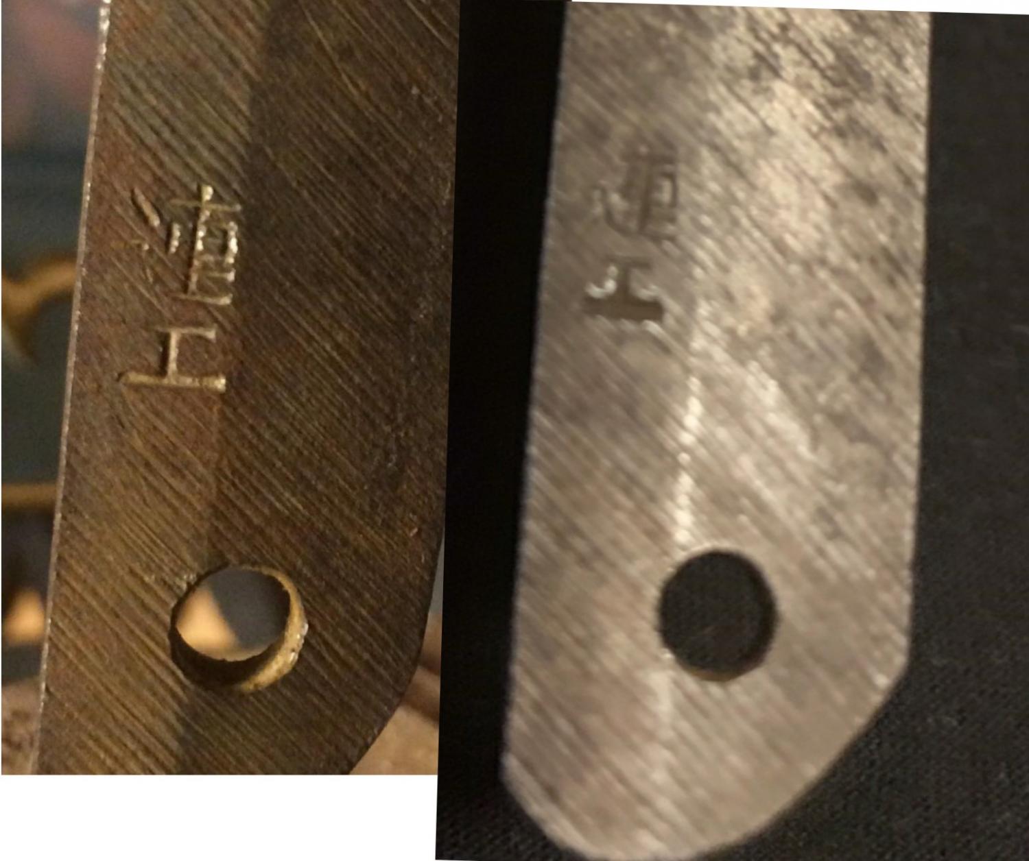

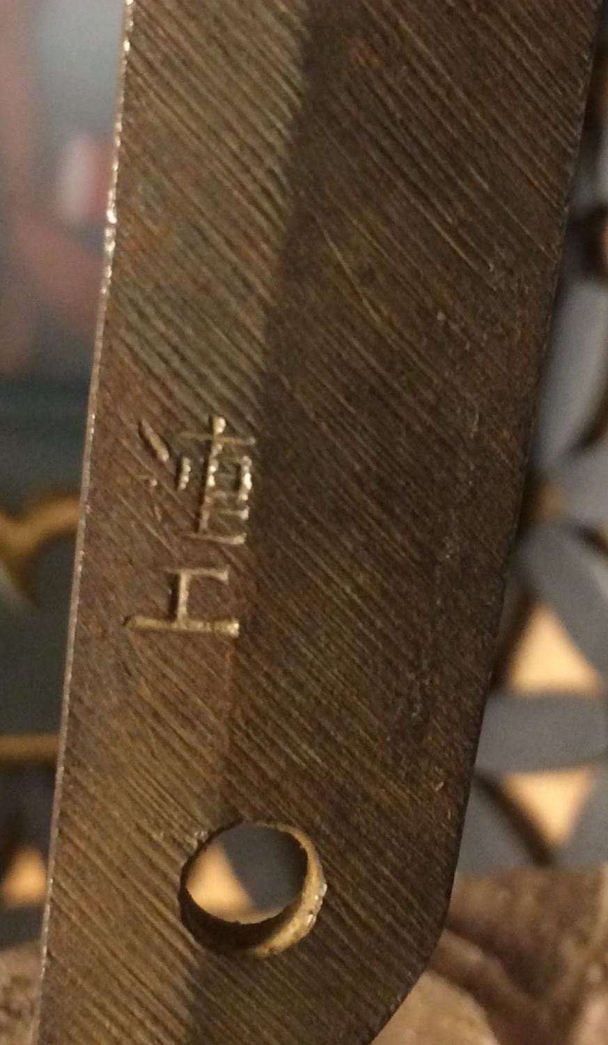

Had an interesting discussion with someone about the "I", or rail stamp. It was proposed that the "I" means, or represents "Factory or Work" in both Chinese and Japanese. If so, the Mantetsu logo simply says "Mantetsu Factory". Likewise, the combined "Ren" and "I" would say "Mukden Factory" and support the idea that these blades were made at the Mukden Arsenal, or at least finished from Mantetsu supplied blades.post-3487-0-29533400-1549506420_thumb.jpg

Had an interesting discussion with someone about the "I", or rail stamp. It was proposed that the "I" means, or represents "Factory or Work" in both Chinese and Japanese. If so, the Mantetsu logo simply says "Mantetsu Factory". Likewise, the combined "Ren" and "I" would say "Mukden Factory" and support the idea that these blades were made at the Mukden Arsenal, or at least finished from Mantetsu supplied blades.attachicon.gif msg-3887-0-95356400-1549495980.jpg

It's could be Chinese/Kanji "工"Instead of "I"=Work 工廠=Factory,工人=Worker.
is short verse for 大連 (Da Lian City),.奉天(Mukden)also called 沈陽(Shen Yang City), they both in 遼寧省(Liao Ning Province),but  distance between  two city is about 380KM/236Miles.
大連has one of the earliest Steel Factory called 達里尼鑄鐵廠 in Northeast China,it was built in 1901.
http://www.centunion...rovince-(china)
 "工" also could be short verse for "工字鋼"  ,means shape of the railway track,that's how it called in China/Manchuria railway industrial).
It's in the South Manchuria Railway&Current Ministry of Railways(China)logo.
I guess it's possible the Type 4 Mantetsu blade used railway track steel from 大連達里尼鑄鐵廠,maybe that's why has 連&工 on the tang.
"工字鋼"/South Manchuria Railway Logo/Ministry of Railways(China)Logo.
Thanks Trystan, very informative! Sorry about the "I". I just don't know how to do that with my keyboard, but I've got it now and can copy/paste "工", ha!

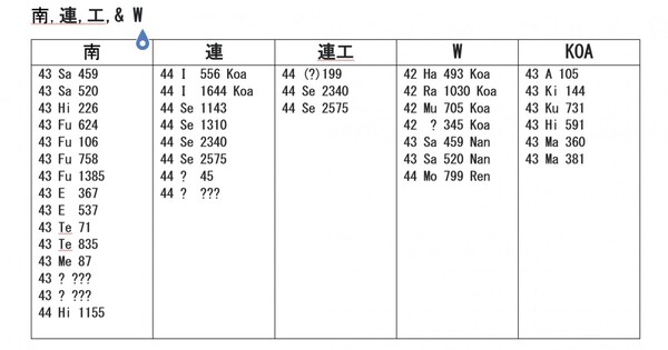

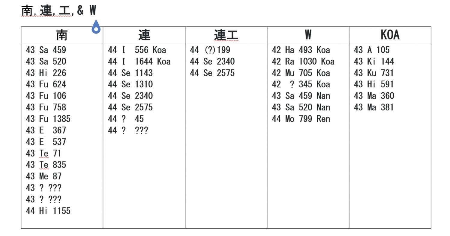

I've updated the Mantetsu Study Charts with tabulations on blades with Nan, Ren, Ren/工, and W stamps.
Out of 32 '43s, 14 have Nan stamps (and 1 '44 has it)
Of 11 '44s, 8 are Ren stamped, with 3 Ren/工.
I have 8 blades W stamped - 4 '42 (all Koa), 3 '43, and 1 '44
If our theory on the source of the W stamp being the Tokyo Arsenal finishing blades supplied by Mantetsu, as per Nick Komiya's document, it's clear the practice was in place a couple of years before the document's date of 1944. I suspect there were orders made in the previous years, and this single document is the only one we have knowledge of.
The existance of Koa Isshin blades in '43 & '44 raise the question of WHO was making blades with the Nan and Ren stamps. One option is that the SMR Mantetsu factory was making them all, and for some reason was making both Koa and non-Koa blades simultaneously. Another option is that, per Ohmura's theory, Mantetsu had taught the Mukden arsenal to make blades the Mantesu way and blades marked with Nan, Ren, and Ren/工 are Mukden manufactured. Option 3 is that Mantetsu was supplying unfinished blades to Mukden just as they were to Tokyo, and the finished blades were stamped by Mukden accordingly. BUT we have 2 '43s with BOTH a Nan and a W stamp, and 1 '44 with both stamps!!! This COULD bring us back to option 1, with SMR Mantetsu making them all and using Nan, Ren, Ren/工, and W stamps for reasons yet unknown.

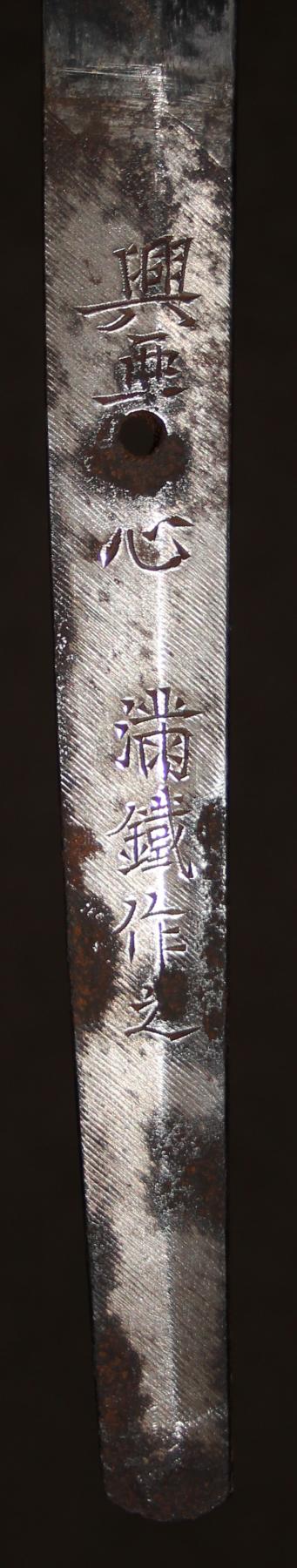

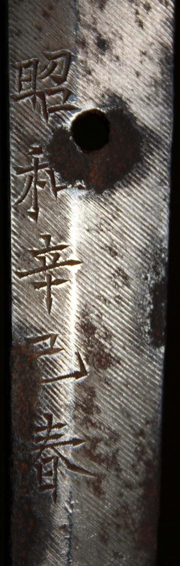

G'day Bruce and all,
Yesterday I looked over an old family edged weapon collection out of the woodwork, a real sleeper.  Two Japanese swords, a Burmese Dha dagger, six kris of various sorts, and a very smalI Indian Katar, the latter most unusual.
One of the Japanese swords was a Shinguntô with a Mantetsu blade, so I post here FYI.
Blade is 66.6 cm long, tang 21.3 cm.  Blade is signed KÔA ISSHIN      MANTETSU KORE SAKU and dated SHÔWA KANOTO MI HARU (Spring, 1941).with a nakago mune stamp.
BaZZa.
post-671-0-20735600-1552302960_thumb.jpg    post-671-0-05939200-1552302991_thumb.jpg
