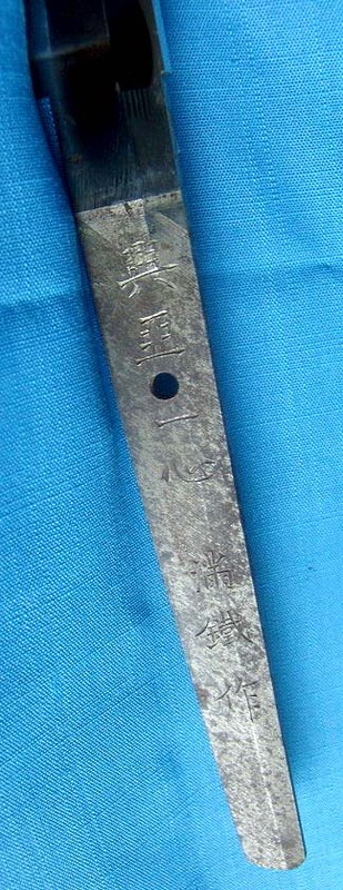

Are you in contact with the owner? I'd like to see if there is anything under the habaki. With that much pitting in the nakago, it is very easy to be misled. Plus, what looks like "Nu" to me is way too close to the first 8. Usually there is a bit of space between them, and often the katakana is just under the edge of the habaki.
Can you ask him for a picture without habaki?

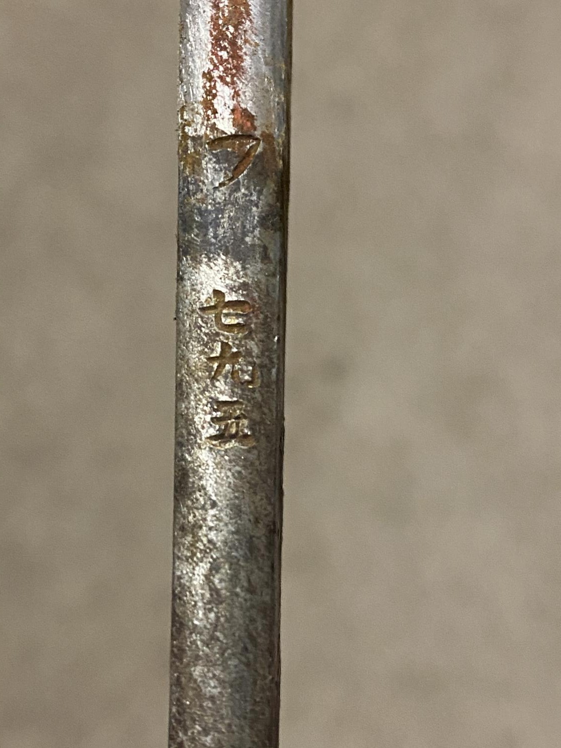

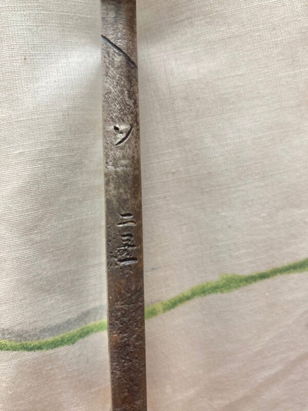

Bruce, when time permits, what is the nakago mune serial number for this combination SMR logo and Koa-Isshin 興亞一心 marked nakago?
http://www.militaria.co.za/nmb/topic/26165-attention-mantetsu-owners-a-survey/page-9?do=findComment&comment=302258
Edit: Answered my own question.  It has no nakago mune serial number.
http://www.militaria.co.za/nmb/topic/26165-attention-mantetsu-owners-a-survey/page-4?do=findComment&comment=274960

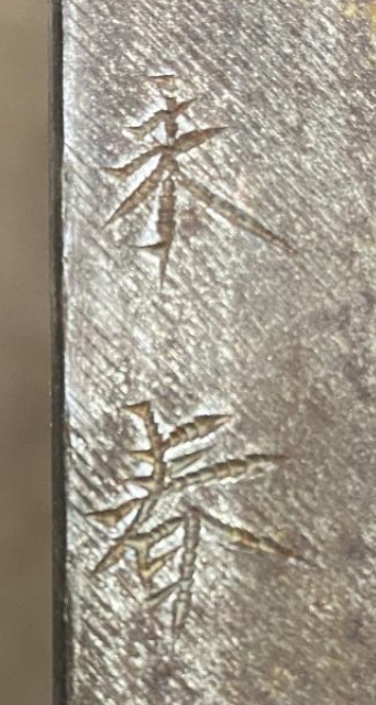

I like this one because the "writing" of the Spring kanji is sloppy. It's a reminder that the Mantetsu mei aren't cookie-cutter copies of each other. Different workers will have variations from others, and even could have a bad day and his own work may get sloppy.

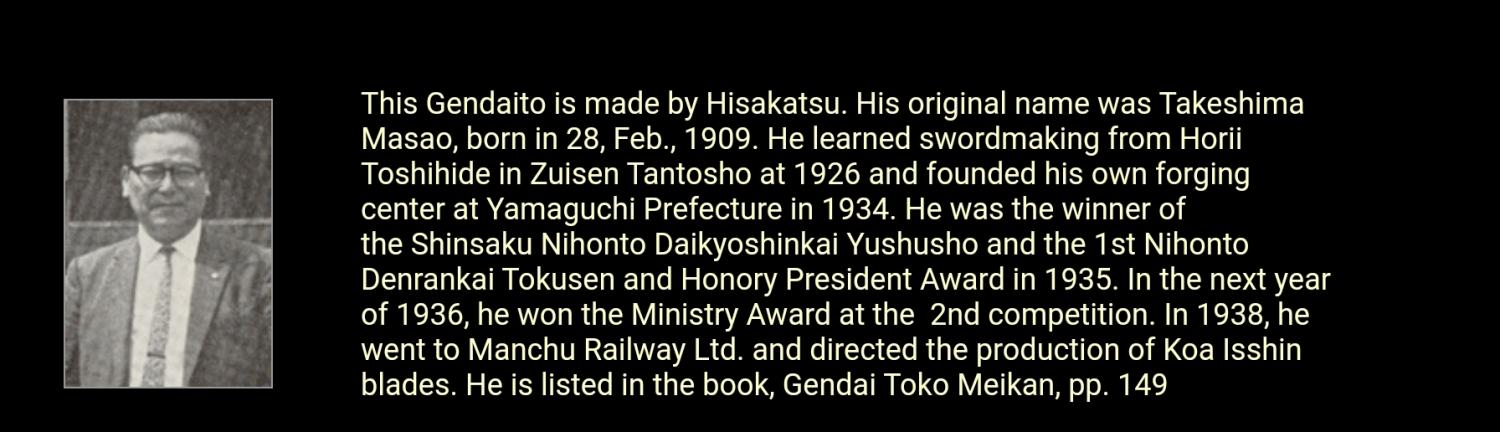

1. We know of Hisakatsu, real name Takeshima Masao, who "directed the production of Koa Isshin blades"

鈴木虹堂 Suzuki Kōdō
http://ohmura-study.net/998.html
http://www.japaneseswordindex.com/koa.htm
He also wrote a sword book entitled 在满洲日本刀杰作集 in 1937.
http://book.kongfz.com/89399/189042365/
Later on, Mr. Suzuki went on to design another sword called the "Tekkon".
Anshan:  Koodoo Suzuki, who has won a reputation in Japan and Manchukuo for his superior Japanese sword manufactured from sponge iron, will soon begin mass production through the aid of officials of the Manchukuo Steel Works.  Suzuki has been rushing the completion of various installations, such as the sword polishing laboratory within the company’s Research Department, so that production can be started soon.  His Japanese sword has been named the “Tekkon.”
[1944-10-13]
Edited by Thomas

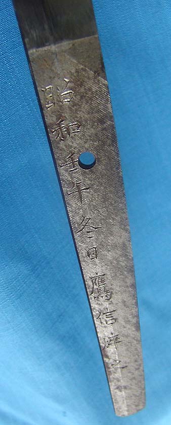

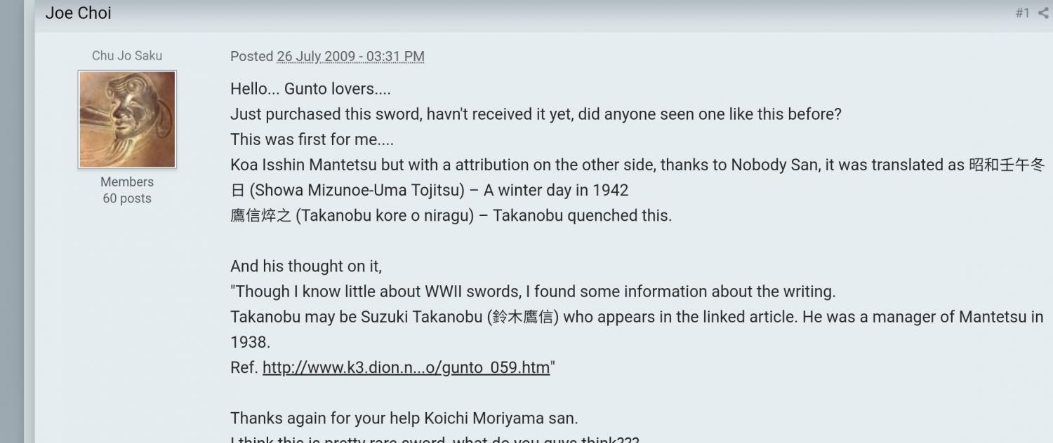

While we're on smiths - I have a Winter '42 blade with a mei that says "Takanobu quenched this." The NMB discussion says he was Suzuki Takanobu, a Mantetsu manager in '38. Have no idea if he was an actual smith. If anyone is able to dig up more on him, I'd appreciate it.
attachicon.gifpost-536-14196764691521.jpgattachicon.gifpost-536-14196764693808.jpgattachicon.gifSmartSelect_20190711-113422_Chrome.jpg
Bruce
鈴木鷹信 Suzuki Takanobu was Director of general affairs in Mantetsu Company.That sword wrote 鷹信焠之,焠 means Quench.I think Takanobu is not a real sword smith.He just participate one stage of sword making process,so he can wrote his name on the tang to make it specail ,he could keep it for himself or give to his friend as a special gift.It was just my thought.
