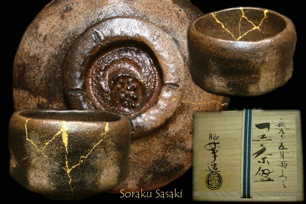

ken kata Posted March 13, 2018 Report Posted March 13, 2018 Hi Guys, I actually got to do a repair. as, One of my Soraku Sasaki Chawans broke.. I was told there is one small crack, when I bought it, but, last week, I was taking this bowl out of the box, and, I felt the wall "Crumble" . Ahhhh.. I wonder if there was enough stress from expansion and contraction due to the Hawaii Climate. Hope I can "save" this Bowl, and, if "Fortunate", make it look better with Kintsugi The video below, explains some ways Kintsugi shares the struggles of life. https://www.youtube.com/watch?v=EBUTQkaSSTY&t=36s Thanks for viewing Alton Reply to Piers Post below: Piers, I actually did not see any cracks when I receive the Bowl. I put is with the other "bunch" of boxes, and, forgot about it till the other week. When I was going to see what was inside the Tomobako ( I got so many Tomobakos laying around) , that is when I felt the side "break off"/ crumble. 1 Quote
Bugyotsuji Posted March 14, 2018 Report Posted March 14, 2018 Is that a shot of the crack before the complete break? If so, it looks more than 'one small crack'! Either way this could be a great chance to try kintsugi, perhaps experimenting on something else first. (No need to rush this!) Quote

ken kata Posted June 3, 2018 Report Posted June 3, 2018 Soraku Sasaki - Raku Chawan... Actually, did I do more harm? ... As, in the other "collectables", Collector's do not like "unknowns" to do work/repairs on Collectable Items. Again, watch this video about Kintsugi: https://www.youtube....UTQkaSSTY&t=36s Alton 2 Quote
TETSUGENDO Posted June 3, 2018 Report Posted June 3, 2018 Ken, Looks quite tidy and an accurate fit. Well done. Not to worry, should you (or another) wish to change things, the repair is reversible. Cheers, 1 Quote
Fuuten Posted June 6, 2018 Report Posted June 6, 2018 Indeed. If that was your first try with actual urushi you should be proud Looks great. 2 Quote
