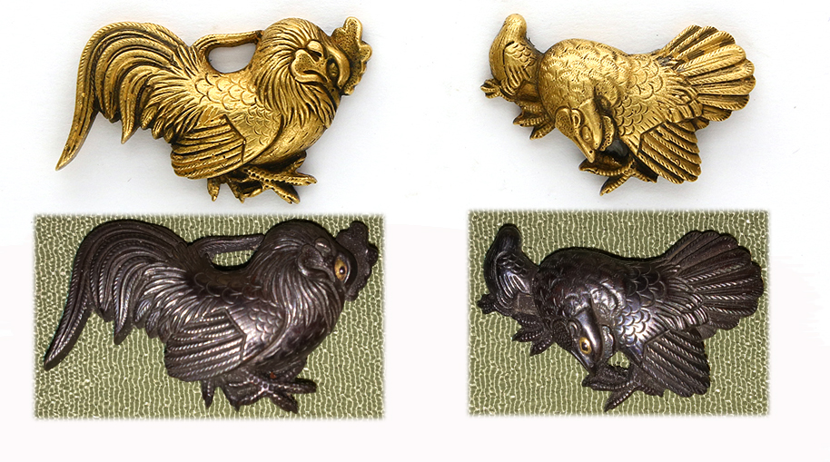

Tanto54 Posted June 2, 2017 Report Posted June 2, 2017 Folks, I was shocked to see a modern, rubber molded copy made from a pair of authentic menuki that I recently purchased from Japan. See the following post and string in the Auction Section: http://www.militaria.co.za/nmb/topic/22676-aoi-auction/ Here's the auction at Aoi: http://www.sword-auction.jp/en/content/af17114-目貫:無銘雄鶏-menuki-mumeiunsignedrooster I wanted to repost my comments here to warn our Tosogu Collectors who may not see the post in that section. THIS IS A FAKE!!! I am very sad to report that this is an exact, molded copy of a fine pair of Menuki that I own (and recently purchased). Mine is definitely the original. The one on Aoi shows signs of being copied using modern rubber mold techniques. Look carefully, even the tiny flaws on my very detailed pair are on the cast set from Aoi. For example, look at the tiny dent on the Male's wing feather in the middle. It is clearly a tiny dent on my set but is a blurry imperfection on the Aoi set (showing, along with many other similar points, that the Aoi set was copied from mine using recent modern techniques). I did not buy my menuki from Aoi, but I did purchase them from a dealer in Japan. I'm not accusing Aoi of being involved in the forgery (perhaps they bought it from someone else), but the set they are selling appears to be a modern, fake copy of my menuki. I'm going to reproduce this in the Tosogu Section so everyone see it. Be careful out there.... Quote

John A Stuart Posted June 2, 2017 Report Posted June 2, 2017 Is it real or Memorex? What assurance is there that both sets are not copies? John 1 Quote
Tanto54 Posted June 2, 2017 Author Report Posted June 2, 2017 Dear John, If you look closely at my set, you will see finely chiseled details that do not come out clean in the molding process. In the gold set, you can see casting bubbles in a few places (but none on mine). I've been doing this for many years, and I can assure you that mine is not a cast copy but the set on Aoi is a cast copy. Quote

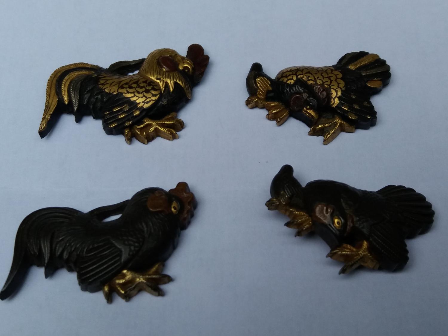

PhoenixDude Posted June 2, 2017 Report Posted June 2, 2017 Are these fake? I recently ordered these from seiyudo. Quote
Tanto54 Posted June 2, 2017 Author Report Posted June 2, 2017 Dear Jay, PM sent about your menuki. Quote

JohnTo Posted June 3, 2017 Report Posted June 3, 2017 I hope you have not maligned the Aoi, they may both be genuine and have been made by the lost wax process, which has been used since the bronze age. I recently went to the V&A museum in London where they had a video showing the casting of a complex bronze figure using this process. I have no knowledge of how Japanese tosogu artisans worked, but the process was common in China. So here goes my description of the possible process of making a simple shaped menuki. First step is to get hold of a suitable modelling material. Clay or wax is often used in the west, but ivory offcuts from the netsuke makers would be ideal. Glue the ivory to a metal or ceramic plate and carve out the face side of the menuki. Cover the finished carving with a releasing agent and pour on plaster of Paris to make a mould. Slip a knife under the metal/ceramic plate to free the mould. Pour a small amount of wax into the mould and swill round until the inside surface of the mould is coated. Repeat until the wax layer is of the correct thickness. A bit like making a chocolate Easter egg. Place small pieces of wood (matchsticks) at either end of the open side of the mould. Press any metal grips sometimes found on the inside of menuki into the wax. Fill the open mould with more plaster of Paris to make a single lump with the bits of wood sticking out. Once dry, remove the bits of wood, place the completed mould upright and heat until all the wax has run out. Pour in the molten metal of choice then smash the mould to free the menuki. Cut off the metal from the casting hole and finish of the menuki as desired (guilding, engraving, inlay, etc). The making of plaster of Paris moulds can then be repeated many times. Of course, if the original carving becomes damaged the flaws will show up in all subsequent moulds and subsequent castings. I ask the question ‘Why would a menuki maker not use this simple method for an object which has no complex undercutting?’ These guys had to make a living. Although they may have used the same mould they could probably vary the metals used as well as the finishes. The original carving would have been thrown away once it had started to deteriorate. In my opinion, the average tosogu was not in the habit of making one-offs. I have an iron sukashi tsuba which is an exact duplicate of one the NY Met. As theirs was bought in 1946, I doubt if mine is a later forgery, just a second example of a successful design used by the maker (I’ll probably post it later). Most bronze artists make multiple castings of their sculptures then destroy the original clay model. Did you know that there about 28 bronze castings of Rodin’s ‘The Thinker’ not considered fakes. Best regards, John Quote
Ford Hallam Posted June 3, 2017 Report Posted June 3, 2017 ‘Why would a menuki maker not use this simple method for an object which has no complex undercutting?’ Because the traditional technique for menuki manufacture is uchidashi. This is both quicker, requires less metal, less fuel and results in less unrecoverable metal waste. Many menuki are of copper which is notoriously difficult, to impossible, to cast. There is no evidence that lost wax casting was used in the Kinko traditions of Edo period Japan. Here's a link to a photo essay showing the steps in creating some gold menuki by the uchidashi method. My gold was somehow contaminated when I first melted it (the hazards of working iron and gold in the same space) which resulted in the ugly cracking you see. It took a little refining to clean out which is what green and red flux residues are about. 3 Quote

Tanto54 Posted June 3, 2017 Author Report Posted June 3, 2017 Dear John, Believe me that I would not make these acquisitions without clear proof. You have evidentially studied the lost wax method some, but it appears that you may not have studied modern vulcanized rubber molding and the wax injection method that is often used with the modern lost wax method of casting (and did not exist 50 years ago...). If you were familiar with those techniques, you would be able to see that mine is the original and that a rubber mold was made from mine and then wax was injected into the mold allowing multiple copies of my menuki to be easily made. This is clear because the chiseling and "original defects" in mine which are clearly not molded (e.g., dents, cuts and chisel marks) are clean and sharp in mine and while they also exist on the copy, they are smoothed over and rounded (showing that they are cast instead of original cuts). In addition, casting bubbles are evident in the copies and there are none on mine. With Brian's permission, I'll try to put together a pictorial explanation of the process and some of the telltale signs of casting over the next few days. If it is useful, perhaps it can be added to the other reference materials on the NMB. 3 Quote
Ford Hallam Posted June 3, 2017 Report Posted June 3, 2017 casting bubbles are evident in the copies and there are none on mine Quote
