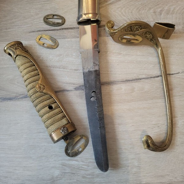

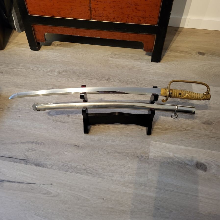

Hoping my sword falls in this category, here we have a mumei Uda blade, in an early 98 koshirae (perhaps from Kakenu shop).

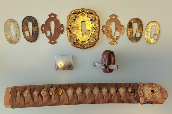

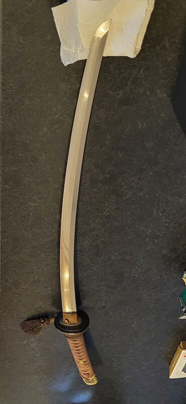

 beautiful shaped Kikusui Masanao
if you mount the original handle on one of these great swords, as long as the original koshirae is still there, such a tachi gets a completely new look

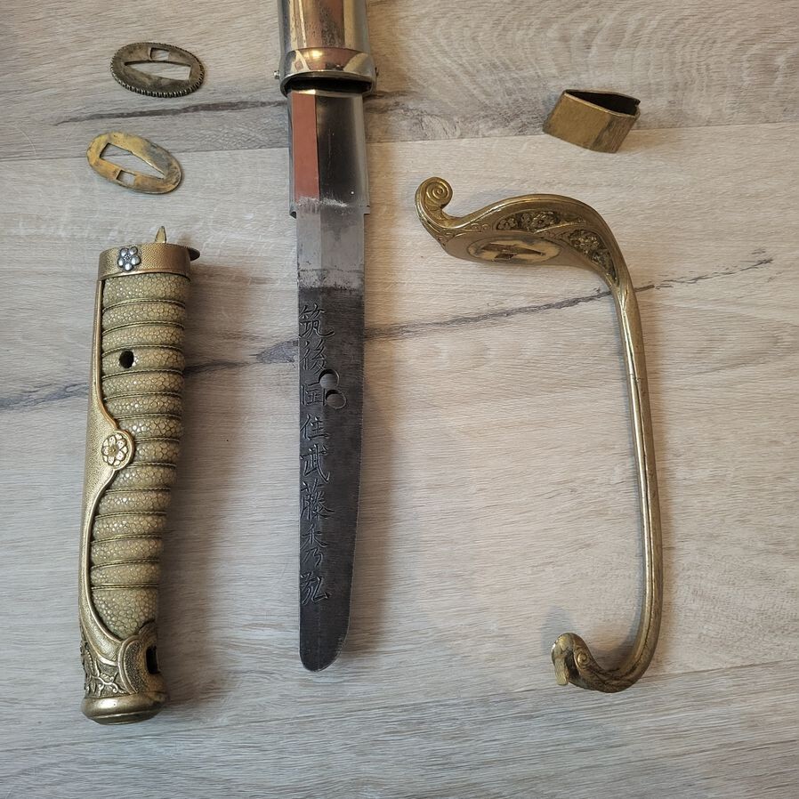

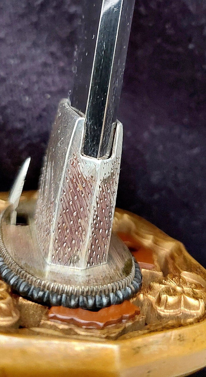

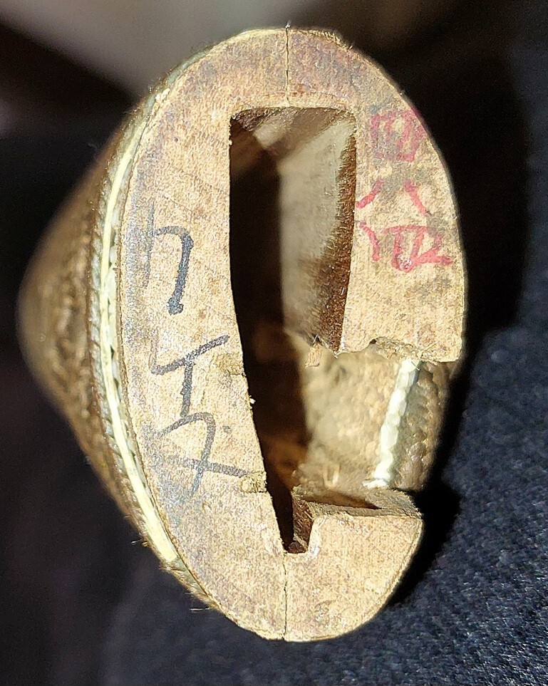

A little special feature
A beautiful original  D Guard sword ( Koshirae with Ka Mon) with a special fitted high quality beautiful ctrafted  sword balde by Muto Hidehiro
with imperial special date.
You can clearly see from the nakago, that it was  fitted  to the old handle.
It is also interesing that the thick quality habaki is signed on  the inside, (both sides).
I think I reconize    "Chikugo"

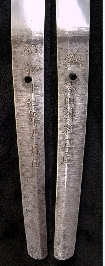

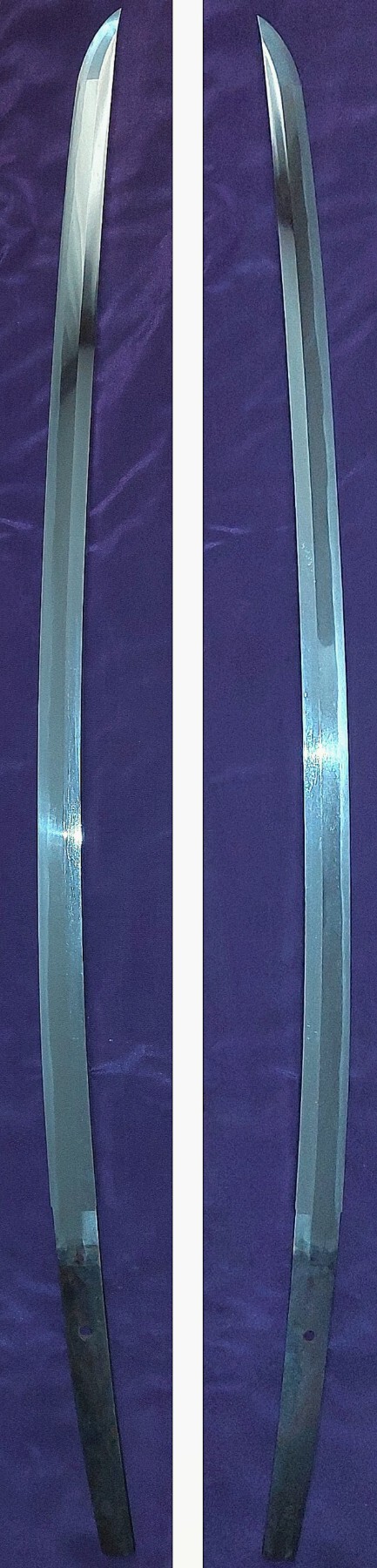

double publication of a blade by Moritsugu Norisada
Besides the illustration in John Scott Slough's Book "Modern Japanese Swordsmith 1868 til 1945
Oshigata Book on pages 137 u. 138
here in in Fuller&Gregory Oshigata book 106 Oshigata from 1985 on page 113 u. 114 an interesting oshigata of a  gift sword  to the governor of Burma

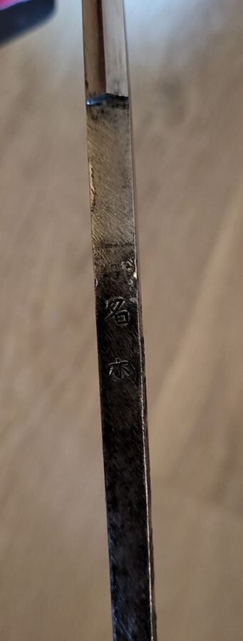

36 minutes ago, Volker62 said:
sorry  my computer uploaded picture 2 u. 3 incorrectly
Great example Volker. You acquired one of Moritsugu Norisada works?
I absolutely love my Norisada. Some excellent work, and I remember reading on a site somewhere how highly regarded he is.
Definitely one of my keepers. Unfortunately my nakago took a lot of rust or wear at some point, as it almost looks Koto, but enough remains that it was readable.

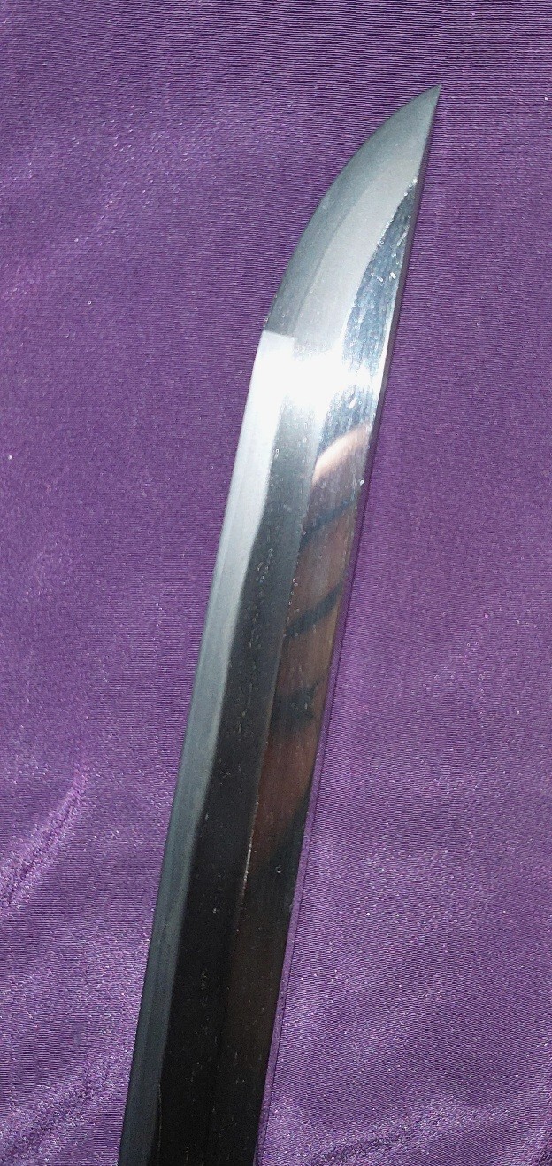

55 minutes ago, Volker62 said:
very very nice Brian
rarely found a Gunome choji hamon like this one for a Gendaito
looks like a shin shin to blade
Volker, You bought this great piece from Stefan? I was privately discussing with him original offer by eric and his claim that this blade is same from Slough oshigata book example :]
Maybe Stefan after our talk changed description? Check please yourself with book as there was difference but it could be caused by different angles. I hope that blade is in fact from Slough and in great shape.
Original ebay offer was in like september last year but long gone. Oshigata C page 138 if I remember correctly.

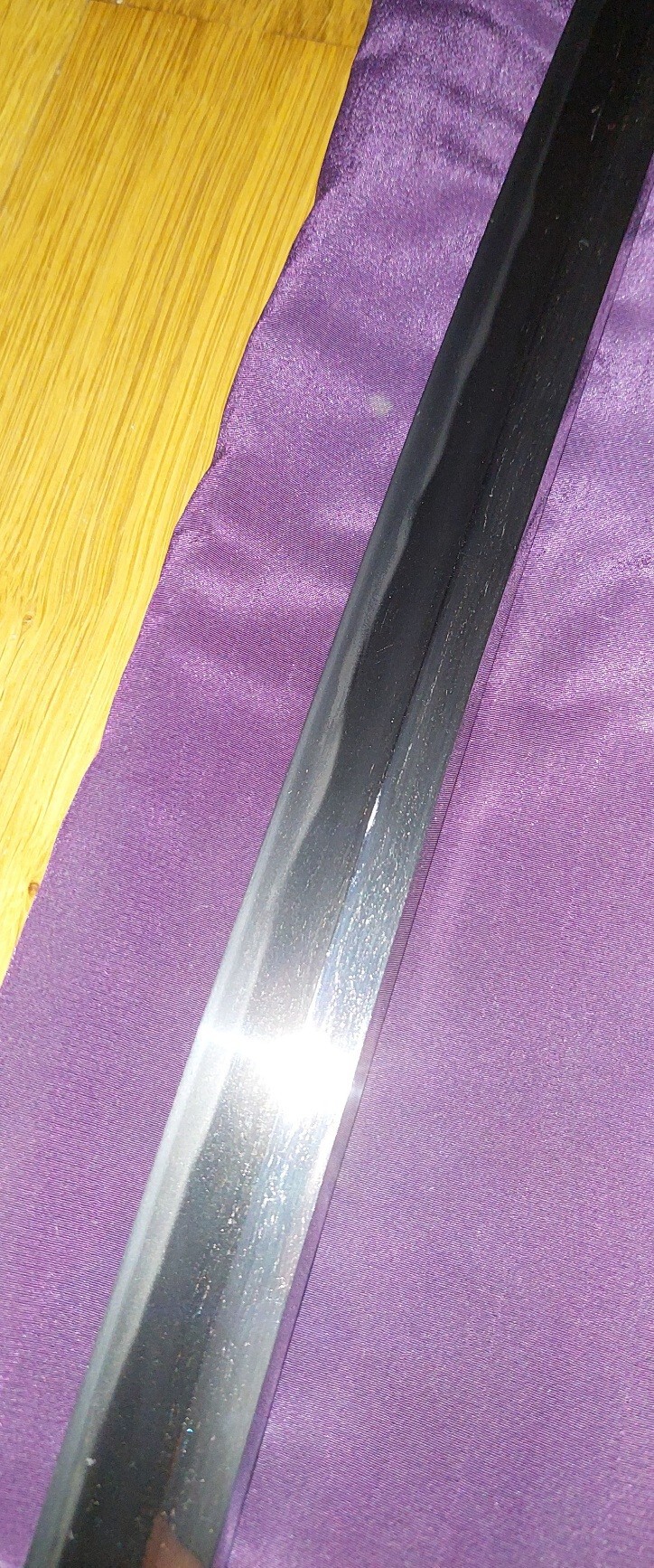

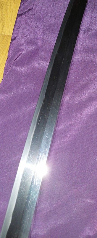

this one matsches the illustration of the depicted Nakago in John Scott Slough's book.
please see and check yourself, the one on page 138
thank you!
in my humble opinion clearly a oder made one
 very wide  Motohabe in it's beautiful original Koshirae
long kissaki
long Nagasa, very nice shaped blade
gunome Choji
overall in my opinion a real beauty
