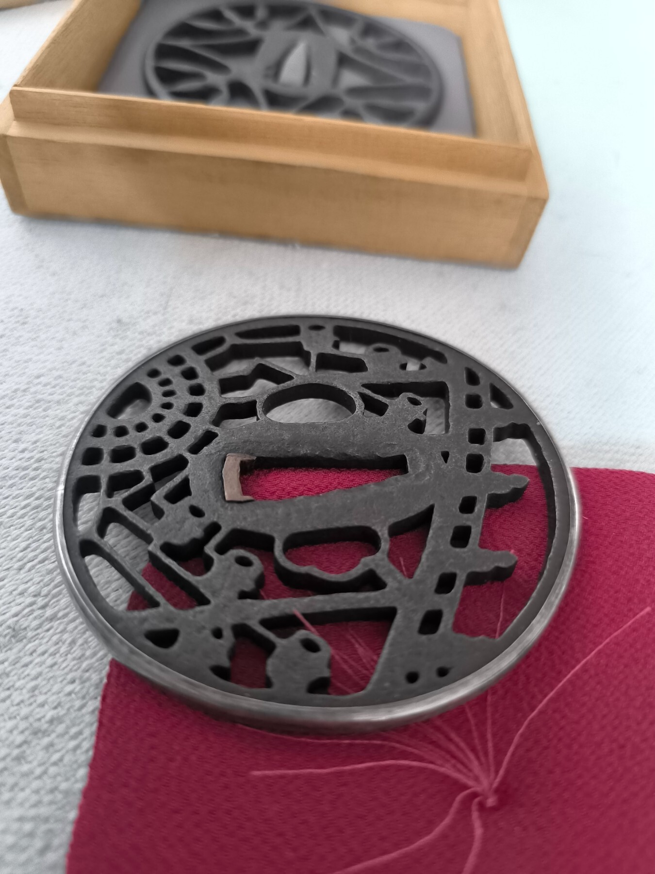

kaze ryu Posted June 11 Report Posted June 11 Hi! I have that tsuba with a silver ring in mimi. I think the ring its added for an old owner for additional protection. What do you think about that? 2 Quote
MauroP Posted June 11 Report Posted June 11 Hi, welcome at NMB. The "ring" is called fukurin (覆輪) and it's quite a common feature in many tsuba (tsuba doesn't take the plural tsubas). I'm quite doubtful about the additional protection a silver fukurin could eventually offer... The subject of the design is usually referred as Yodo suisha, usually seen in Daigorō or Kyō-sukashi pieces, but in your tsuba the thickness of the cut-outs looks too coarse for those schools. 3 Quote

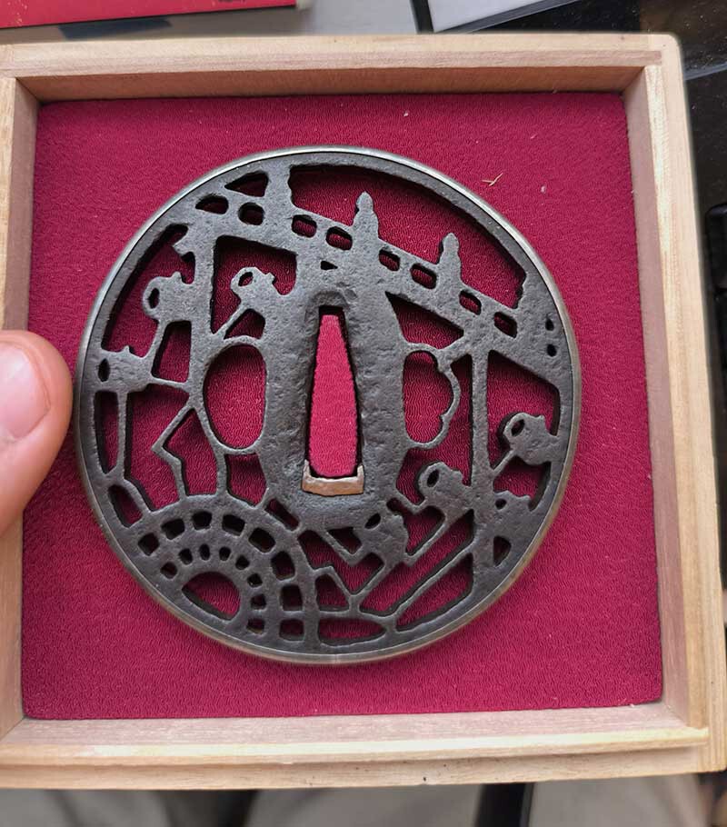

kaze ryu Posted June 11 Author Report Posted June 11 Grazie mille Mauro! I'm attaching another front photo. You're right, the details are rough. Any other thoughts on it? I'm always happy to read and learn more. 2 Quote
ROKUJURO Posted Wednesday at 06:29 PM Report Posted Wednesday at 06:29 PM Mike, nothing rough or coarse in this nice TSUBA! It is just the style! What are the dimensions? Quote
kaze ryu Posted Wednesday at 07:18 PM Author Report Posted Wednesday at 07:18 PM Hi Rokujuro. Thanks! 82 x 84 x 4mm in in a home measurement. Quote
Jake6500 Posted Wednesday at 07:29 PM Report Posted Wednesday at 07:29 PM Nice tsuba Mike, I'm usually not the biggest fan of open works and personally gravitate toward the solid stuff but this one has a nice design. Bridges were a major feature in mid to late Edo period art such as in Hokusai's famous ukiyo-e collection of bridges across Japan. The added fukurin is indicative not of additional structural protection or support, but of an additional aesthetic quality added to the piece. Think of it as the frame or border around an iron painting. 1 Quote
Dan tsuba Posted Wednesday at 08:12 PM Report Posted Wednesday at 08:12 PM Off topic but- I don’t know. Does anybody else see a possible cast iron tsuba here? Or I may need new glasses (which is a major possibility)! Quote
kaze ryu Posted Wednesday at 08:15 PM Author Report Posted Wednesday at 08:15 PM Thanks so much, Jake! Very interesting. I was just looking at Hokusai's ukiyoe of bridges online. Before your comment, I didn't see it as a decorative frame. I'm happy to build bridges with tosogu enthusiasts. Quote
kaze ryu Posted Wednesday at 08:39 PM Author Report Posted Wednesday at 08:39 PM Hi Dan, and thank you so much for your review! I'm no expert (yet), but if I search on Lens or Google, I can't find one exactly like it. I found the Yodo Suisha design Mauro mentioned earlier, but it's not the same. I'm becoming a bit wary of iron tsubas and always check online before purchasing one. I don't know many more methods to differentiate this. 1 Quote

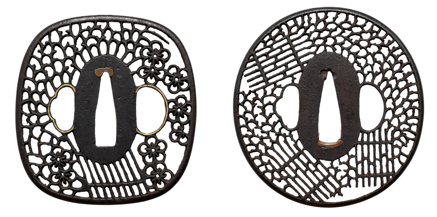

Spartancrest Posted Thursday at 01:10 AM Report Posted Thursday at 01:10 AM Hi Gran, welcome. https://world-seiyudo.com/product/tu-040525/ https://www.seiyudo.com/tu-040525.htm a Daigoro here as Mauro has said - it is much thinner work and perhaps more effeminate [No offence to the Samurai spirit ] From a Bonhams auction eight years ago - the site is no longer active. This one also has a silver fukurin - Sorry but these images are very small. https://blog.goo.ne.jp/tsuba_001/e/230a24e205e0cc960a170e796b26dc8f a Kyo-sukashi version https://nipponto-ken.fr/Chap8 Typologie Detaillee9.html Lets add a little gold. https://www.tessier-sarrou.com/en/lot/22961/5002947-japon-debut-epoque-edo-1603-1868-maru-gata-en-fer-a-decor?search=& supper fine gold work currently for sale https://www.samuraimuseum.jp/shop/product/antique-tsuba-for-samurai-sword-t-623/ I tend to like your's more than all these! 3 Quote
FlorianB Posted Thursday at 02:47 AM Report Posted Thursday at 02:47 AM Sorry to say, but this Tsuba has a very peculiar look, especially in comparison with the examples by Dale. Maybe not finalized…? Quote
kaze ryu Posted Thursday at 05:27 AM Author Report Posted Thursday at 05:27 AM Thanks, Spartan, for the examples. Those are the defined forms I found online. I fell in love with the examples with gold. and thanks Florian. Maybe? That would be fascinating. Quote

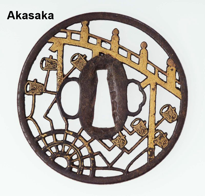

lonely panet Posted Thursday at 05:32 AM Report Posted Thursday at 05:32 AM The akasaka isnt AKASAKA. 1 1 Quote
Spartancrest Posted Thursday at 05:59 AM Report Posted Thursday at 05:59 AM 2 hours ago, lonely panet said: The akasaka isnt AKASAKA. Tell the French company that is selling it. Quote

lonely panet Posted Thursday at 07:17 AM Report Posted Thursday at 07:17 AM 3 hours ago, Spartancrest said: Tell the French company that is selling it. well if they dont know, maybe there best avoided 1 Quote

Curran Posted 19 hours ago Report Posted 19 hours ago On 6/14/2025 at 9:30 AM, Spartancrest said: From an old Japanese book https://www.jauce.com/auction/w1188787484 Tsuba Oshigata Horii Nagaoka Akasaka Tsuba 5 volumes Approximately 800 drawings Might be an Akasaka book, but the rubbing and the text next to it do not give it to Akasaka. I won't mention their attribution, as I don't agree with it. @lonely panet Hamish is right--- it is not Akasaka. While I owned an Akasaka of similar waterwheel design, I don't think I have ever seen an Akasaka of this specific waterwheel and bridge design. I've seen A LOT of Akasaka. Too many. This design gets pegged as Kyo-Sukashi about 75% of the time. The other 25% depends on various things. I have seen it in a very Owari execution at a few times. 2 Quote
Spartancrest Posted 12 hours ago Report Posted 12 hours ago I agree with you Curran, . . I was just the messenger. Just supplying more examples for kaze ryu/Gran mike. This papered piece is attributed to Daigorō - does anyone know the differences between Daigorō and Kyo-Sukashi? https://world-seiyudo.com/product/tu-040525/ 1 Quote
lonely panet Posted 10 hours ago Report Posted 10 hours ago Diagoro i think is pre kyo sukashi school 1 Quote
