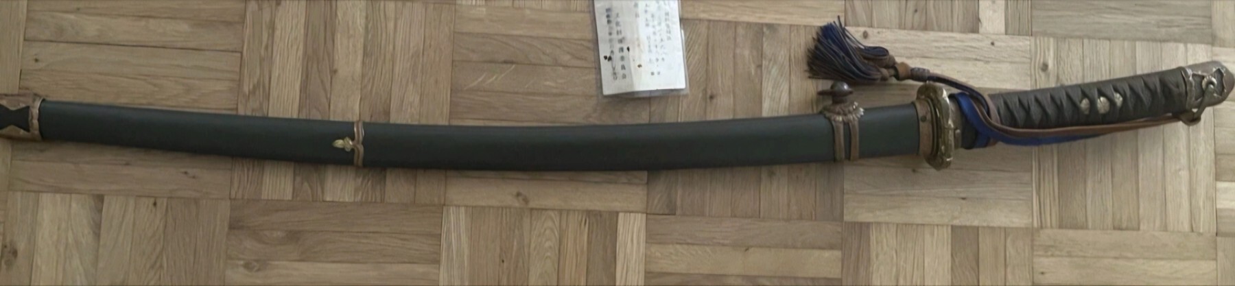

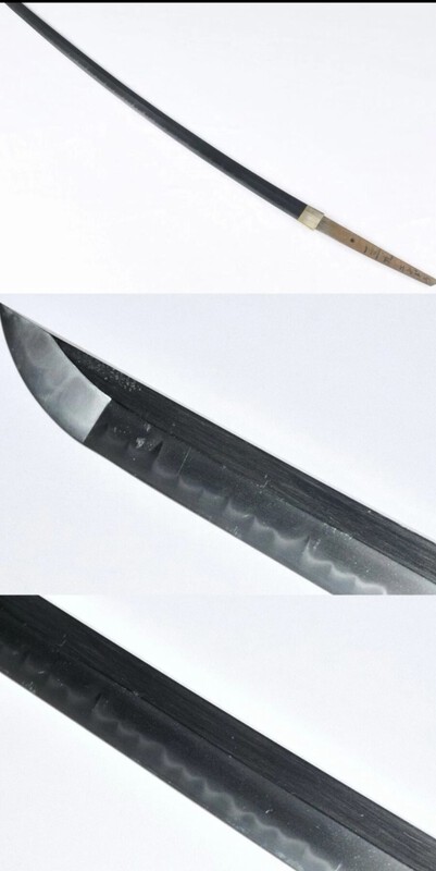

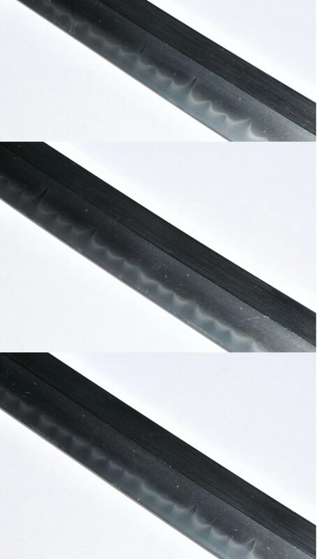

Rawa Posted June 2 Report Posted June 2 Im able to buy this in great 98 type koshirae. Im more intetested in koshirae but as usual I have to buy it with sword. Please tell me what you think about this hamon. No star so it should be showato in some way but it also have torokusho. Quote
Bruce Pennington Posted June 2 Report Posted June 2 Beautiful hamon! Oil quenched. My opinion, but I find the early showa-stamped blades to have been really well made with great hamon. 2 Quote
SteveM Posted June 2 Report Posted June 2 Some WW2-era blades have torokusho. Some even have NBTHK papers. I think there has been a gradual reappraisal of the term "art sword", and relaxing of standards that were formulated in the immediate post-war era. This sword is an example of that. 1 Quote

Mister Gunto Posted June 3 Report Posted June 3 Even if it this one doesn't meet the standards to be called a "Nihonto", it's still a beautiful and excellently made authentic Japanese sword, by a well-regarded smith no less. I think as time passes, the Japanese are starting to get past the old "Showato" label, and are becoming able to look at the wartime-period blades and realize that some of them are quite good. Also, any pics of the Type 98 koshirae? Quote

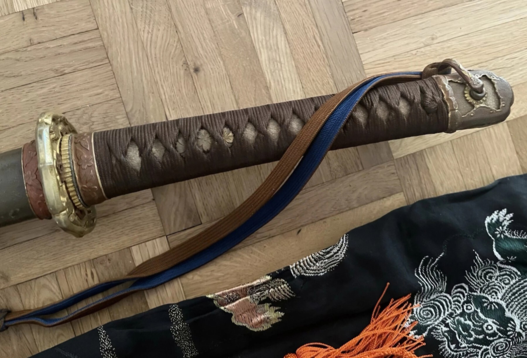

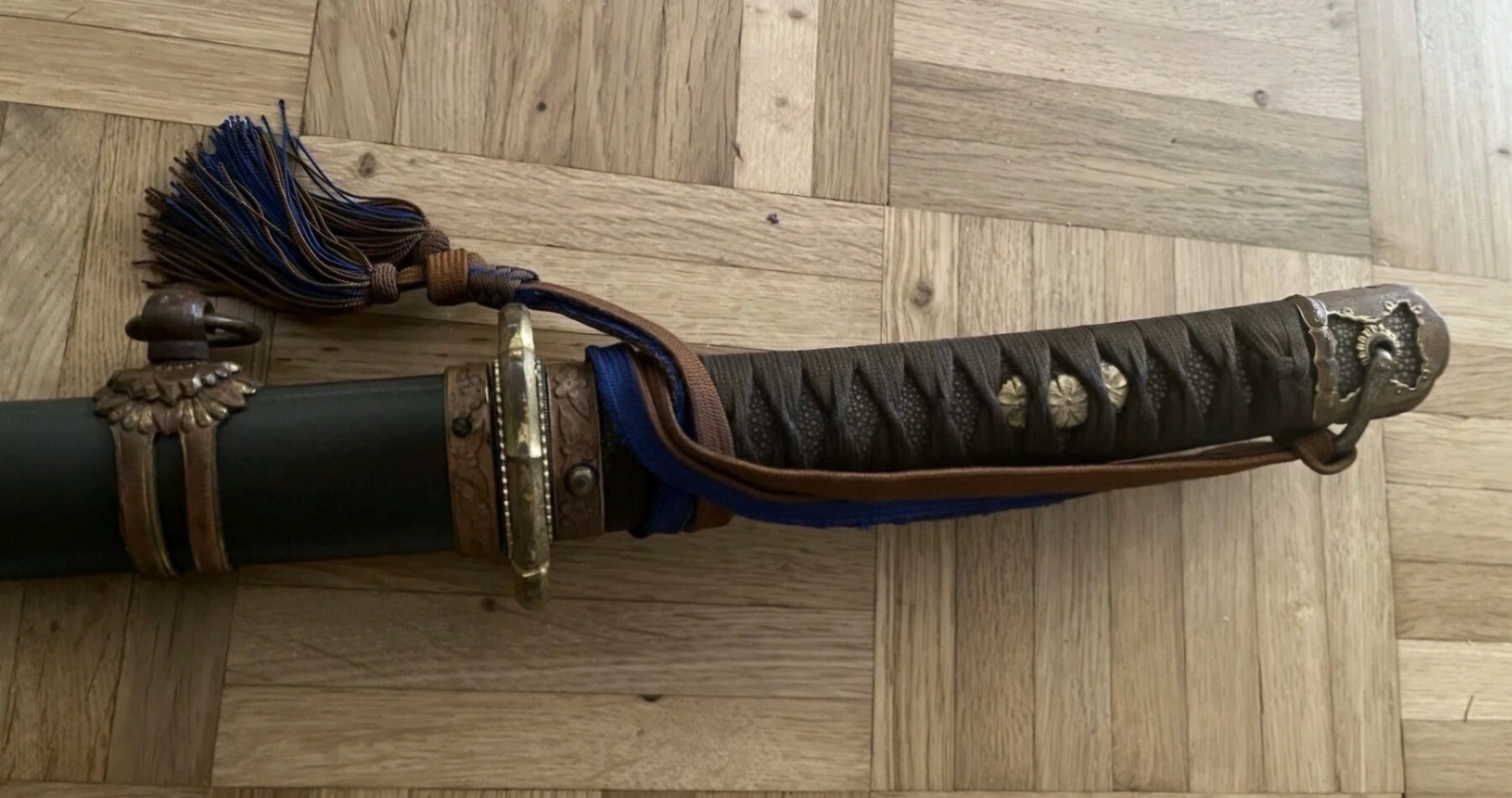

Rawa Posted June 3 Author Report Posted June 3 I'm sorry for making rumpus. It wasn't mine intention at all. Old info maybe is outdated. https://www.japaneseswordindex.com/showato.htm I was asking about quality of it. If it would ever be repolished would hamon [sambon-sugi?] be destroyed? Also seller stayes that blade is handmade... @Mister Guntokoshirae photos, saya and release button are not top notch. 1 Quote

Navy Posted June 3 Report Posted June 3 Judging by the dark spots on top of hamon, to me this one is oil quenched, thus falling in the non- traditional made category, lacking the water quenching requirement. Quote

ROKUJURO Posted June 3 Report Posted June 3 6 hours ago, Rawa said: How do you even understand simple term "handmade"? -as traditional hammering? Not using autohammer? Not interchangeably as "traditional"? How are swords named shinsaku [current era swords] made now?..... In this context, handmade traditional sword-blades are understood to be made from TAMAHAGANE. The steel of these would have been purified by forging, folding, and fire-welding a number of times before being forged out to its final shape. Traditional quenching in water and polishing without machines would follow. This applies to GENDAITO and SHINSAKUTO. There is no rule about the use of a power-hammer: You still have to hold the blade and guide the action, so this is not considered as "machine-made". It all depends on the situation in your forge: If you have no apprentices, the power-hammer will help with the raw work. There were several methods to produce wartime blades. SHOWATO are made from industrial steel without folding and fire-welding. As far as I understand, there are rare exceptions to this. Modern alloyed steel cannot be water-quenched without a high risk of cracking. Oil-quenching generates a good hardness with little risk of KIZU, but does not produce HATARAKI in the steel as we see them on traditionally made blades. There will be no NIE formations, and the HAMON is rather plain and without much variation. If you compare a traditional blade and a SHOWATO side by side, this will be obvious. What you like and find interesting is a matter of personal preference and taste. 3 Quote
PNSSHOGUN Posted June 3 Report Posted June 3 Typical Type 98 with non-traditional Showa-to by one of the well regarded Gendai Tosho of the period, nothing really exciting apart from the condition. 1 Quote

Brian Posted June 3 Report Posted June 3 Yes, we have to get used to the fact that when we say "arsenal" or "machine made" or Showato etc etc, we mean not 100% traditionally made, and likely oil quenched. They were still made by a smith, could be forged and hammered (power or otherwise) but not considered Gendaito. Handmade? You could say that. But on a mass production and fast basis, and oil quenched. When we say Gendaito, it used tamahagane, and was water quenched. Excluding those odd swords that fall somewhere in the middle. But this one is oil quenched, and the stamp is a clear indicator that it is not a Gendaito, whether it would paper or not. 6 Quote
Mister Gunto Posted June 3 Report Posted June 3 Considering the age, (going on 80 years now) and that it was carried by a Japanese Officer during the war, the koshirae looks very good! The darkened same isn't exactly rare, but still uncommon. I have no experience with Shinsa, so I'm not sure if this smith's name would be enough to get it papers, or if they would reject it due to the Showa stamp/ Non-Gendaito. Regardless, you have a very nice Wartime Type 98 sword! There are so many out there in far lesser condition. Quote

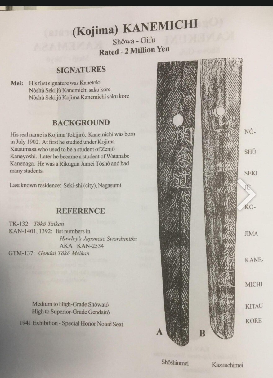

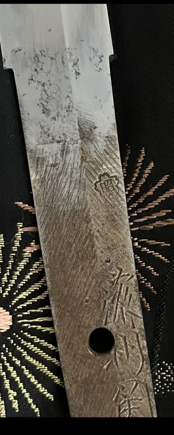

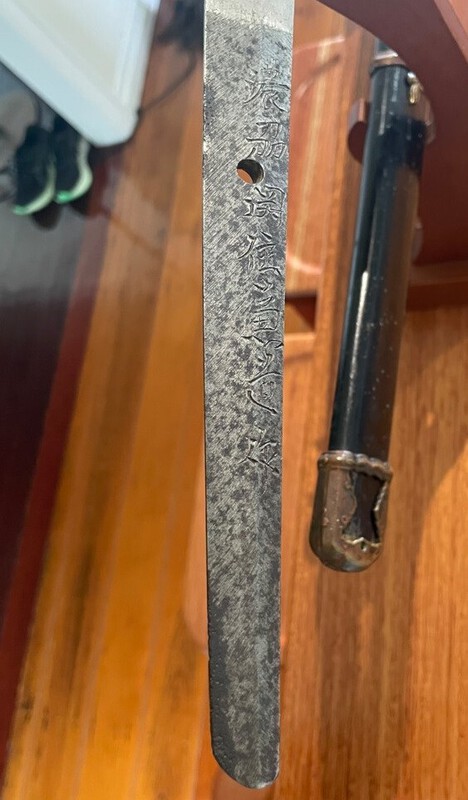

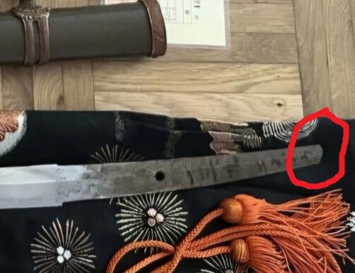

Bryce Posted June 4 Report Posted June 4 G'day Marcin, Is there any chance you can post a good photo of the nakago showing the complete mei and nakago jiri? I ask this because from your photo it looks like the nakago jiri is a very unusual shape for Kojima Kanemichi. I wonder if it may actually be by Kanesane? Cheers, Bryce Quote
Rawa Posted June 4 Author Report Posted June 4 I don't have better one. Torokusho should be valid. Quote

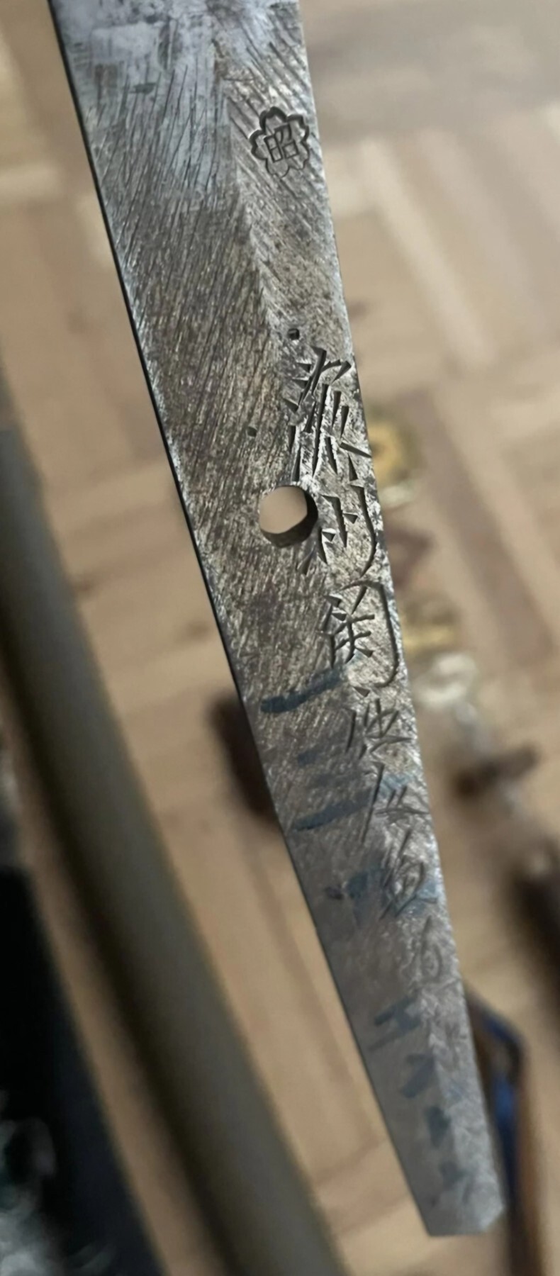

Rawa Posted June 4 Author Report Posted June 4 I found blade with similar hamon by same smith https://kako.nipponto.co.jp/swords/KT122460.htm Quote
Bryce Posted June 4 Report Posted June 4 G'day Marcin, Thanks for that. Definitely Kanemichi, but there is something odd about the nakago jiri. Maybe it has been shortened slightly or maybe it was just made that way. Unfortunately none of your new photos show the nakago jiri. Cheers, Bryce Quote
Bryce Posted June 5 Report Posted June 5 Yeah, must have been shortened slightly to fit that koshirae. Cheers, Bryce Quote
ROKUJURO Posted June 5 Report Posted June 5 Marcin, TOROKUSHO does not look at validation or authenticity. It is just a registration paper issued by the government. The NAKAGO looks perfectly UBU to me. Quote

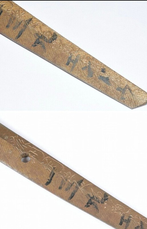

Bryce Posted June 6 Report Posted June 6 G'day Jean, You could easily mistake it for ubu, but the nakago jiri of Kanemichi blades are never that shape. They are always some version of this below. Cheers, Bryce Quote
