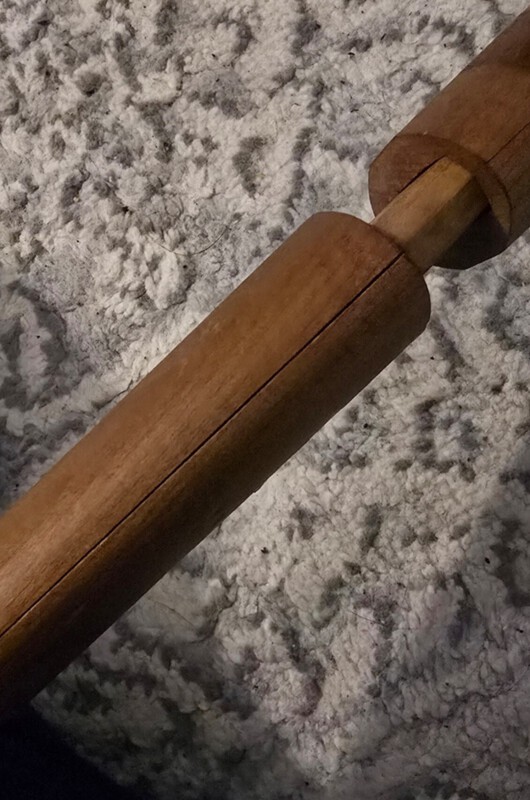

Nido42 Posted February 13, 2025 Report Posted February 13, 2025 Hello. I had just gotten an antique shirasaya wakazashi and the seams seem to be splitting apart. What would be a recommended way as to repairing this? Not sure if any wood glue would be appropriate or not or if it is what would be a good method at applying it into the seams. Thank you. Quote

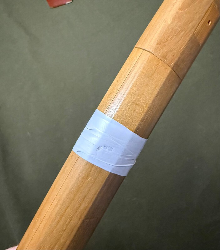

Scogg Posted February 13, 2025 Report Posted February 13, 2025 Agreed, Alex. I see shirasaya with tape stains often. It’s unsightly, and easily avoidable IMO. Here you can see my example of teflon tape (plumbers tape). It is also unsightly, but it will keep the shirasaya together indefinitely, and when removed it won’t leave any marks. If you’re careful, you can make it look better than my example. Assuming it’s still together, and the split is minor. Cheers, -Sam 1 Quote

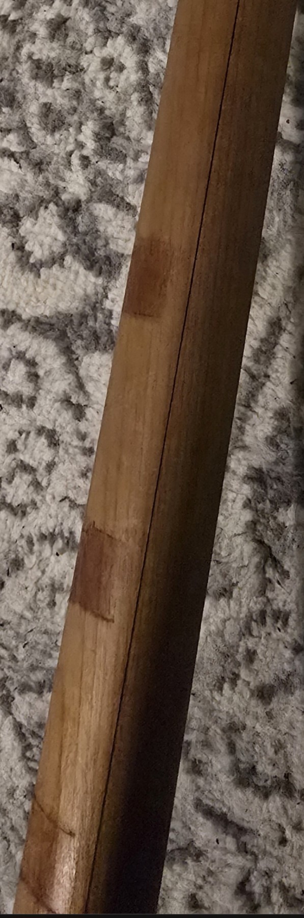

Nido42 Posted February 14, 2025 Author Report Posted February 14, 2025 1 hour ago, robinalexander said: KA (do you have a name?) ... A picture or two of the problem would be helpful. Sam is on the right track. My only variation is that I have used Silicon Repair Tape with great success. I don't leave it on....I only use it to hold the job in place until its set. Then remove it. It has no glue and sticks to itself like Sam's Teflon tape. Silicon tape can stretch to three times its length so that allows you gauge the appropriate holding strength you need depending on how robust or fragile your job is....also common water based glues will not stick to it. Hi, sorry my name is kevin. I'm still pretty new to the whole forums thing. It does appear to have what looks like some tape marks on it already. So, assuming someone might have done this at some point in the past as well. The tsuka seems to be split on one end and the saya almost runs the full length on both sides. Sorry if I mispronounce anything, I'm still learning. 1 Quote
Nido42 Posted February 14, 2025 Author Report Posted February 14, 2025 1 hour ago, GeorgeLuucas said: Agreed, Alex. I see shirasaya with tape stains often. It’s unsightly, and easily avoidable IMO. Here you can see my example of teflon tape (plumbers tape). It is also unsightly, but it will keep the shirasaya together indefinitely, and when removed it won’t leave any marks. If you’re careful, you can make it look better than my example. Assuming it’s still together, and the split is minor. Cheers, -Sam Thank you for the advice! It appears to already have some tape stains. (I'm assuming) but only on one side of the saya. The splits seems to be vertical on both sides. I had added some pictures to another reply on here. Quote
