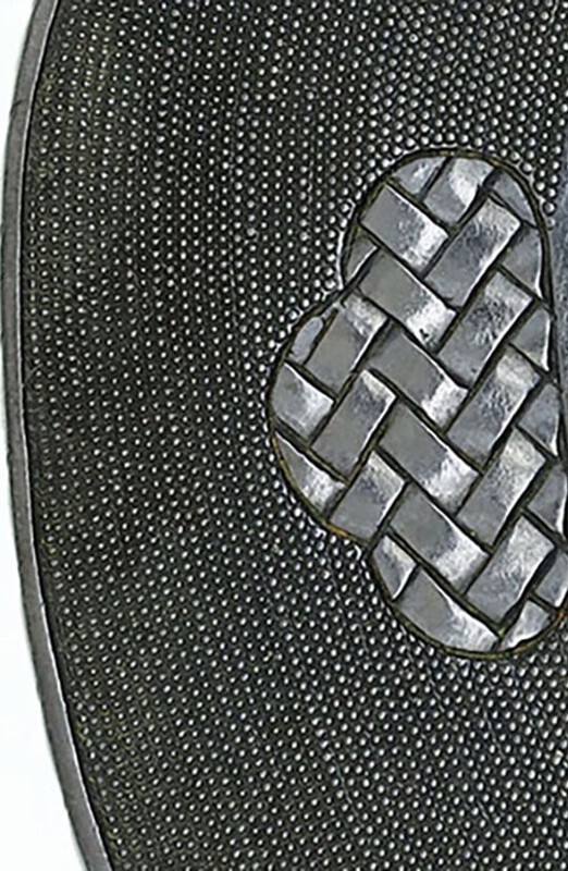

Scogg Posted January 30 Report Posted January 30 Hi John, I can't speak to the layering, construction, or mei. But, in my opinion, this is a good example of what not to look for in NANAKO. And it was the first thing I noticed. Quality nanako will look almost impossibly precise, and be evenly applied. Whereas the tsuba in your photo looks like the nanako dots are randomly scattered without any pattern. Image of shakudo nanako fuchi from my collection. All the best, -Sam Quote
John C Posted January 30 Author Report Posted January 30 Sam: Agreed. I do leather working and the pattern reminds me of a 4 dot stamp known as a "backgrounder" randomly applied from the reverse side. John C. 1 Quote

Jesta Posted January 31 Report Posted January 31 The nanako is definitely not high quality to my eye. The wave patterns look messy, and the nanako seems to be of varied sizes. I would be very surprised if this was hand-punched. My best guess is a separate sheet over a core: san-mai. This is what I would expect good quality nanako to look like (shared elsewhere). 1 Quote
