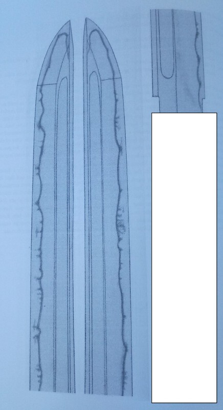

Jacques Posted January 22, 2025 Author Report Posted January 22, 2025 42 minutes ago, sabiji said: So I'll try again, it would be a shame to lose the thread, just from my point of view, or rather the way I learned it. At least Jacques seems to accept Ko- and O-midare, just not the poor ordinary Midare. Simply midare can be divided much better into "tens of" different subtypes of Notare and Gunome and even more specific ones. The decisive factor is which characteristic predominates. This characteristic is usually mentioned first. If the Choji predominates in the Midare, it is a Choji-Midare. If the Midare dominates over the Choji, it is Midare-Choji. If I write Sugu-O-notare, everyone knows that it is a Suguha that undulates here and there very gently and regularly. Sugu-Komidare would be a Sugu that shows the irregularities here and there in a very small range of action. With a Sugu-Kogunome, you could easily identify the Tani and Yakigashira mentioned by Jacques in a narrow range of action. And so on, etc. Ultimately, all the terms for the properties are a set of terms that can be largely combined to describe a Hamon as differentiated as possible. These deeper differentiations can certainly be argued about. The properties can be interpreted differently by different people. A good example: there are various Oshigata for well-known blades, which can obviously differ considerably. Of course, a Sugu does not become a Gunome, but it has definitely happened to me that I would have mistaken two Oshigata of the same blade for Oshigata of two different blades. But that is what I have already written elsewhere, I remain quite relaxed about it. I always read my Kinju as Konotare with Tsurete properties. Tanobe-Sensei later clarifies: "...ko-notare ga tsure-gokoro ni midareru Hamon..." And here we have "Midare..." again. Just false Sugu-O-notare, should be written: suguha ni notare majiri (suguha mixed with notare) Sugu-komidare should be written suguha ni ko-midare majiri. Quote
Jacques Posted January 22, 2025 Author Report Posted January 22, 2025 On 1/21/2025 at 2:52 PM, Natichu said: Notare of some variety, with occasional choji interspersed? Not entirely sure what the question is, but have a feeling that answer is incorrect. Answer (you are not so far from being atari) 1 Quote

Natichu Posted January 23, 2025 Report Posted January 23, 2025 9 hours ago, Jacques D. said: Answer (you are not so far from being atari) That is much closer than I thought I might be! Clear proof that even a stopped clock is close enough to right every so often I suppose. Gunome certainly makes more sense than choji. Many thanks, and I look forward to the next portions of the thread. Quote

Jacques Posted January 23, 2025 Author Report Posted January 23, 2025 Quote But shouldn't it be “notare ni suguha majiri”? So the notare was mixed into the suguha? It means suguha is mixed in (with) notare . Quote Then come back and explain why hatarakis are not important. I didn't say the hataraki weren't important. I said they could be overlooked because I haven't yet tackled the subject, which for the moment is the shape of the hamon. This one should be easy to find. Quote

Natichu Posted January 23, 2025 Report Posted January 23, 2025 6 hours ago, Jacques D. said: It means suguha is mixed in (with) notare . I didn't say the hataraki weren't important. I said they could be overlooked because I haven't yet tackled the subject, which for the moment is the shape of the hamon. This one should be easy to find. I certainly understood you to mean that for the purposes of this exercise (and in particular that sword) to ignore hataraki, not that they are to be ignored generally. To me, this looks a clean choji-midare into a standard komaru boshi. My recollection of Facts and Fundamentals is that transition strongly points to shinto era, but that's about as far as I can go. Quote
Tohagi Posted January 23, 2025 Report Posted January 23, 2025 Sugu- kogunome or kataoki-gunome, Maybe some oeï bizen mitsu... Quote

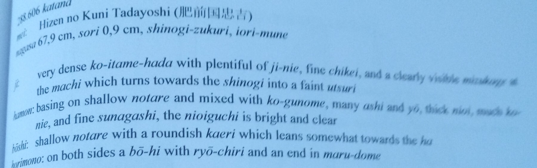

Jacques Posted January 29, 2025 Author Report Posted January 29, 2025 It seems that Fujishiro himself agrees with me, but if you don't know that the Japanese like shortcuts, you're forgivable. Shinto Hen par 481. Quote
Guest When Necessary Posted January 29, 2025 Report Posted January 29, 2025 Just now, Jacques D. said: It seems that Fujishiro himself agrees with me, but if you don't know that the Japanese like shortcuts, you're forgivable. Don't you mean you agree with Fujishiro - or do you lecture him too now? Quote
Natichu Posted January 29, 2025 Report Posted January 29, 2025 30 minutes ago, Jacques D. said: It seems that Fujishiro himself agrees with me, but if you don't know that the Japanese like shortcuts, you're forgivable. Shinto Hen par 481. Unfortunately I can't quite make out the kanji. Any chance of getting the relevant portion typed out? Quote
