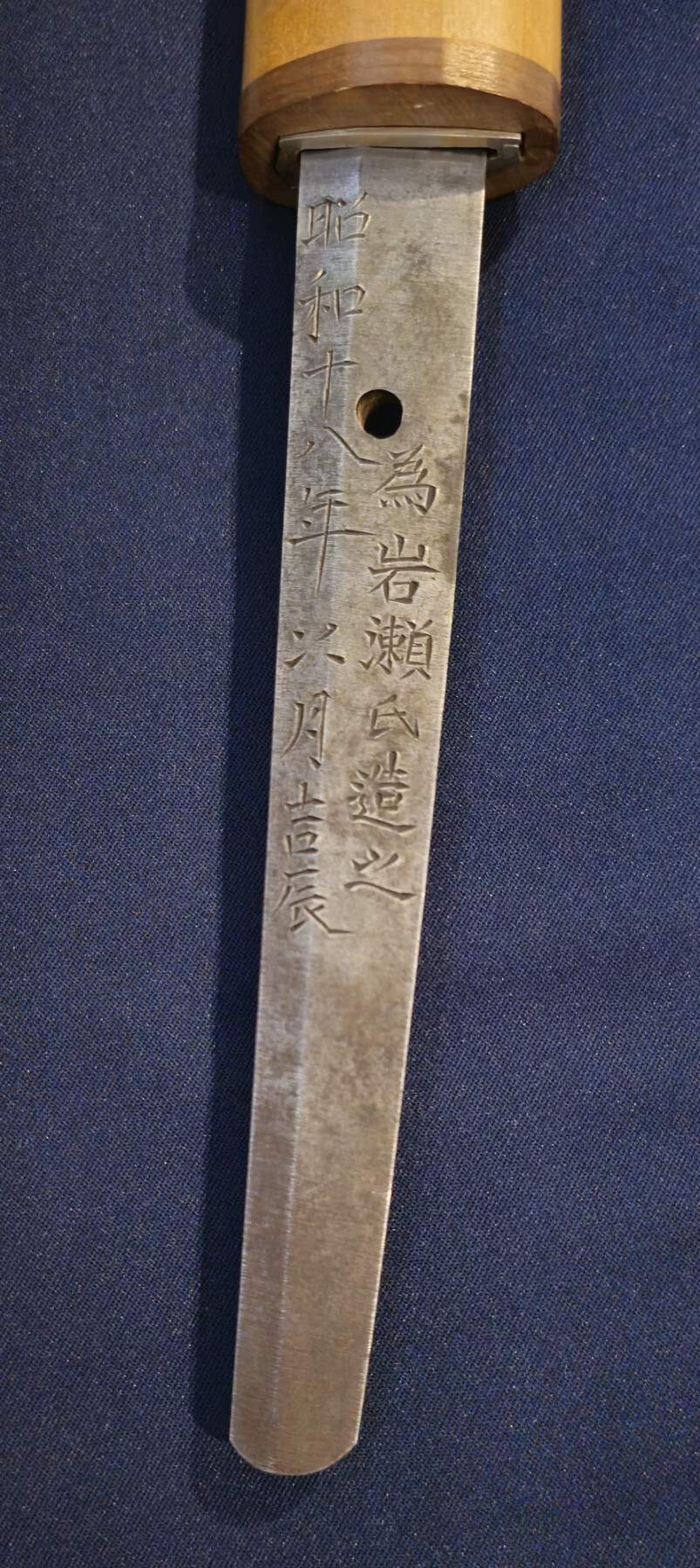

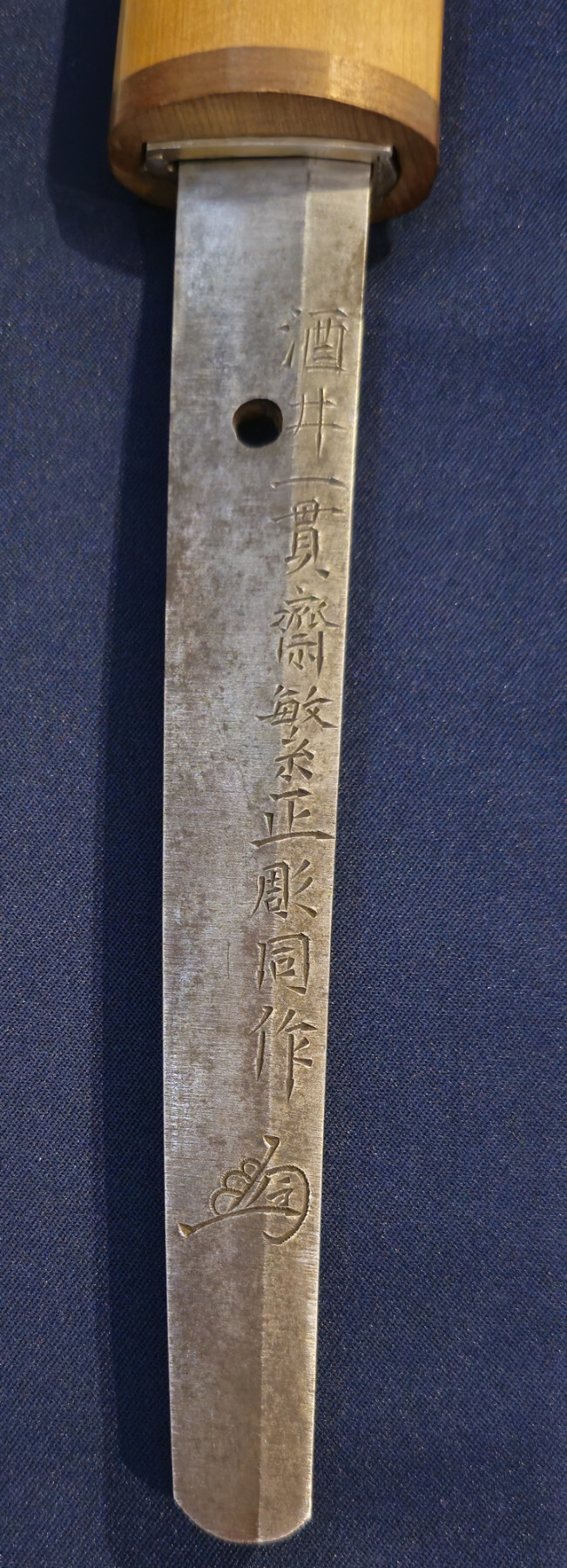

PNSSHOGUN Posted December 17, 2024 Report Posted December 17, 2024 Two Kai Gunto by Sakai Ikkansai Shigemasa, who was listed as KJT. There don't appear to be any extra marks or stamps on these swords, but one imagines they may have been made as efforts for the KJT? 1944: https://www.legacy-collectibles.com/022423-1.html Corrosion is obscuring the date, 1943?: https://page.auction.../auction/m1145423305 In my humble collection is a Shigemasa dated 1943 with special order for an army Lt Colonel, so it appears he was making swords for multiple branches/programs without any exclusivity. 3 2 Quote

Volker62 Posted December 17, 2024 Report Posted December 17, 2024 sorry John on your beautiful shigemasa I cannot read something about a Lt. Colonel? what I can read is, it was crafted for a Mr Iwase..... without a military rank and a surname... is it the same sword we were talking about? 1 Quote
Volker62 Posted December 17, 2024 Report Posted December 17, 2024 i know your blade that you are presenting here. an impressive work that I've rarely seen in such perfection of craftmanship inover 30 years! A work of art is the right term for this blade1 Tk's for sharing! Quote
Volker62 Posted December 17, 2024 Report Posted December 17, 2024 if I have missed something in my translation on your shigemasa,or misrated, please correct me.... Quote

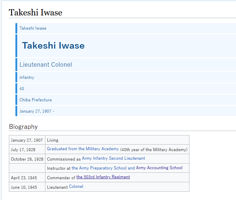

PNSSHOGUN Posted December 17, 2024 Report Posted December 17, 2024 5 hours ago, Volker62 said: sorry John on your beautiful shigemasa I cannot read something about a Lt. Colonel? what I can read is, it was crafted for a Mr Iwase..... without a military rank and a surname... is it the same sword we were talking about? Hi Volker, yes it's the same blade; requested by Mr Iwase Takeshi. He was a Lt Colonel by wars end. Quote
