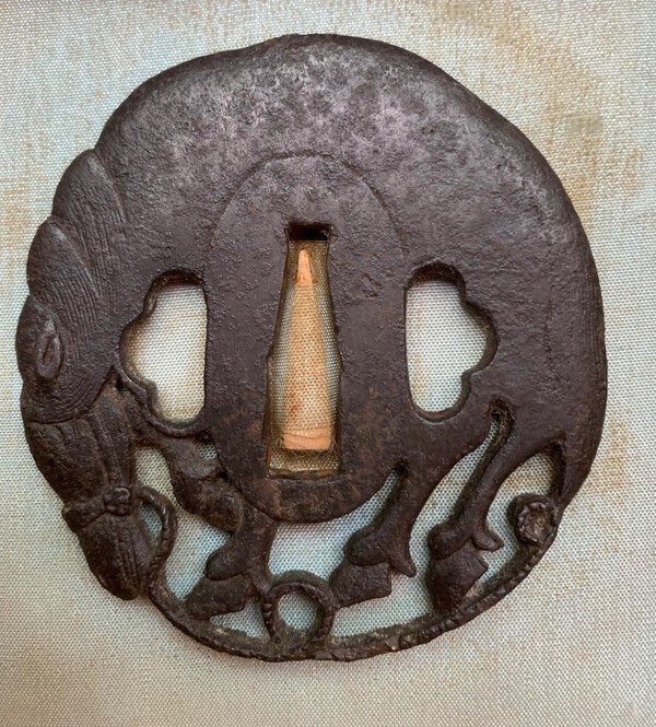

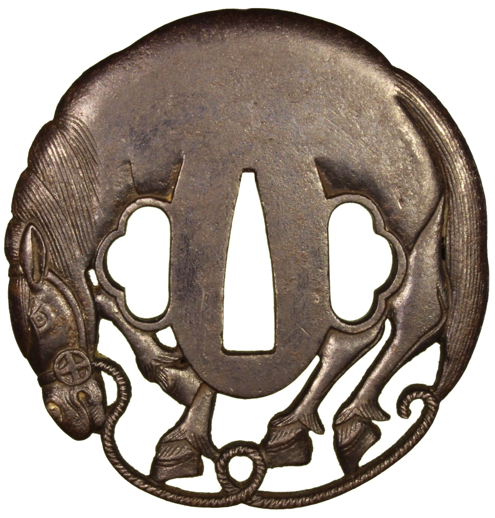

Matsunoki Posted February 21, 2023 Report Posted February 21, 2023 Hello yet again from the UK. Please can you enlighten me? (Oh no not him again I hear you sigh🙂) I’ve tried on the internet but no luck. I acquired it because I thought the subject was very “samurai” (daft thing to say) and also quite elegant and well conceived. I’m trying to convince myself that it’s not cast (can’t see any casting seams anywhere). It looks as if it’s been on several swords and has quite some signs of some age….lots of wear on the seppadai. Delicate engraving to the mane and tail is very worn. Very dark even patina. Kozuka and Kogai ana both the same….. There is a ghost of a signature. H 7.0cm W 6.8cm ie wakizashi sized. Thanks to you all. Best wishes. Colin 2 Quote
Dan tsuba Posted February 21, 2023 Report Posted February 21, 2023 Hello Colin! Now that is my kind of tsuba! Old and rusted! I really like it! My opinion is that it is hand forged and hand worked (although for me it is really difficult to tell – could it be cast – I don’t know! But my first thought is no - not cast). I really like the bottom of the mimi where it is worked to look like a rope tied to the horse. Also, from my limited expierence, I have found it rare that both hitsu-ana are the same shape! It also looks like one of the hitsu-ana has been repaired? I have no knowledge of the mei. I am certain that other members will help you out with that! With respect, Dan 1 Quote
rematron Posted February 21, 2023 Report Posted February 21, 2023 This is a job for @Spartancrest! 1 Quote

kissakai Posted February 21, 2023 Report Posted February 21, 2023 One I used to own was Choshu circa 1750 70 x 68 x 4.8mm Mine has the same hitsuana but in better condition I think someone may have a go at the mei Quote

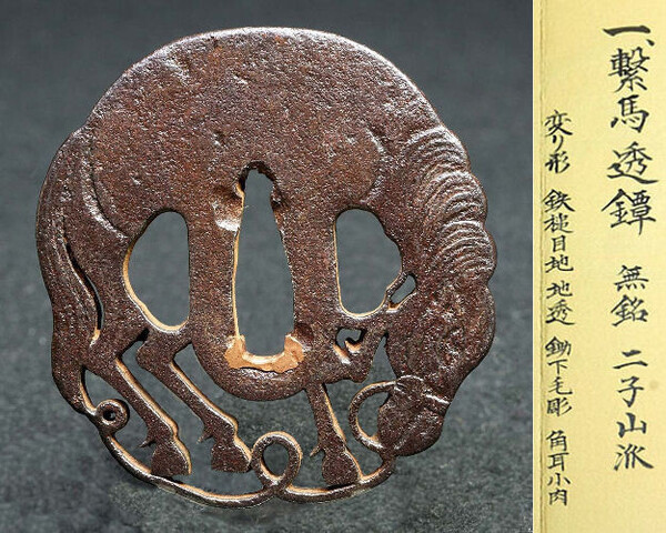

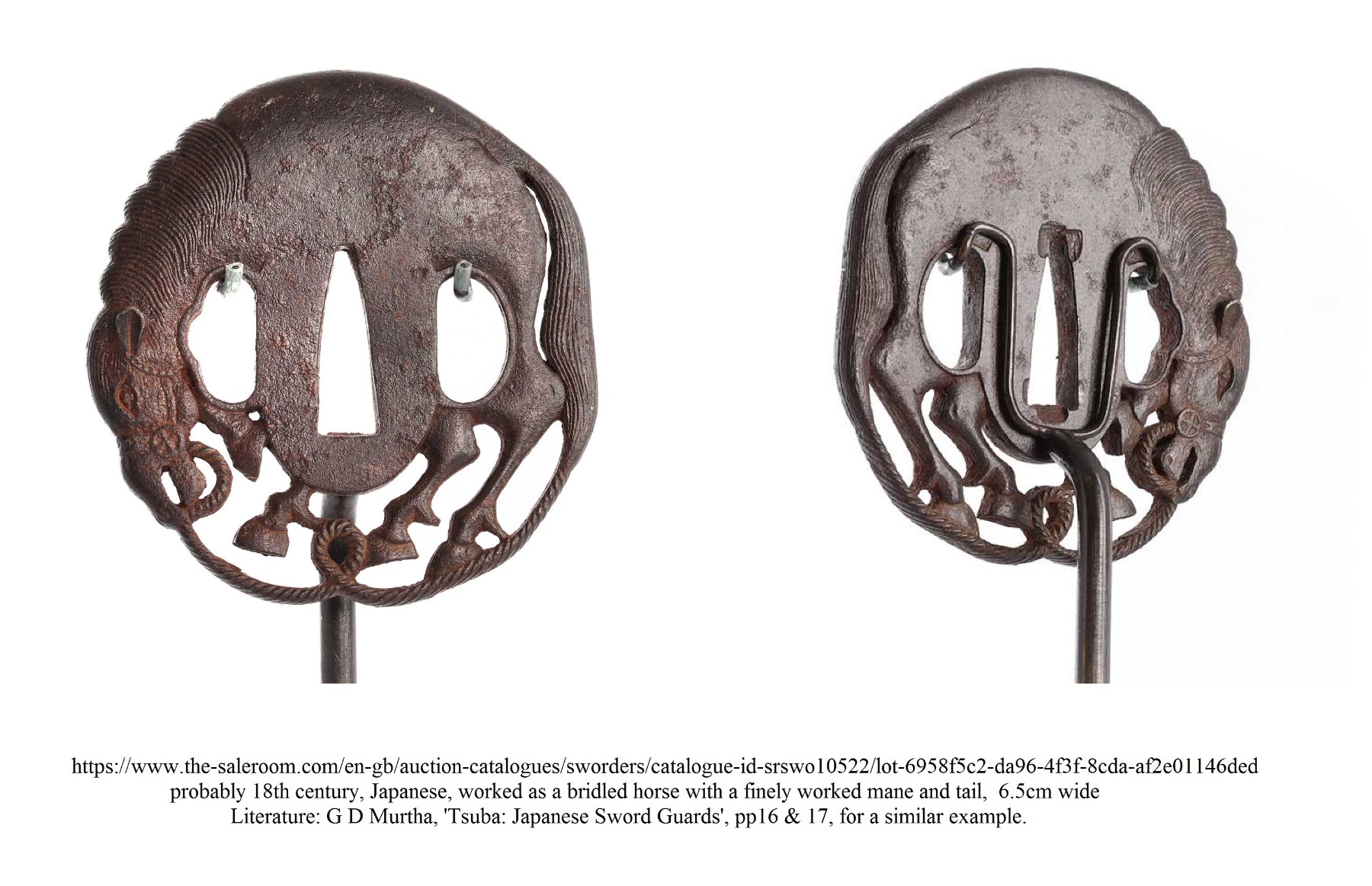

Spartancrest Posted February 21, 2023 Report Posted February 21, 2023 Ok ,ok - how many do you want? https://varshavskycollection.com/collection/tsu-0251/ this site has three examples https://www.bada.org/object/Japanese-openwork-bushi-tsuba-iron-sword-guard-depicting-bridled-horse-finely-worked-mane a good write up in the description of this sold version. https://www.espace4.com/en/collections/an-iron-kawarigata-tsuba-horse-at-rest/ in my opinion this one was way over priced. https://www.lot-art.com/auction-lots/Very-Cool-19th-C-Japanese-Samurai-Sword-Tsuba-Signed/82-very_cool-29.8.20-sofe https://www.worthpoint.com/worthopedia/Japanese-samurai-sword-tsuba-horse-159831877 definitely CAST with painted 'highlights' Missing a leg or "is he just happy to see you?" https://www.ebay.com/itm/325426008046 Literature: G D Murtha, 'Tsuba: Japanese Sword Guards', pp16 & 17, for a similar example. You will find a great number of these also have broken 'ropes' at the bottom of the guard. I will get back with more if you like - - after I have had my breakfast PS. The one you are looking at is Cast - just check the over-runs of metal along the rope edge. 2 4 Quote
rematron Posted February 21, 2023 Report Posted February 21, 2023 Thanks Dale! My only clue was the graininess but I wasn't sure if that was from casting or corrosion. Do you think the horse's mane was carved after the casting? That's another detail that threw me off because of the detail. Quote
Spartancrest Posted February 22, 2023 Report Posted February 22, 2023 I think many have been re-worked - it makes guessing if they were cast or not very difficult. I have re-worked a few myself to get rid of the casting seams etc. but it is time consuming if you want to do a good job - time is money so a lot of otherwise well cast pieces were not finished. Some other examples in the Metropolitan and Toledo museums. https://www.metmuseum.org/art/collection/search/26369?ft=tsuba+horse&offset=0&rpp=40&pos=7 one of their few with image restrictions. Toledo Museum of Art - "Yamashiro (Kyo) School" Mid - 18th century This one used to belong to" The world travel collection of artworks of Archduke Franz Ferdinand of Austria" - who's death sparked the first world war. [Gold plated bridle] 1 2 Quote

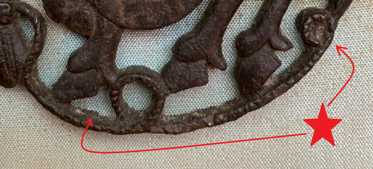

Spartancrest Posted February 22, 2023 Report Posted February 22, 2023 One of those with a broken rope I mentioned earlier. It did look like an exceptional piece to start with. 1 Quote
Dan tsuba Posted February 22, 2023 Report Posted February 22, 2023 Hello all! Spartancrest (Dale); your research, knowledge, and insights are truly amazing (just my opinion!). After reading this thread I have to get myself one of these Edo period “horse” type tsuba! I will be on the “lookout” for one! Now, whether the one I purchase will be hand forged and hand worked or cast iron or cast iron and hand worked is something I can only “guess” at! I figure the only way to know for sure if the one I end up purchasing is hand forged or cast iron is if I spend the money to have it invasive or non-invasive metallurgically tested. But I don't have the cash to have that done! Or, I can just take a hammer to it and see if it “fractures” like in a picture of another cast iron tsuba shown in a previous thread (“An Edo period Cast Iron tsuba" thread), then I will know for sure! But in the meantime, if I purchase a “horse” type tsuba, I will just enjoy my purchase and appreciate it! That is why I only purchase “low cost” and “low end” tsuba. If it is hand forged, great! If it is cast iron and old (Edo period – as many of the pictures of the “horse” type tsuba posted are from that period) that is also great! With respect, Dan 2 Quote
Spartancrest Posted February 22, 2023 Report Posted February 22, 2023 Dan to tell the truth I wouldn't mind one of the curled horses myself - I love irregular shaped guards [kawari-gata] - and I wouldn't care particularly if it was cast either, but I won't pay thousands for one. Nothing wrong with a bit of wear and tear on them either - adds to the character. 1 Quote

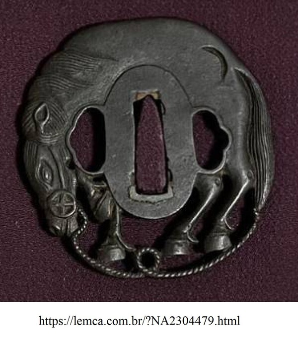

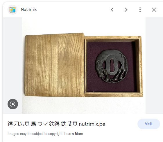

Spartancrest Posted February 22, 2023 Report Posted February 22, 2023 I have to laugh at this one from Google. The link takes you to a "Naturally Healthy" [laxative?] site https://nutrimix.pe/?footer=prueba2304479.html The same image also links to another site I can't get to open. 1 Quote

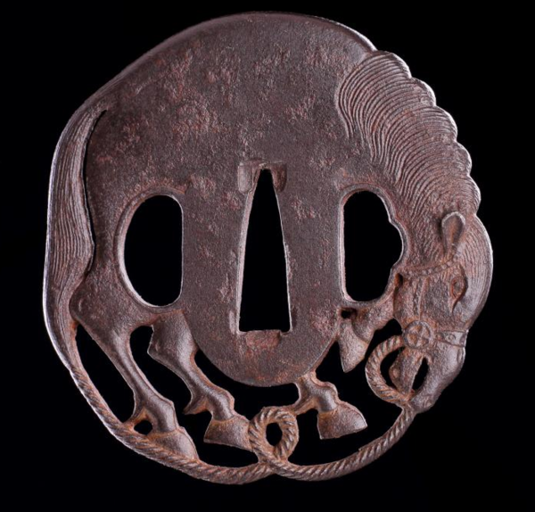

Kurikata Posted February 22, 2023 Report Posted February 22, 2023 Impossible to compete with Dale and his capacity to find any kind of tsuba but..... when we come to "Cheval" (Horse in French) we can find more exemples: https://www.espace4.com/collections/tsuba-en-fer-kawarigata-cheval-paissant/ https://www.lot-art.com/auction-lots/Trois-tsuba-Le-fer-Periode-Edo-18e19e-siecle-Tous-de-forme-irreguliere-a-En-silhouette/723-troi_tsuba-25.6.21-lempertz 1 1 Quote

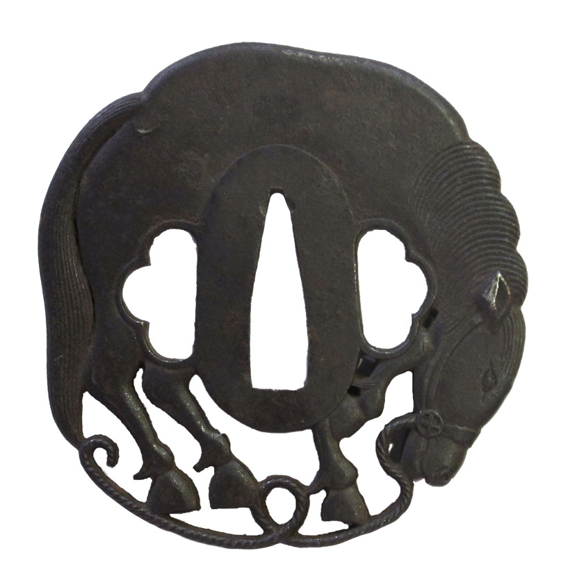

kissakai Posted February 22, 2023 Report Posted February 22, 2023 Colin just keep looking but I have to reiterate the above post: Impossible to compete with Dale and his capacity to find any kind of tsuba My horse tsuba that has been sold 2 1 Quote
Spartancrest Posted February 22, 2023 Report Posted February 22, 2023 Wow Grev that is the first one I have seen with the hair cut into the hooves. Great detailing. Quote

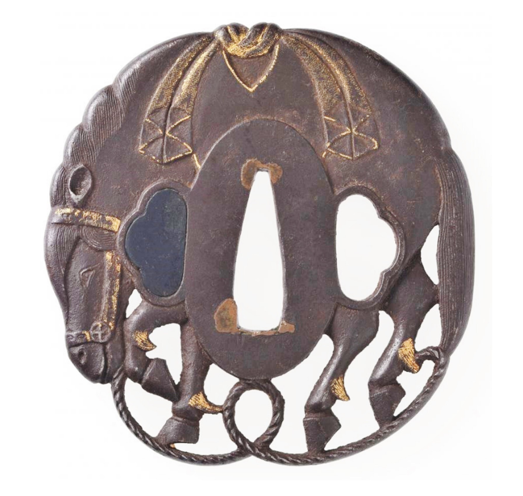

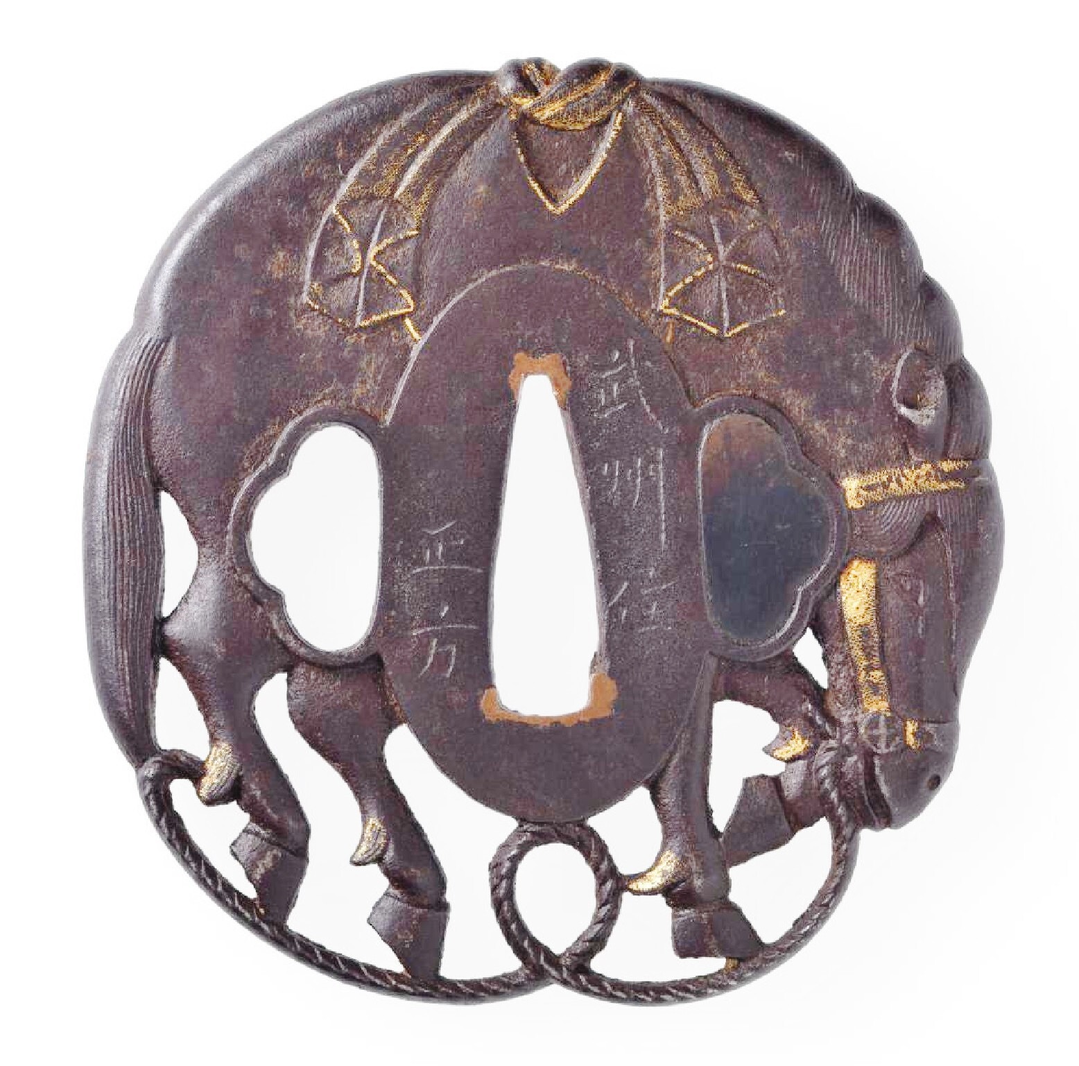

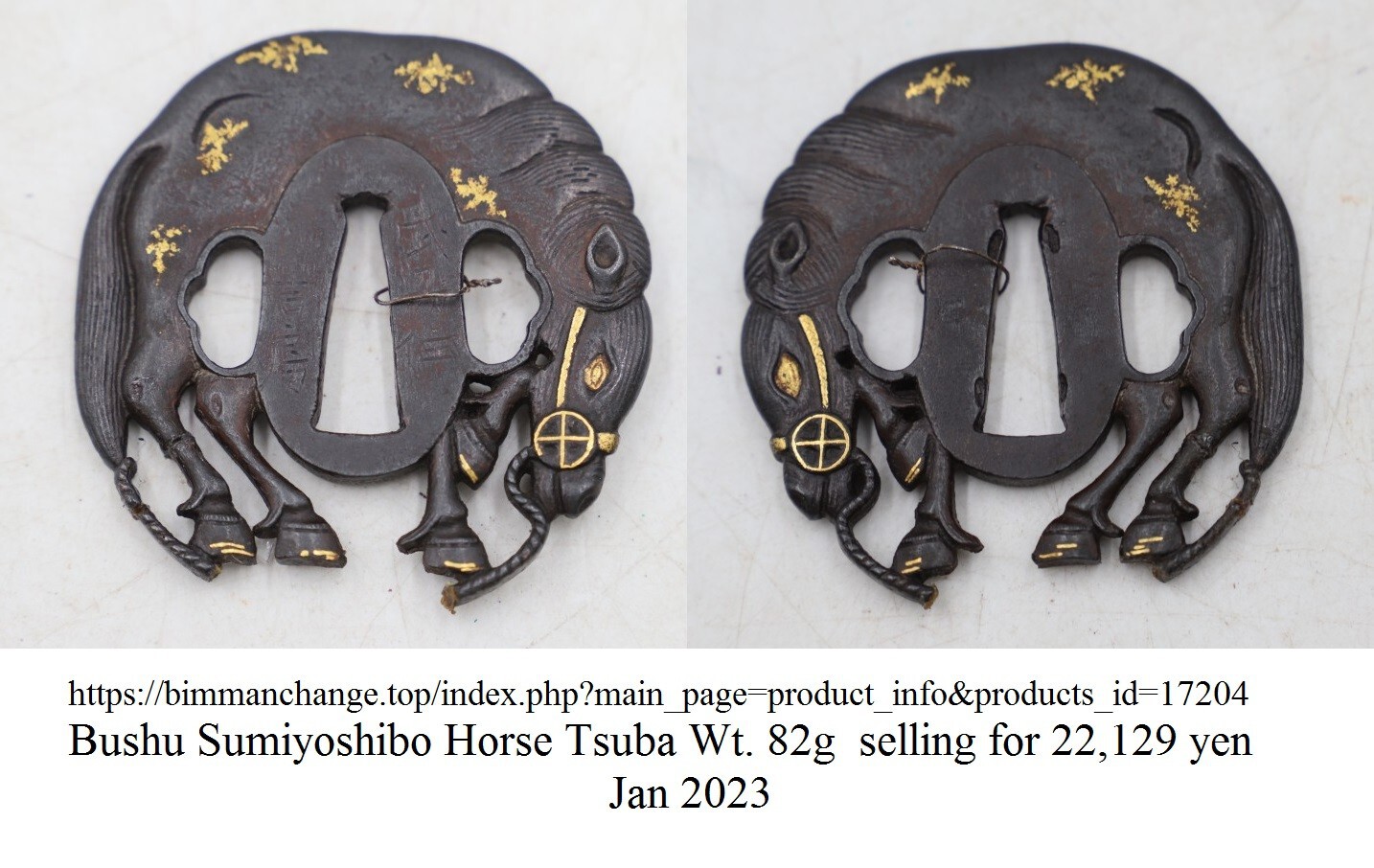

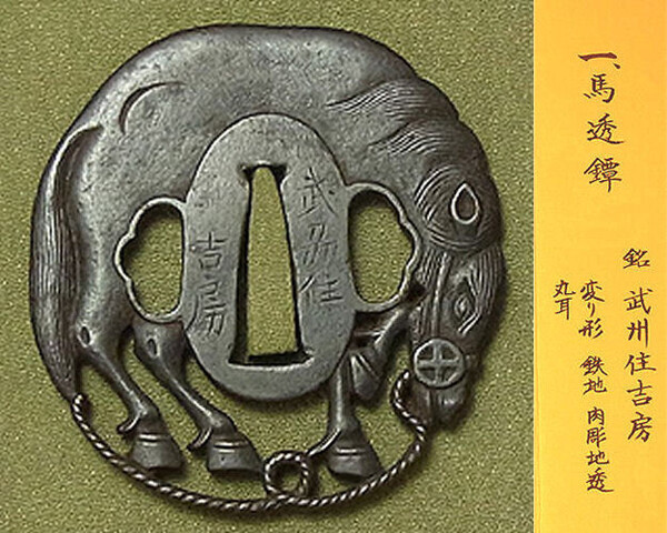

JohnTo Posted February 22, 2023 Report Posted February 22, 2023 These tsuba are fairly common and have turned up frequently in auctions over the years. They also seem to have been made by different artists from a number of schools. One of the first that I saw was from the R.B. Caldwell collection (Lot 24) in 1994 and was signed Heianjo Sadatsune, with a NBTHK Hozon certificate. This was virtually identical to mine (Pic attached), but is signed Bushu ju ???. The name was inscribed too indistinctly and is now unreadable! Anyone know how to restore a feint signature like they do in forensic labs with the serial numbers on guns? Anyway, mine is Height: 6.95 cm. Width: 6.5 cm. Thickness (rim): 0.25 cm. Weight: 82 g Best regards, John 2 Quote
Matsunoki Posted February 22, 2023 Author Report Posted February 22, 2023 1 hour ago, JohnTo said: Anyone know how to restore a feint signature like they do in forensic labs with the serial numbers on guns? Hello John Looking at yours, the signature section in the right-hand side of the nakago ana is exactly the same as mine. Possibly also,the left hand side. why not out put yours in the translation section…..I bet someone will confirm the right hand bit and maybe have a stab at the left? Can I also see “YOSHI” on the left? Quote
ROKUJURO Posted February 22, 2023 Report Posted February 22, 2023 2 hours ago, JohnTo said: ......Anyone know how to restore a feint signature like they do in forensic labs with the serial numbers on guns?..... John, with an x-ray device experts can restore a ground-out serial number on a gun as this is stamped-in which causes structural changes in the metal. If - as I assume - your TSUBA's MEI was not chiselled but cast-in, I don't think that the above method would help. . 1 Quote

MauroP Posted March 5, 2023 Report Posted March 5, 2023 On 2/22/2023 at 4:50 PM, JohnTo said: These tsuba are fairly common and have turned up frequently in auctions over the years. They also seem to have been made by different artists from a number of schools. One of the first that I saw was from the R.B. Caldwell collection (Lot 24) in 1994 and was signed Heianjo Sadatsune, with a NBTHK Hozon certificate. This was virtually identical to mine (Pic attached), but is signed Bushu ju ???. The name was inscribed too indistinctly and is now unreadable! Anyone know how to restore a feint signature like they do in forensic labs with the serial numbers on guns? Anyway, mine is Height: 6.95 cm. Width: 6.5 cm. Thickness (rim): 0.25 cm. Weight: 82 g Best regards, John Maybe Bushū jū Masakuni - 武州住 正國 Quote
MauroP Posted March 6, 2023 Report Posted March 6, 2023 Not a great help from NBTHK: Bushū (obvious) den Kanayama (?) Futagoyama (?) Quote
