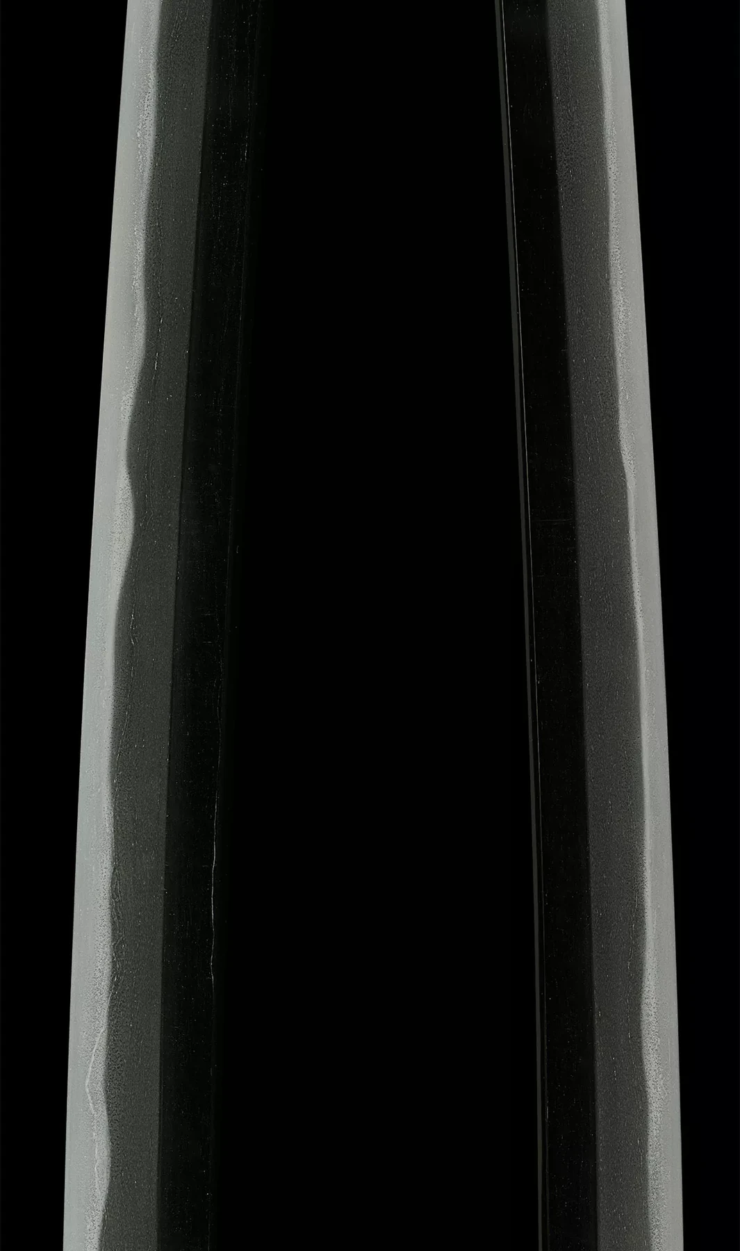

Malvakin Posted January 14, 2023 Report Posted January 14, 2023 Picked up this sword fairly cheaply, no papers but the seller claimed it’s a gendaito. There is a visible hada, but I’m not entirely convinced that the Hamon is genuine. What do you guys think? The price was low enough that even if it’s not real it’ll work as a new cutter. Quote
dkirkpatrick Posted January 14, 2023 Report Posted January 14, 2023 I see the hada you’re referencing but it all looks like pure hadori from this angle. Pointing at a lightbulb and sighting down the edge you should be able to discern whether there is an actual hamon. 1 2 Quote
Matsunoki Posted January 14, 2023 Report Posted January 14, 2023 Please show the nakago as well. Quote
Utopianarian Posted January 14, 2023 Report Posted January 14, 2023 Just a wild guess. Ebay Seller Komonjo out of Berkeley California. That notorious purple rug is a dead ringer. I would venture to guess the hamon is real and a Gendaito blade. Quote
NewB Posted January 14, 2023 Report Posted January 14, 2023 Yes, komonjo is the seller, No, thats not a real hamon! on a side note - Whomever picked up that Tadayoshi yesterday - congrats. This blade is either Chinese or the like. There's no hada that I can see. Also I don't see the usual polisher 'signature' near the nakago also! Just my 2 cents J. Quote

Scott JM Posted January 15, 2023 Report Posted January 15, 2023 Maybe I'm seeing things but I see grain and hamon there. Nakago shape, color, and how the width of this compares to the rest of the blade would be nice to see though. ---Scott. Quote
NewB Posted January 15, 2023 Report Posted January 15, 2023 Again This Is hada and hamon One streak of masame isn't imho J. Quote

PNSSHOGUN Posted January 15, 2023 Report Posted January 15, 2023 Chinese blade with thick Hadori, not Gendaito. Quote
Malvakin Posted January 15, 2023 Author Report Posted January 15, 2023 Thanks for the information everyone! I figured it would be Chinese based on the price, it was very cheap😂 there is definitely a grain pattern, but it’s not easy to see. The Hamon is giving me trouble identifying it, it has qualities that make me think its real (like being similar to the papered wakizashi I have when aimed at a light) and qualities that make me think it’s a fake hamon (looks slightly discolored, almost like a dulled rainbow effect from oil) Even if it’s a Chinese copy, the fittings are above and beyond standard copies! Nakago pic attached. Quote
John C Posted January 15, 2023 Report Posted January 15, 2023 26 minutes ago, Malvakin said: it has qualities that make me think its real Alexander: Do you mean real as in water quenched as opposed to oil or real as in quenched and not acid etched or ground in? John C. Quote
Malvakin Posted January 15, 2023 Author Report Posted January 15, 2023 7 minutes ago, John C said: Alexander: Do you mean real as in water quenched as opposed to oil or real as in quenched and not acid etched or ground in? John C. I don’t really know the difference. I have reproduction blades with hamon that look like just a white/silver line. My papered nihonto have a “cloudy” hamon. This sword has a similar cloudy hamon to the papered ones. The difference is that it isn’t just white, it has a very subtle discoloration. Quote
John C Posted January 15, 2023 Report Posted January 15, 2023 Here is a site that has some examples of acid polishing and fake hamon. http://www.ksky.ne.jp/~sumie99/acid polishing.html#fake hamon But quickly, ground hamon have fine grind lines and a clear demarcation line; acid etching can leave a "cloudy" appearance, though without nie, nioi, or yo or ashi. John C. Quote

Xander Chia Posted January 15, 2023 Report Posted January 15, 2023 I don’t know anything about Komonjo apart from what you can already find in this forum. But what I can say is that the Chinese are capable of creating blades that seem fairly close to the real thing if they wanted to. At least in my opinion. Here’s a Chinese blade that looks quite similar to the one op posted. Quote

NewB Posted January 15, 2023 Report Posted January 15, 2023 14 hours ago, Malvakin said: Thanks for the information everyone! I figured it would be Chinese based on the price, it was very cheap😂 there is definitely a grain pattern, but it’s not easy to see. The Hamon is giving me trouble identifying it, it has qualities that make me think its real (like being similar to the papered wakizashi I have when aimed at a light) and qualities that make me think it’s a fake hamon (looks slightly discolored, almost like a dulled rainbow effect from oil) Even if it’s a Chinese copy, the fittings are above and beyond standard copies! Nakago pic attached. If that's Japanese made then I'm behind on the most recent developments and forging practices. Enjoy it. J. Quote
Malvakin Posted January 15, 2023 Author Report Posted January 15, 2023 45 minutes ago, Darkcon said: If that's Japanese made then I'm behind on the most recent developments and forging practices. Enjoy it. J. Oh I’m fairly certain it’s not at this point. But as far as Chinese copies go, it’s not half bad. Quote
NewB Posted January 15, 2023 Report Posted January 15, 2023 8 minutes ago, Malvakin said: Oh I’m fairly certain it’s not at this point. But as far as Chinese copies go, it’s not half bad. Definitely a high quality. I'm not for bashing peoples' reputation as I personally have purchased from the seller. This is why this forum is an extremely useful resource. Lots of educated folks with factual information J. Quote
