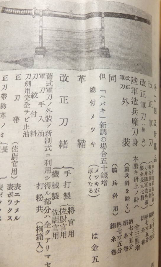

Before the war, Japanese officers could purchase an arsenal made blade via a sword company.  The sword in the OP is an example of this.  For those in doubt, attached is a page from the Gunjin Kaikan 軍人会會館 catalog from April 1937.  If one looks closely, one can see the kanji characters for an arsenal made blade.
陸軍造兵廠刀身 = Rikugun Zōheishō Tōshin = Army Arsenal Sword Blade.
  • Like 5

The army sword in the OP would have been made up until about 1934.  Afterwards, Japanese army officers would have used the traditional dress sword and the newly adopted Type 94.
The arsenals made two types of blades, the officer variant and the military Type 32/95 blades.  There are small differences between them.
