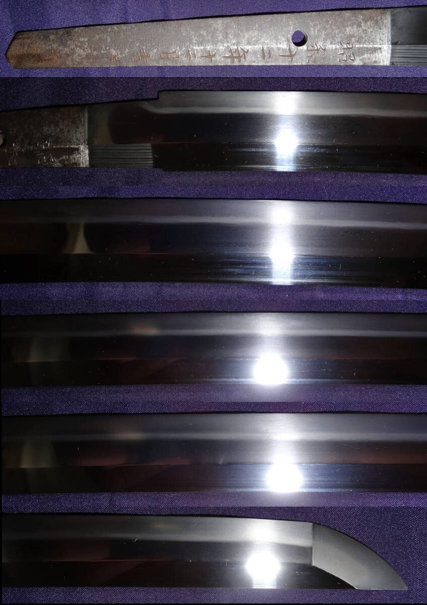

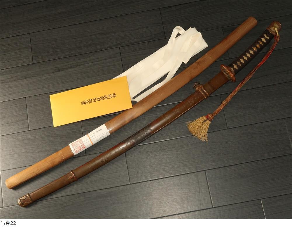

Late offer Yasutoku. Imperial gift. 750k wasn't enough so now it's 1,5M :laughing:

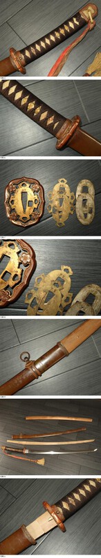

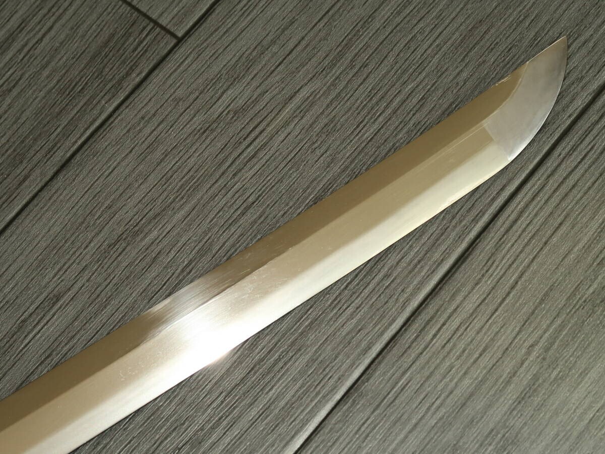

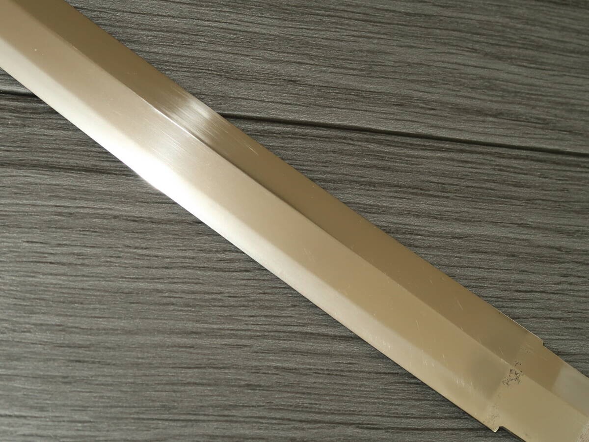

Sarute feels like bad repro. Tassel in normal variant? Habaki de lux with convex engraving koshirae.
Possible T94 with pinned kabuto-gane, centered chuso , separate sarute barrel. Haikan was remounted.
I would like get mei translation.

57 minutes ago, PNSSHOGUN said:
Onkashi-To should be signed with "Kinsaku" after the Mei and placed below the Mekugi-ana. A clear put together.
@PNSSHOGUN imagine who I wanted to ping ;)
