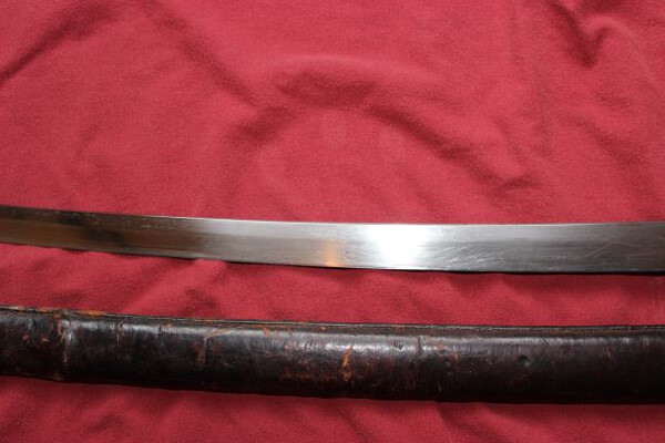

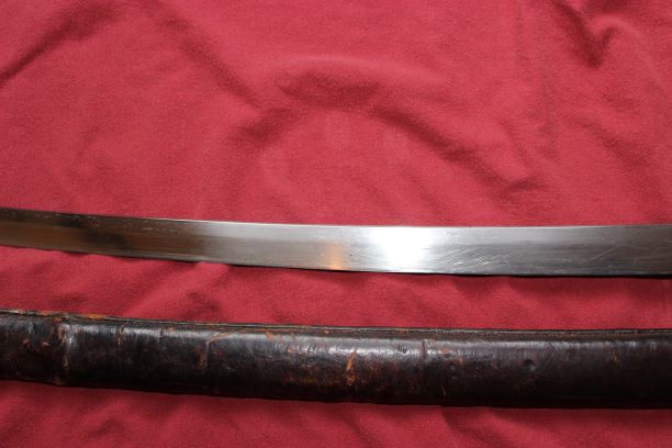

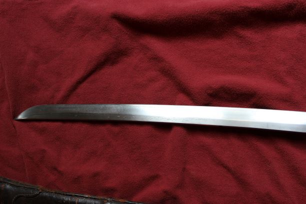

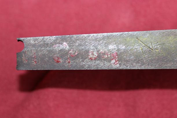

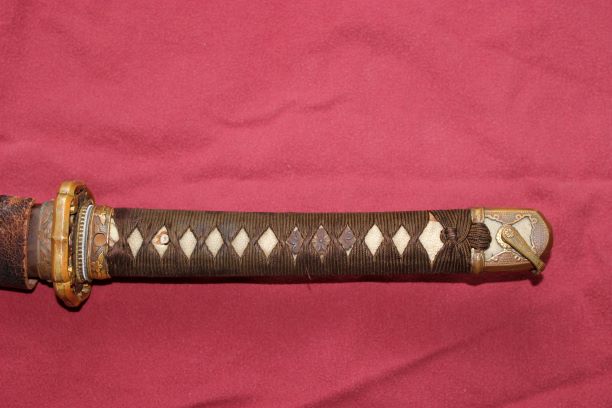

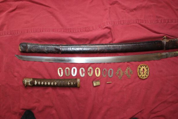

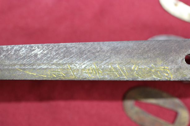

I've had this Shin-Gunto mounted Katana kicking around for a long time now. Frankly i do not even remember what i paid for it, somewhere around 20 years ago +/-.
The inscription states "Showa 1945 January" & "trust & light" or something along those lines.
I assume it's a machine made blade since no Hamon, grain or anything. Simply a wall hanger, but i'd still like to know the current value, for my own edification.
Anyway I've attached probably way too many photos of it, for all to see.
Thanks for any input.
Mark

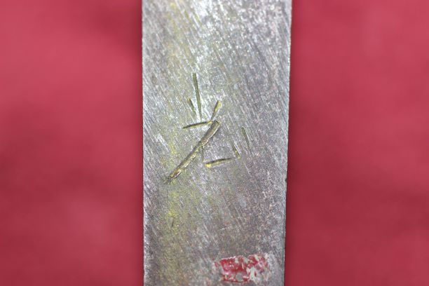

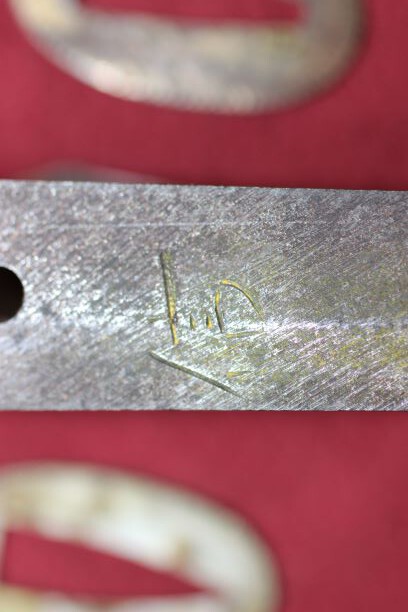

I failed to state that in the picture, last row, third from the left side, you can barely make out a teeny-tiny stamp that appears to be a "Seki" stamp. It is about a 1/2" above and 1/4" to the right of the hole.
Thanks again.
Mark
Mark,
That was one, tiny, hard to find Seki stamp, for sure! I couldn't keep my eyes off that "G" above it!
That's a really nice piece, overall, with the leather cover in good shape. Pricing is tough to call, as the market is almost completely stopped with the COVID thing going on. WWII officer gunto NORMALLY are in the range of $900-1,400. I personally feel yours is worth $1,000-1,200. But good luck getting a buyer.

And the "g" is a trick of the eye. If humans stare at anything long enough they'll see Christ on a cookie!

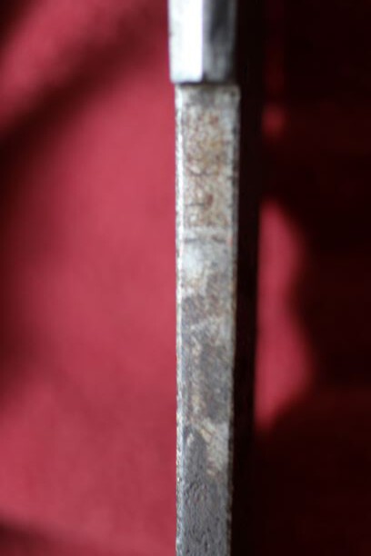

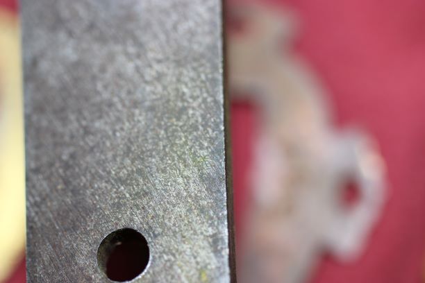

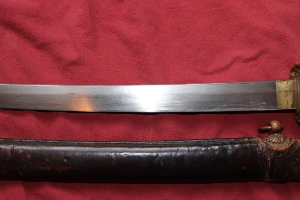

For the experts what is the reasoning of the those mekugi-ana like holes at the bottom of the nakago. I always thought those happened whenever it was a longer blade that was cut down, but if this is machined wouldn't it have been made to spec?

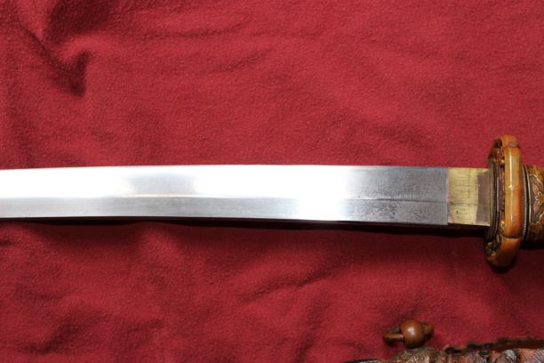

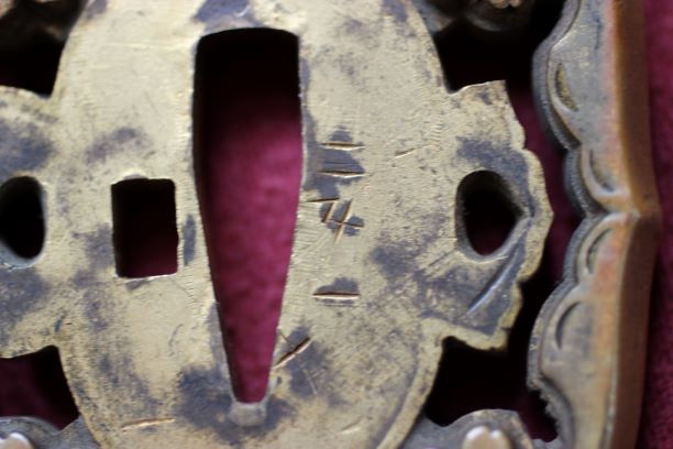

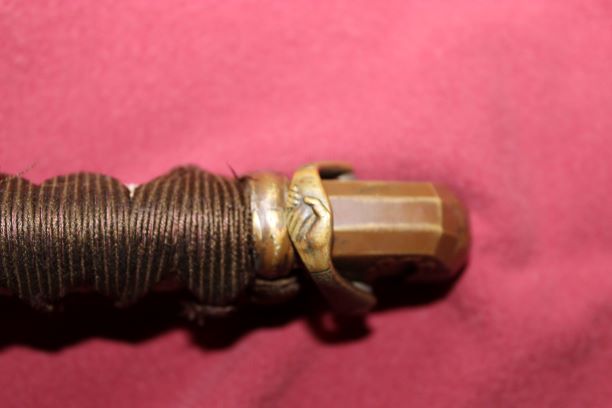

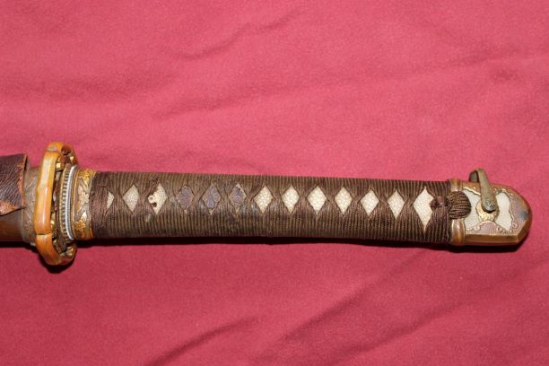

For a late war sword the mounts are unusual for a few reasons:
1: Pierced Tsuba
2: Kabutogane without normal cherry blossom castings
3: central retention latch position
Does the blade fit well in the mounts or is there alot of movement?
Its a wild mix of swordparts  :)
Tsuka and fittings are from a shingunto. The locking clip can not work with that combination of seppa.
The blade is a very late showa-to blade as John said and looks to fit in a rinji koshirae.
From my experience 700 - 800 Dollar would be a fair price.
Good eye Chris, I didn't see the seppa but it confirms my suspicions. Unfortunately non-original mounts hurt the value of such swords, as later war examples tend to rely on their condition more than anything else. Given the wild assortment of parts there it's difficult to say what was original to the sword but my guess is the Tsuka and maybe some of the solid Seppa.
Yes, a Frankensword! Could be recent but could have been done in the field, don’t you think?
All is possible JP but not proofable.
In such case i only add the actual prices of the seperate parts.
Marc,
This blade has 2 holes because it was likely made to go into "Type 3" or Rinji Seishiki fittings which used a screw in the hole nearest the tsuba and a mekugi in the hole at the end. But this was cut off to fit into standard Type 98 fittings.
Mark,

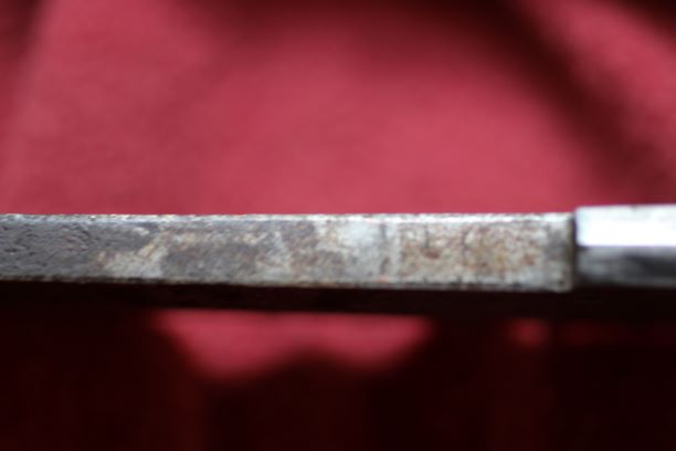

Would it be possible to get a picture of the end of the nakago? Does the cut look fresh (post-war) or is it aged?
I have 2 Mantetsu in the files with 2 mekugi ana, yet fitted in Type 98 fittings. The ends weren't cut like this one, so the fittings were obviously made to fit the longer nakago. But I mention them as examples that the mix of blade and 98 fittings was done during the war. Depending upon whether we can get evidence from the cut end, this may have been a field re-fit or it could have been done post-war. May come down to one of those "who knows?" cases.
Ok guys,
The Tsuka fits very tight.
The Seppa's are a mix-n-match assortment for sure.
I think the Tsuka and Saya and the blade, are original to each other, simply judging by their fit to one another and the even amount of patina.
The end of the of Nakago is as aged as the rest of it, and appears for all intents and purposes, to be as it was leaving the factory.

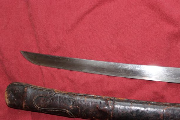

The leather is NOT as nice as it appears in the photos, the stitching is missing on the top, and the leather has tears at the front of the Ashi location, running down each side.
Otherwise, no history at all on it, I bought it at a happy crap (antique) store long ago.
I have always suspected it is Frankensword, at least to some degree.
However, when it comes to Japanese swords,........I know just enough to be real dangerous and not one once of knowledge more!

 A "bitser" but when was it done and to what extent? It could even be one that started life as all together, but then had extra or replacement seppa as wood and leather shrank.
