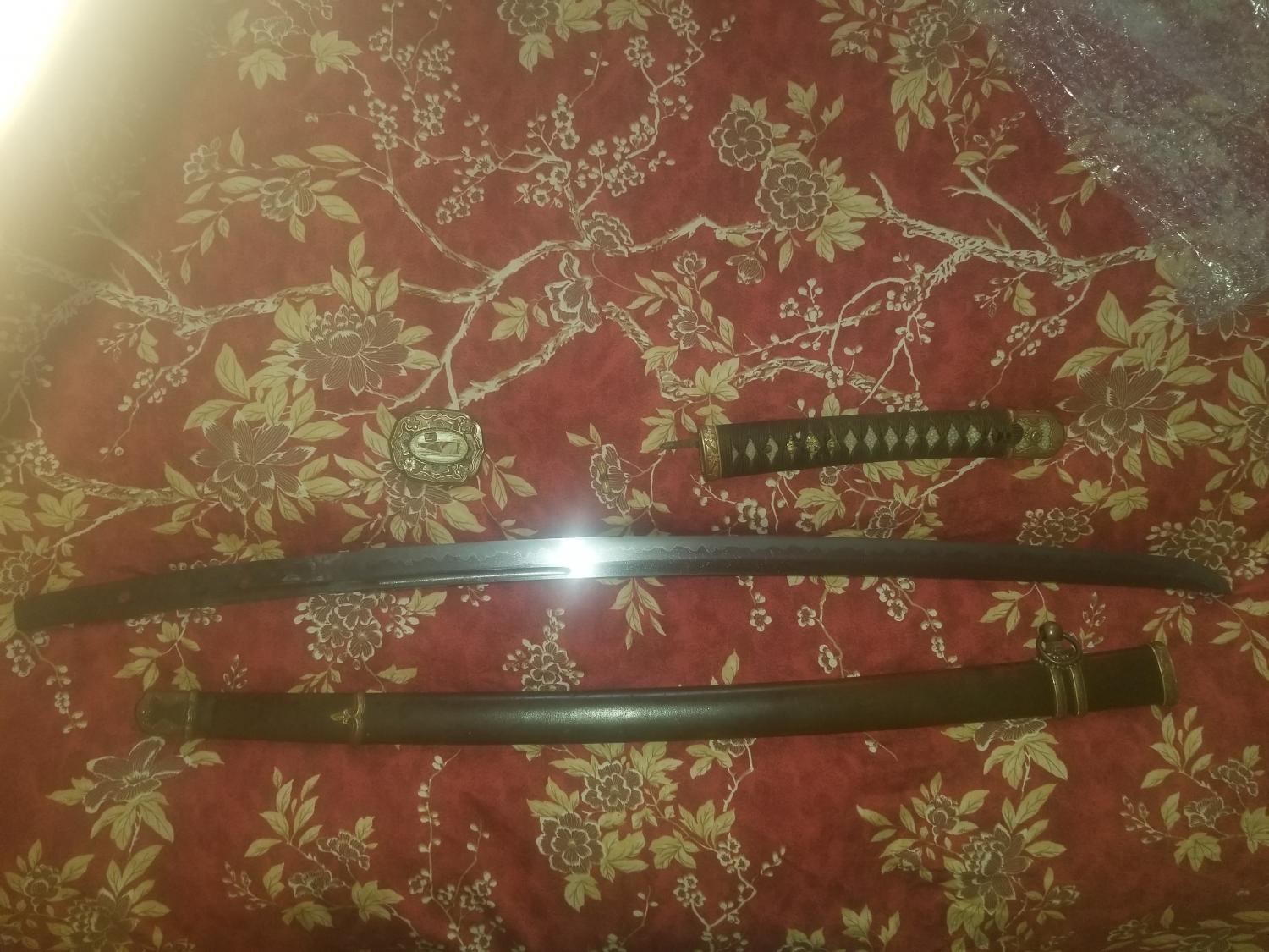

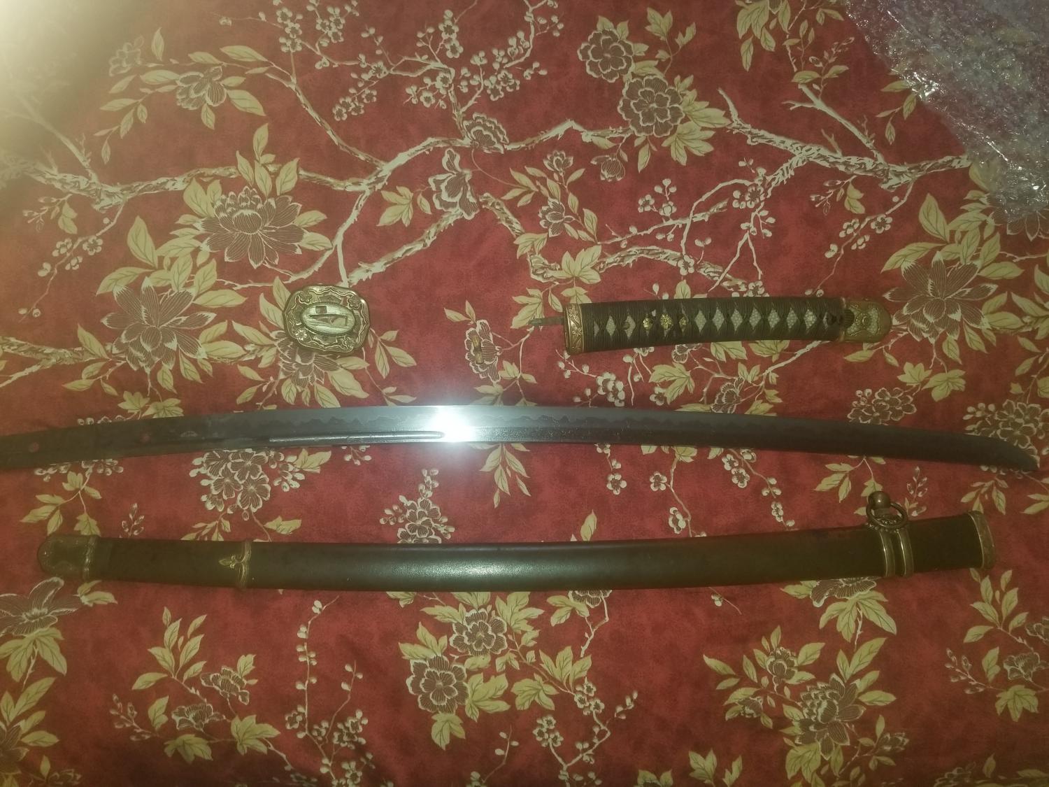

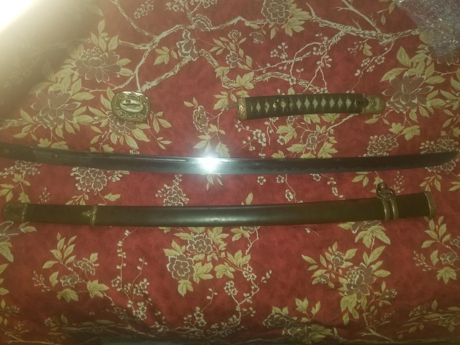

Yuradneprov Posted September 25, 2019 Report Posted September 25, 2019 Need help translating mei curious who made this katana. Yura Dneprov Quote

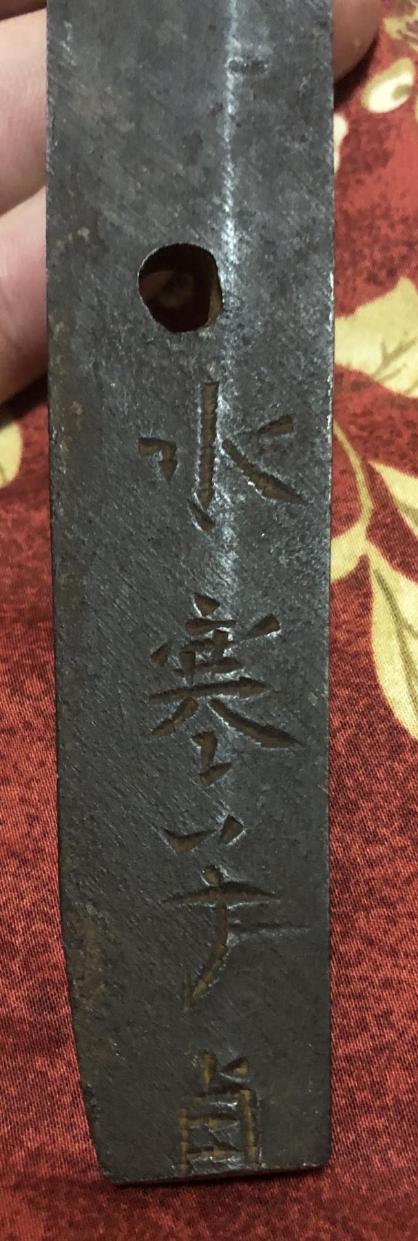

Yuradneprov Posted September 25, 2019 Author Report Posted September 25, 2019 Here is the other side as well Quote
SteveM Posted September 25, 2019 Report Posted September 25, 2019 水寒子貞(秀) Suikanshi Sada (hide) - the hide part is cut off 文化二年八月日 Bunka ni nen, hachigatsu jitsu (1805, August) 2 Quote
Yuradneprov Posted September 25, 2019 Author Report Posted September 25, 2019 Any idea if this looks like a real mei? Quote
ChrisW Posted September 25, 2019 Report Posted September 25, 2019 Looks very crude, but that doesn't necessarily mean anything. I don't know if that particular date and smith has any allure of being falsified. Quote
Stephen Posted September 25, 2019 Report Posted September 25, 2019 Yura Looks close to me. Date in different scrip. http://ginza.choshuya.co.jp/sale/gj/8301/10/18.htm Chris one should really not shoot something down if you dont search it out. Quote

Brian Posted September 25, 2019 Report Posted September 25, 2019 Looks like a strong, confident mei to me. Not to say it is genuine, but nothing suggesting false to me. Quote

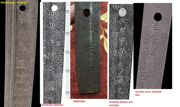

Ed Posted September 26, 2019 Report Posted September 26, 2019 I hope for your sake I am wrong, but in my opinion there is a high probability of your sword being gimei. The mei is poorly cut and there are numerous discrepancies when compared to shoshin mei. 3 Quote
Vermithrax16 Posted September 26, 2019 Report Posted September 26, 2019 Looks very crude, but that doesn't necessarily mean anything. I don't know if that particular date and smith has any allure of being falsified. Every single maker has a gimei possibility approaching 100%. If there is one thing I want people to understand, it is that fact. Obscure? One off guy from a school? Unimportant era, no matter. I have seen them for everything. Agree with Ed, did some comps and it's not a mei match. Suriage shinshinto sword is also a negative. Sword may well be nice, but I cannot tell from the limited pics. 1 Quote
Yuradneprov Posted September 26, 2019 Author Report Posted September 26, 2019 To be honest with you ed and Jeremiah I did my due diligence and sadahide mostly signed as masatsugu and if you look at the mei on most of his swords and then look at the mei on the sword I listed it's a perfect match not saying that it's official yet but I'm very confident that it's the real deal. But I appreciate the comments also if you could would be nice to show what discrepancies your talking about at least a link or reference. Yura dneprov Quote

Ed Posted September 26, 2019 Report Posted September 26, 2019 To be honest with you ed and Jeremiah I did my due diligence. I'm very confident that it's the real deal. If that is the case, why did you ask? You already knew the maker and sounds like your mind is made up, in which case there was no reason for me or others to waste our time! It would have been just as productive and less dishonest to have simply asked for second opinions in the beginning. sadahide mostly signed as masatsugu Nothing is set in stone, nor do I claim to have seen every shoshin example. With that said, I have never seen a known good example of Sadhide signing Masatsugu. My understanding is that it was Sandai Masahide, the son of Sadahide (nidai Masahide), who signed Masatsugu. If you have conclusive information of Sadhide signing Masatsugu, I would be interested in seeing it. if you could would be nice to show what discrepancies your talking about at least a link or reference. I have a better idea. Why don't you show your references, which validate your opinion and confidence. Having viewed all three generational mei, I stand by my call of gimei. not saying that it's official yet Do let us know how that works out for you. Quote

Yuradneprov Posted September 26, 2019 Author Report Posted September 26, 2019 https://yuhindo.com/suishinshi-masatsugu/ This is states what I mentioned earlier and if you compasre the handwriting they are identical even the etching in each kanji almost as if he didn't have a steady hand Quote

Ed Posted September 26, 2019 Report Posted September 26, 2019 https://yuhindo.com/...nshi-masatsugu/ This is states what I mentioned earlier and if you compasre the handwriting they are identical even the etching in each kanji almost as if he didn't have a steady hand I don't want to come across as rude but I don't know what you read or what you are looking at. First, Darcy's write up states exactly what I told you previously: Suishinshi Masatsugu was the third generation Masahide. He (Masatsugu) did not use the mei Sadhide or Masahide. Second, if you were going to provide an example which was used to base your rationale, it should have been one signed with the same mei your sword is signed; Suikanshi Sadahide, not Masatsugu. Third, I must disagree with your comparison of the characters or "handwriting". In my opinion they look nothing alike. From what I can see the sword looks like a nice sword, but that doesn't make the mei legit. Not much more to discuss unless you have better examples to provide. Once you send this sword to shinsa, update us here with the results. 1 Quote
Yuradneprov Posted September 26, 2019 Author Report Posted September 26, 2019 Here is another example ed. This one is signed suikanshi sadahide https://www.aoijapan.com/appraisal-quiz-390/ Quote
Yuradneprov Posted September 26, 2019 Author Report Posted September 26, 2019 Like I said please provide references to the information you are stating otherwise I don't mean to be rude but doesnt mean anything unless you have something to back up what you are saying. Second it's completely rational to show you the mei of masatsugu because it's the same wordsmith his writing isn't going to change just because he is using a different name. Quote
Vermithrax16 Posted September 27, 2019 Report Posted September 27, 2019 Well I was just gonna leave this one be but I happen to have nothing else to do tonight, so I'll give it a go. First order of discussion: Masatsugu did not sign as Sadahide. Masatsugu is NOT Sadahide. This is documented in all meikan works (Sesko Shinshinto Meikan, Fujishiro, etc) as well as Markus Sesko's Japanese Swordsmiths A-Z. Darcy covers this as well in the very Yuhindo sword that was linked: "Masahide before he died changed his name to Amahide, but after he died his son Sadahide chose to take up the name Masahide as the second generation head master of the school. Though he did not achieve the levels of skill of his father, he was an excellent swordsmith and ranked Jo-saku. Sadahide did not enjoy a long period of work under the name Masahide as he died within a year of his father's death, leaving his young son Kawabe Hokushi to inherit the school. Possibly because of the tragic early death of his father after changing his name to Masahide, the third generation Suishinshi master never took on the Masahide name but instead made swords as Masatsugu." Family tree for clarity on the lineage: Masahide 1st ~~~~~ Sadahide, changed name to Masahide 2nd after death of 1st ~~~~~~~~ Masatsugu Are there other references that ascribe Masatsugu as the same smith as Sadahide? Here is a mei comp drawn from the Yuhindo link, the Aoi confusing joint work link, and two examples from Sesko Shinshinto Meikan. Other references agree with the Sesko examples, but I am not snapping pics of books and all that tonight: There is nothing similar for the NMB mei in question to the examples shown. I was not taught to count strokes etc, just to look and get a feel for the mei. I can see nothing remotely the same. There are other clues, but I am not going to give it all away right here. But as always, submit to shinsa and report back. In this study no one has every answer, always glad to be proven that I have overlooked something. Happens about every week. 6 Quote

Ed Posted September 28, 2019 Report Posted September 28, 2019 Like I said please provide references to the information you are stating otherwise I don't mean to be rude but doesnt mean anything unless you have something to back up what you are saying. Well Jeremiah beat me to it, but there you go. Hopefully you can see that your swords mei looks nothing like the shoshin examples. Second it's completely rational to show you the mei of masatsugu because it's the same wordsmith his writing isn't going to change just because he is using a different name. No, it is not. They are NOT the same smith. 1 Quote
