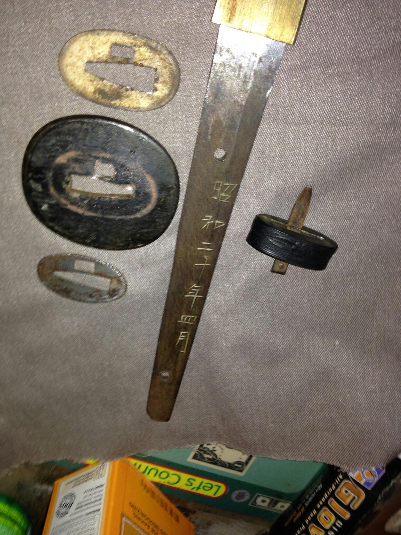

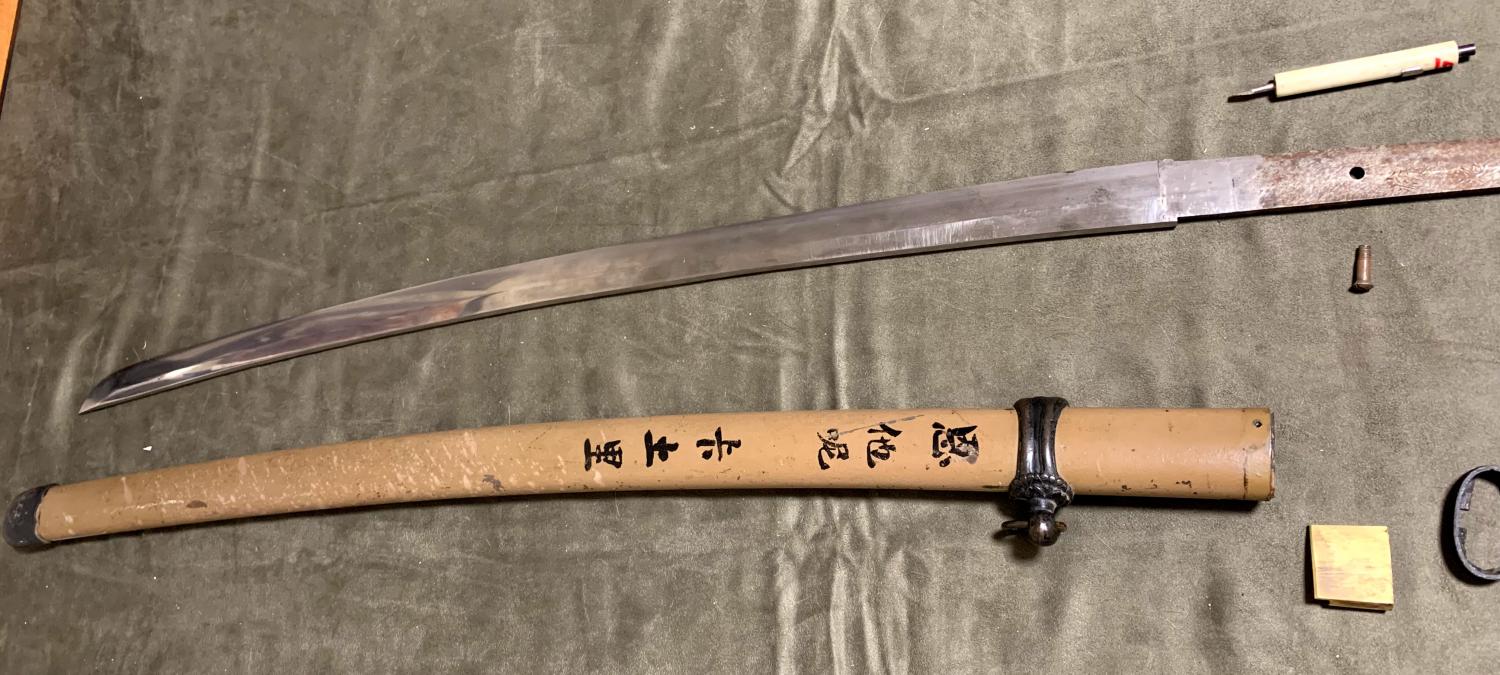

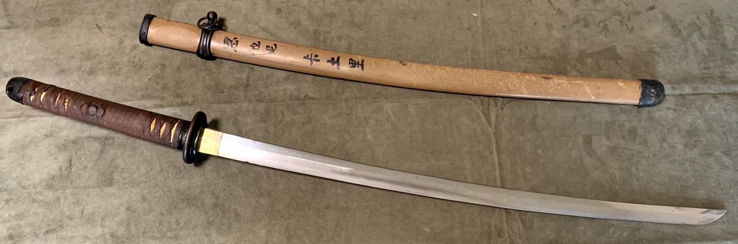

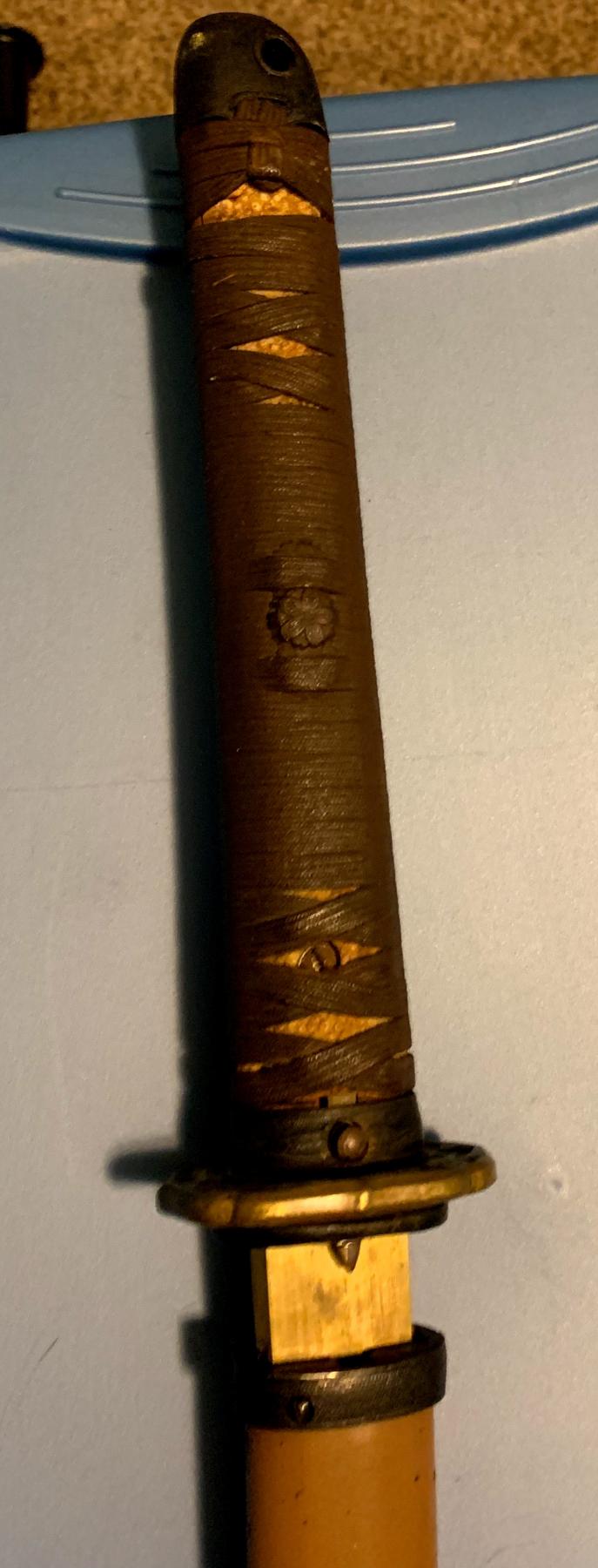

Hello community, this is my first post here and I wish to apologize if i mess something up. I am not a historian or military collector. I have come into possession via hand me down  within the family of what i believe to be a late war Shin-Gunto.
Can those more experienced in these items please assist me in identifying the writing and markings on the item and validating if its a reproduction or real?

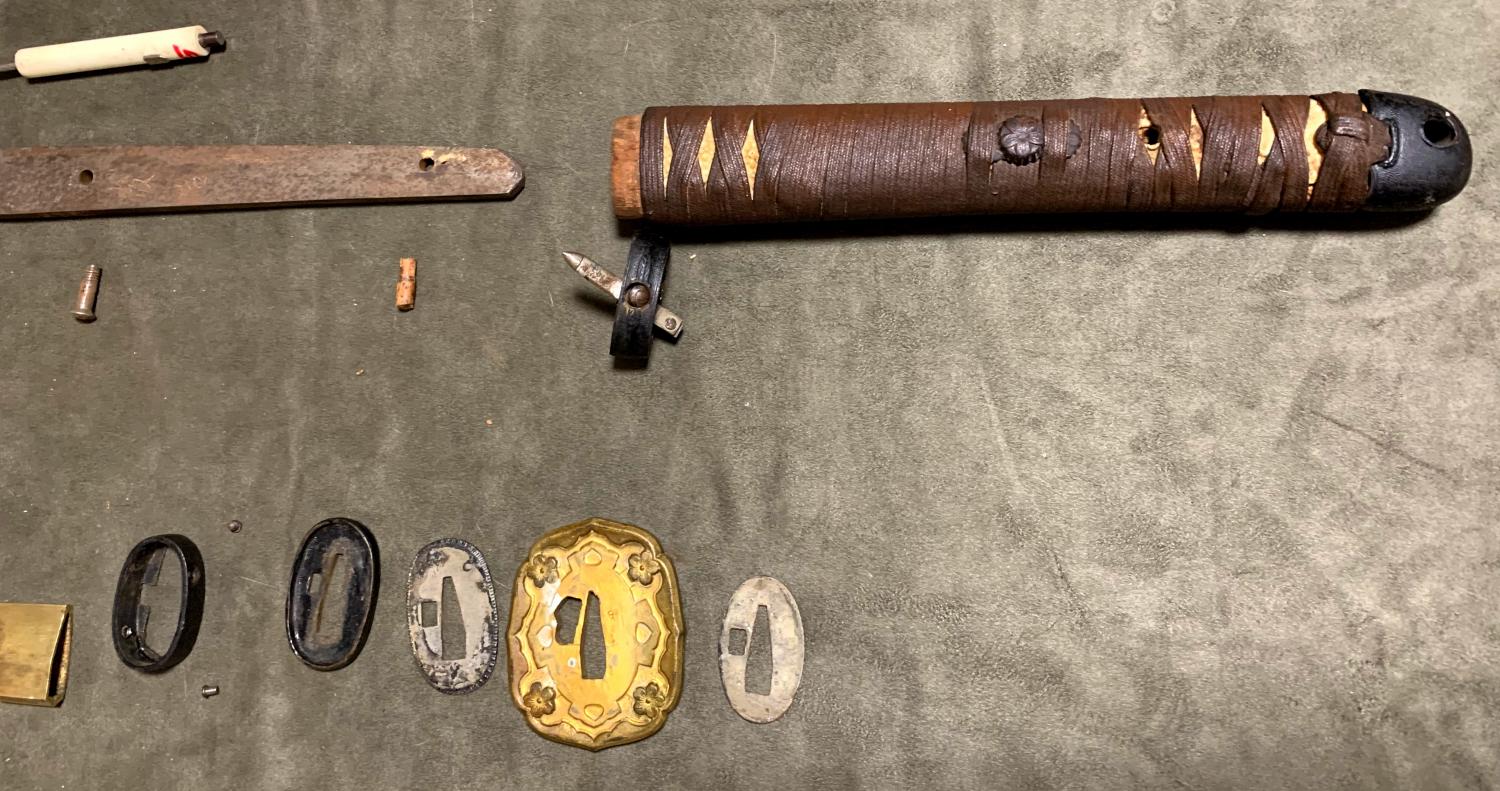

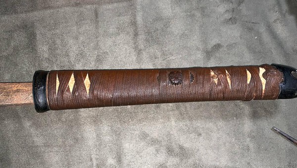

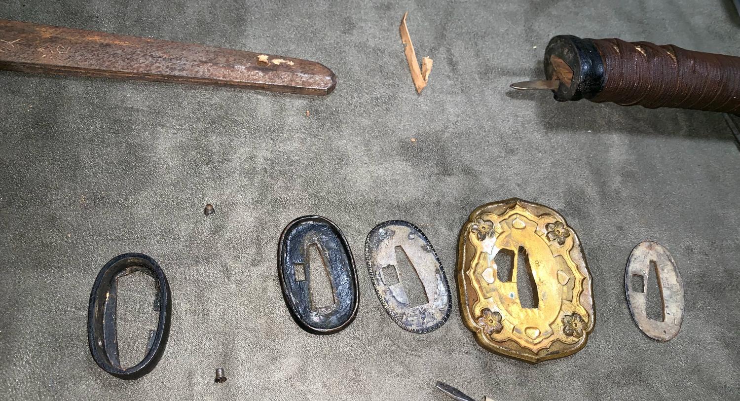

I took the time to learn how to disassemble one and made some notes, i am still learning the part terminology.

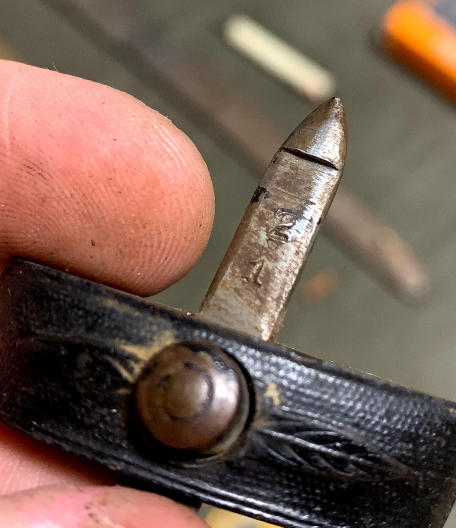

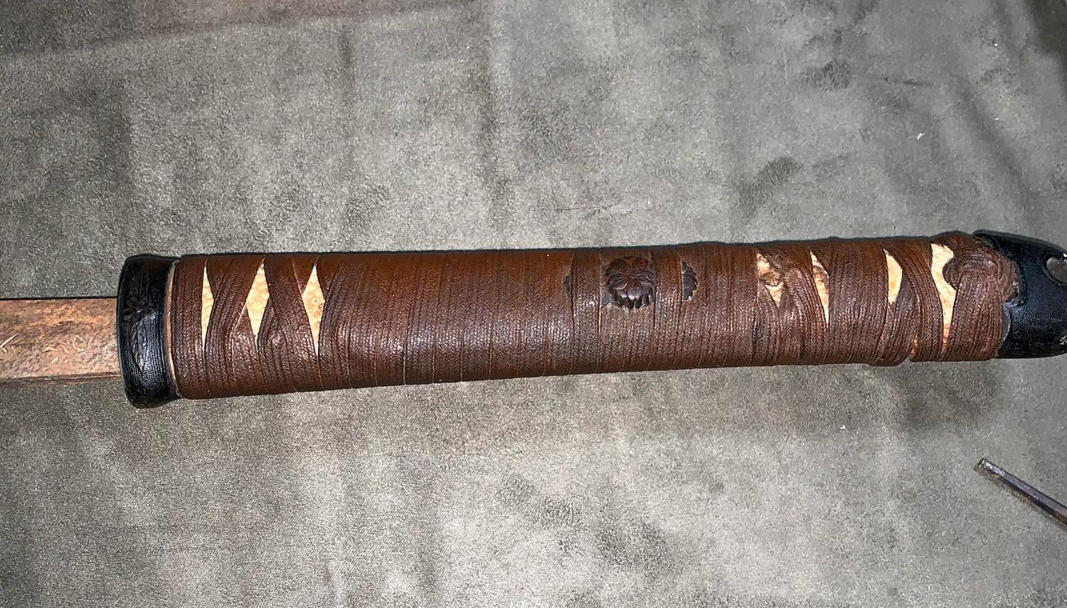

The Blade was attached to the handle via a screw close to the hilt and a wooden dowel at the other end. The grip binding was overlapping the dowel so i had to carefully slide it enough to free the dowel.
I have not cleaned the item at all and left all dirt and rust still on it. Its covered in heavy dust especially around the hilt guard.

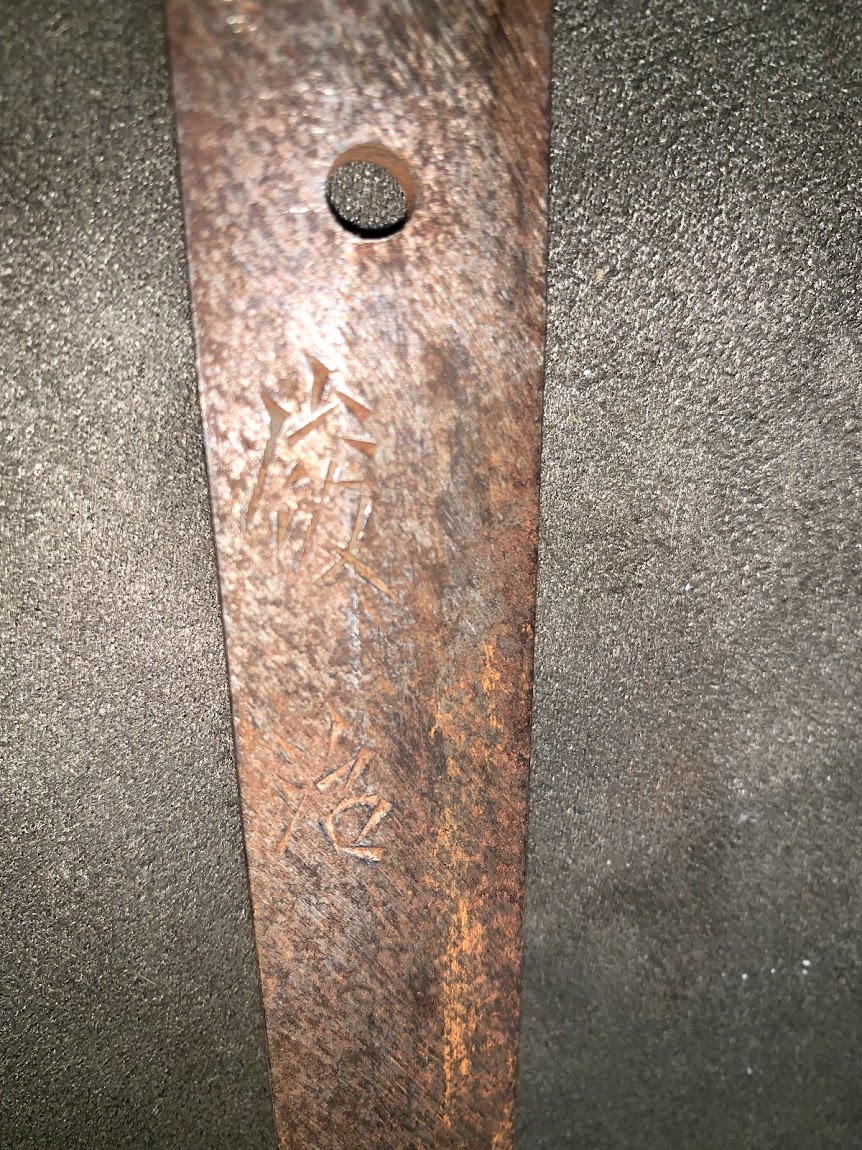

I could not find any serial number on the blade or scabbard. Attached are the images of the item.

This model has no official designation, though most people call I t a type 44, or contingency model. Yours is dated January 19 45. It’s not really accurate to call them “late war” because they were commissioned in 1938 and started seeing production around 1941. They were designed to be a cheaper yet more hearty version of the type 98 officers sword.
Someone else can give you the Smith name, as I’m not good at that.

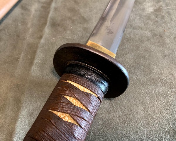

Do you think the guard replacement was done at the time of manufacture due to shortage of others? or was done after some time?
What would the original guard look like?
Somebody correct me if wrong, but the Smith could be:
義近 (Yoshichika)

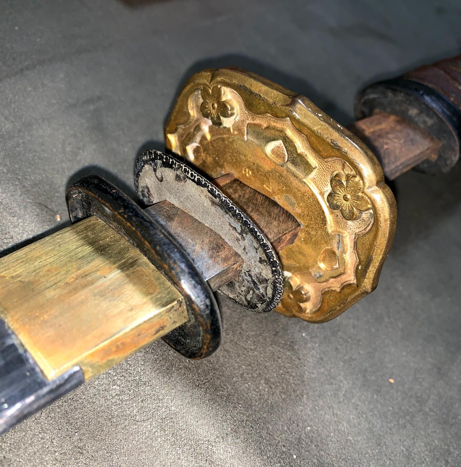

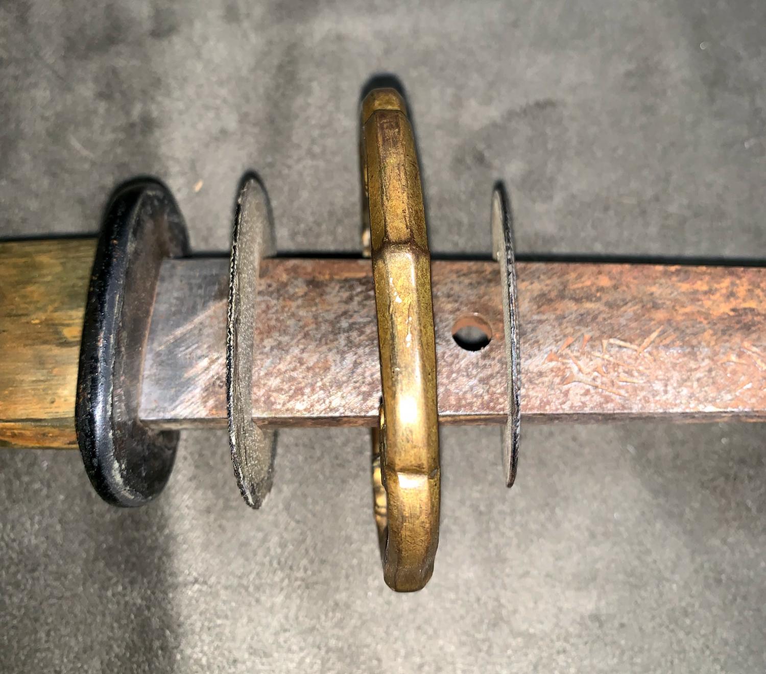

Hard to say about the tsuba, without knowing more of it’s story. In my opinion it’s more likely a post-war effort to replace a missing original. The original was a flat disc:post-3487-0-95867500-1554758341_thumb.png

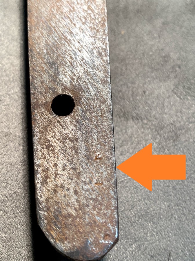

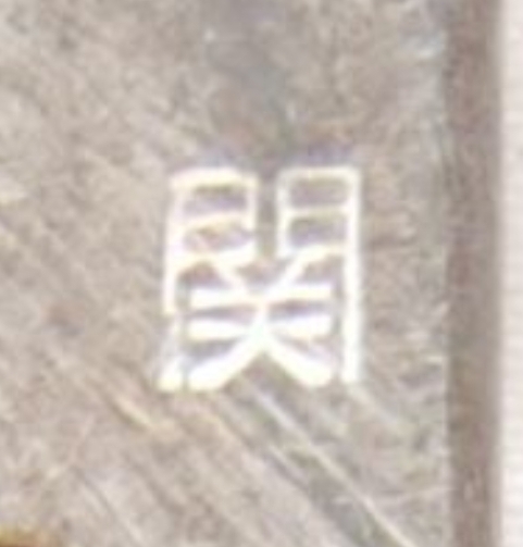

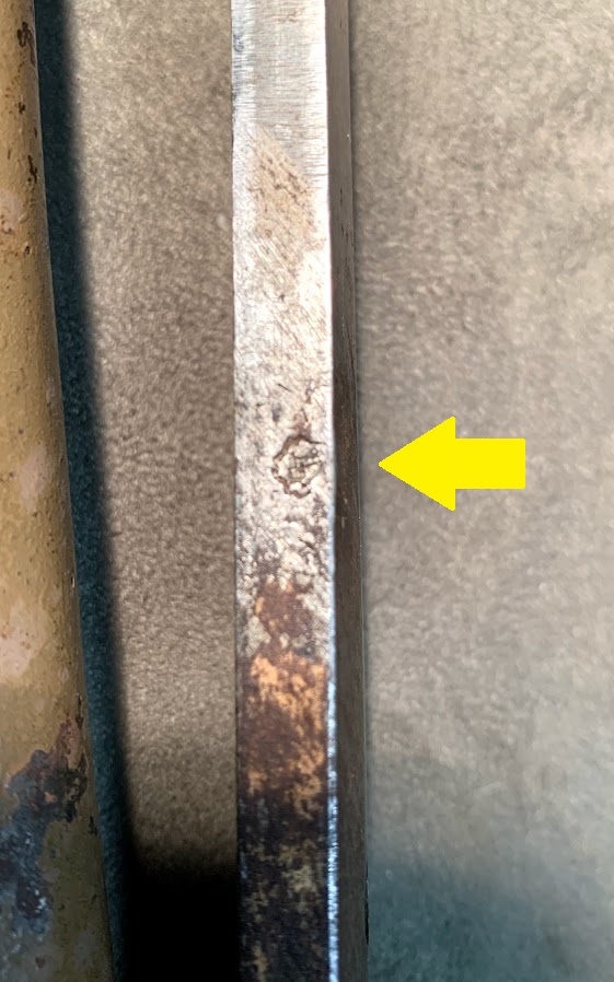

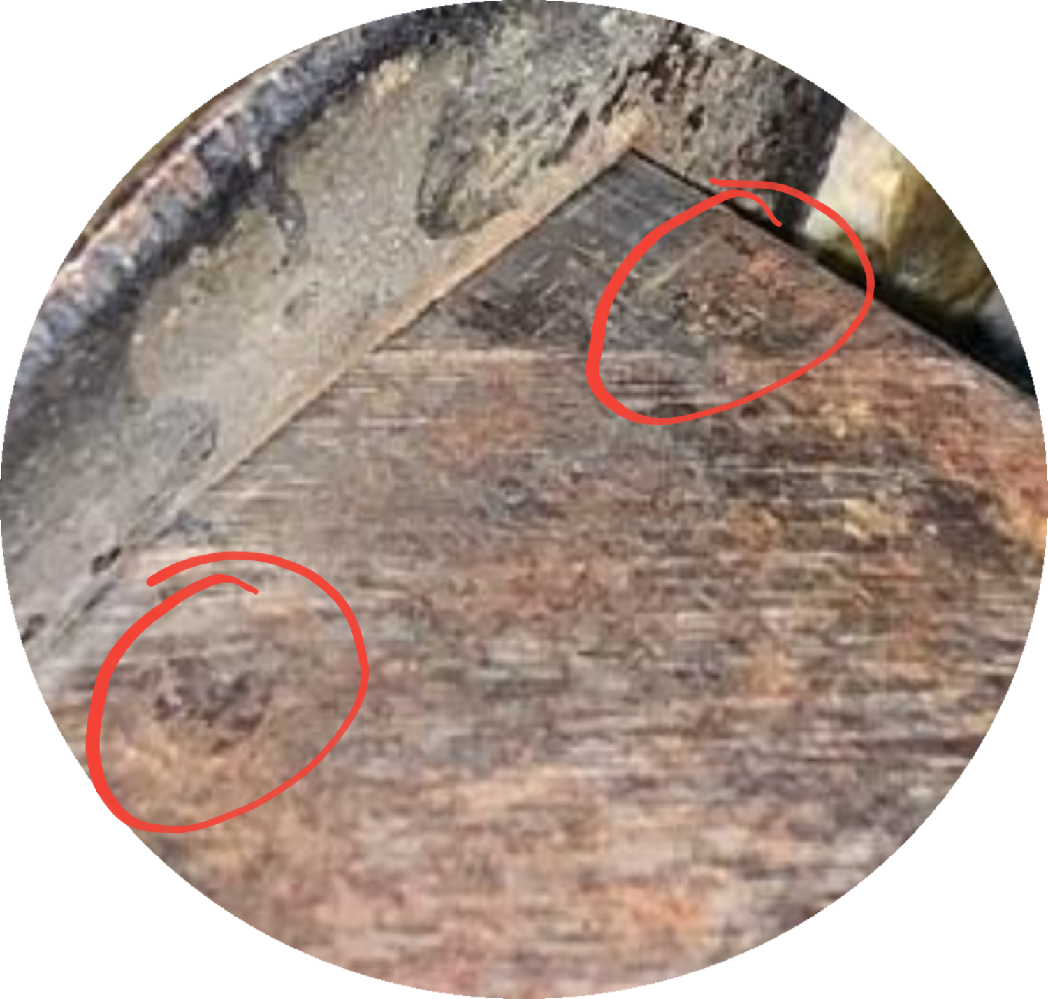

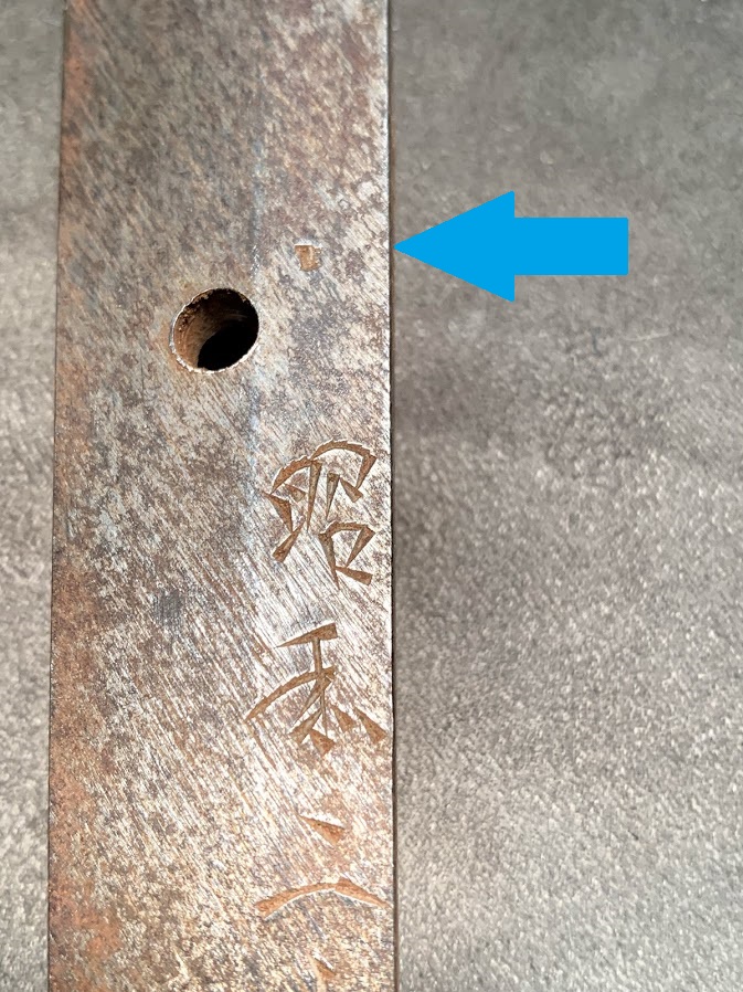

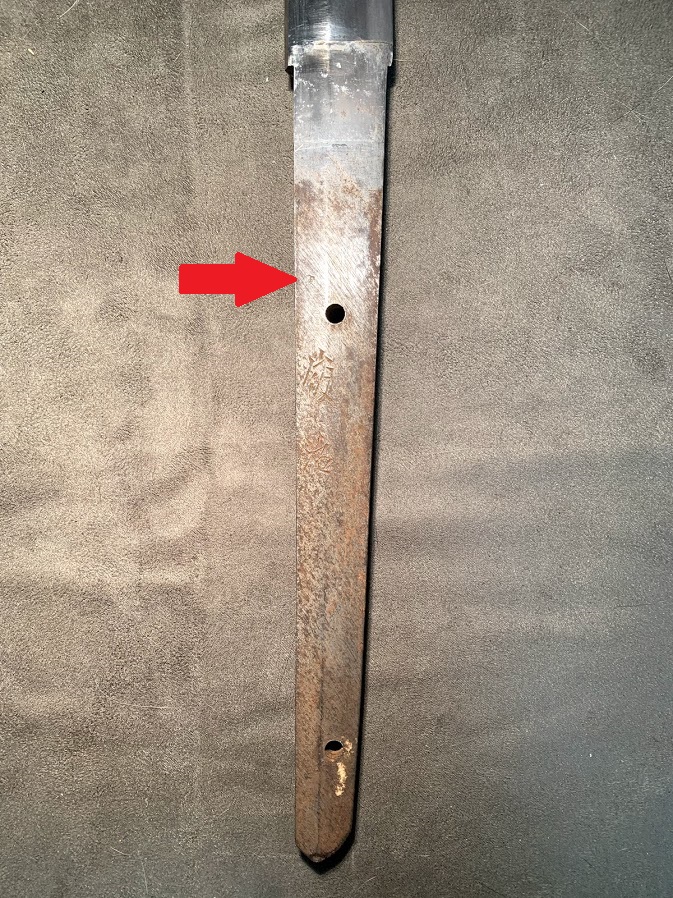

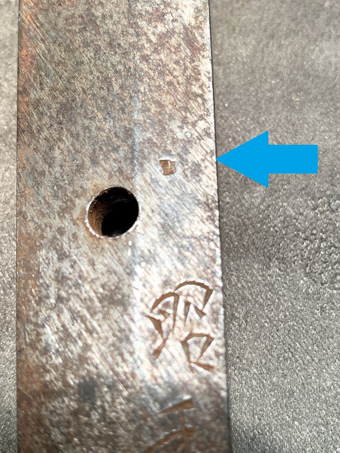

Appears to also have very light struck Gi and Seki Stamps??
Hello,
Where are those located? I will get more detail images of the tang if i know what i am looking for. Is there something i can use to high light the stamps or markings thats not harmful to the blade?
Also with regards to the wrong tsuba, should i attempt to procure a correct one to make it whole or leave it as is?
If i did try to get one what would the accurate description of what i would be asking for?
Scott,
The two are circled in the pic I'm attaching. Just a straight-on, focused picture of those, if you can.

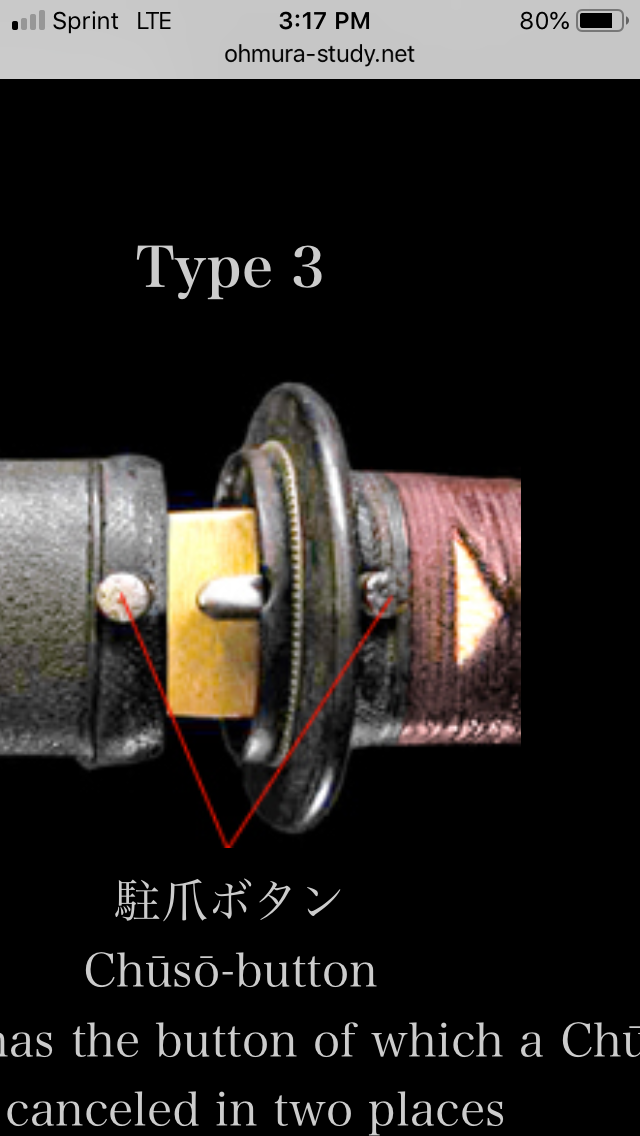

 My bad, I forgot that Mr Komiya is a documents man rather than a picture poster. You might find this link more informative...   http://ohmura-study.net/952.html
Oh that's a great site!,
SO looking at the images my blade looks closest to the STANDARD #1 and #3. My definitely has a Metal skin scabbard with wood inside.
The tsuba was customized to fit for the sword. It is not original. Try to get a iron type 3 tsuba for your sword.

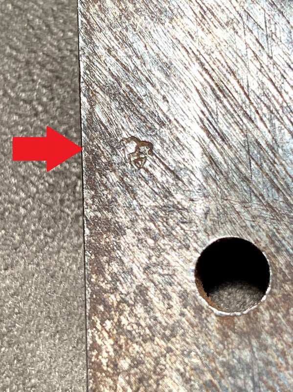

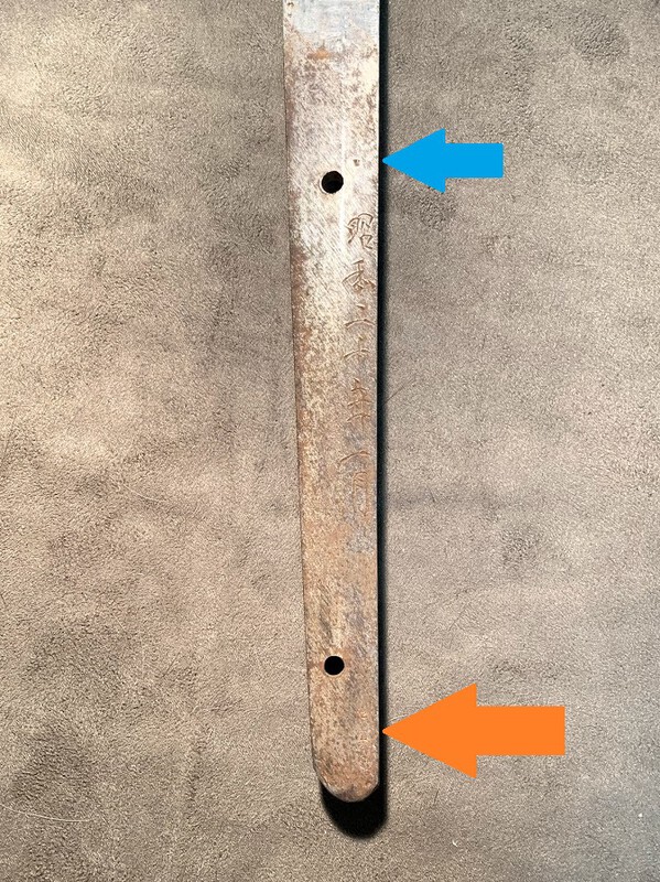

I took some new images of all the markings found, I think i found arsenal stamps.
I also posted clearer images of all the text in the translation section. I have added clored arrows showing the full profile of the side and the location found and then a closeup. There is a Stamp i discovered along the back of the Tang i had not seen before.
Main point is that it is an arsenal blade, not traditionally made. So nice to get it complete, but don't overspend.

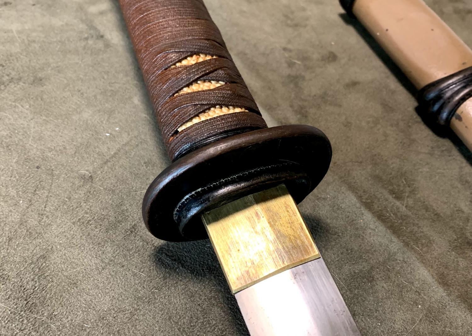

Got the replacement Tsuba for my Type44, Thanks Mark!. It matches perfectly to the rest of the attachments. Now looking at the one that was on it originally i can clearly see now it was not meant for this sword.

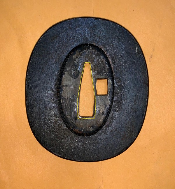

The attached image shows the amount that needs to be filed away (what lies within the yellow line.)
Testing the fit it only slides down the tang about 3/4 of the way.
I used my top Seppa as a guide. It appears i need to remove about a millimeter from the three sides, perhaps a hair more form the spine edge.
What is the best way to file this material?, by hand or possibly using some type of mechanical tool like a dremmel perhaps??
If by hand what type of file is needed to do the work required, i am assuming a round needle file of sorts but wanted to hear what others have used?
I would use a good quality, fine tooth flat metal file that will fit into the current opening. Hold the tsuba firm in a padded vice while filing. It wouldn't hurt to also have available a set of small metal files of various shapes, flat, square, triangular and round. You just never know when a different shape will be needed. :) Take you time and fit often!
Chuck
Its done and i think it looks great!
Here is the final replacement of the Tsuba and how it looks.
Filing was strait forward and the fit is snug. Hows it look?
Blade was cleaned with alcohol and then lightly oiled with 3in1. Had no access to Chioji oil.
Overall the blade looks much nicer now with the appropriate Tsuba.
