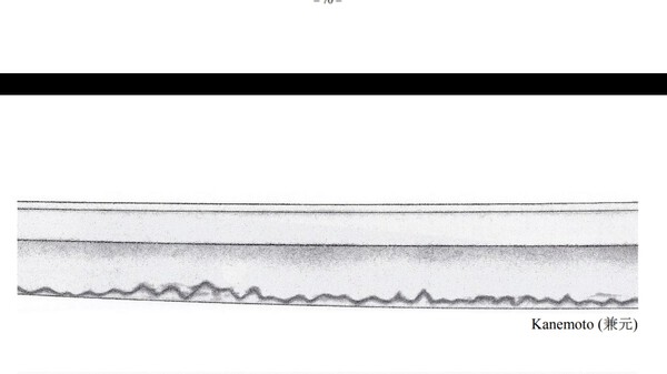

I was thinking Mino-Senjuin (same school as Kanemoto or no?). I found an almost exact match for length, width, hada, etc... Everything is 99% the same but the other Waki (suriage) is from the Nanbokucho era. So my hopes are high????????
EDIT: After some brief research it looks like this could possibly be a second or later generation Kanemoto? The sanbon-sugi is almost exact to the second generation as well as the description of hamon (not regular "3 tree" pattern like later generations but irregular peaks with low valleys)...

Funny I was just reading about Kanemoto in the Connoisseurs book and within the first paragraph it says "swords were known as 'o-wazamono' (very sharp blades) "

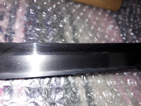

Not one of the Koto Kanemotos.... would have more masame hada (straight grain) along the shinogi-ji if it was... that is if I'm seeing well enough from the pic.
Yeah I agree but based off of this one photo it would be hard to make a judgement like that. In hand the masame hada is definitely "noticeable in the shinogiji", as well as the over all quality of this sword.
I chose that photo because it has the most action in the shinogji and hiraji but virtually almost the majority of the rest is masame hada in the shinogji.
Also, later Kanemotos became more uniform in their hamon and have much different turn backs, whereas this turn back and hamon is literally spot on for Kanemoto II. (Written description anyways and I'm not saying it is)
I could be totally wrong but based on what I see in hand and have read and heard from others, I'm quite hopeful. But I guess there's only one way to find out haha (shinsa). Either way I don't want to get caught up in a "it is or isn't" debate. I've had several people say it looks like a koto Kanemoto before I ever even knew who he was. All I can do is Shinsa and hope.

EDIT: I had the shinogiji confused with shinogi, which is where the majority of actual masame hada is(as well as in the lower hamon/ha). Sorry. So it's very close but either way I still love this blade. So far, even tho it loves to make me bleed, it's my favorite????????

Later generation Kanemoto, 4th onwards. The Sanbonsugi is relaxed but not relaxed enough for Shodai/Nidai.
Hmm everything I see on later Kanemotos showed very uniform and many "3rd largest" spikes in Hamon but I didnt look at many (well I did but not enough haha). Plus the turn-back on Boshi tells me possibly earlier (If it was a Kanemoto). But that's just my opinion and I could (probably am) wrong. Maybe it was one of the Mino smiths close to the Kanemotos who then incorporated many different styles of his teachers? Who knows but It would be funny if it wasnt even a Kanemoto or Mino! I do think its early to mid Koto tho
