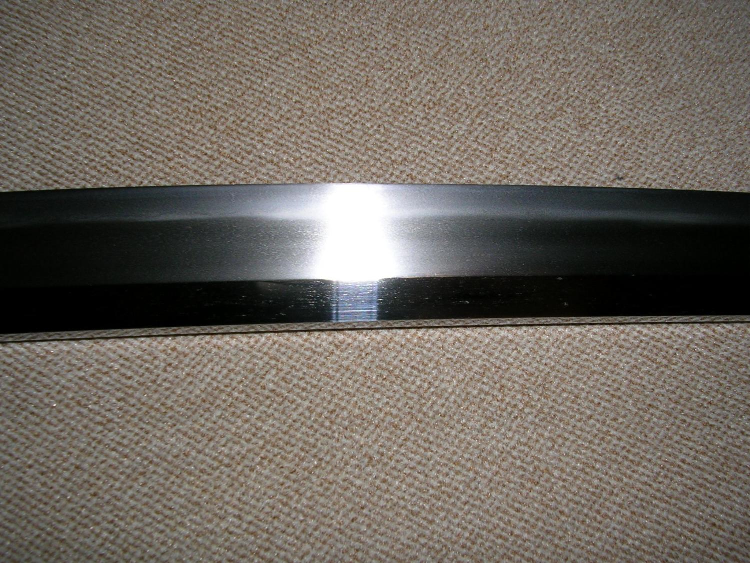

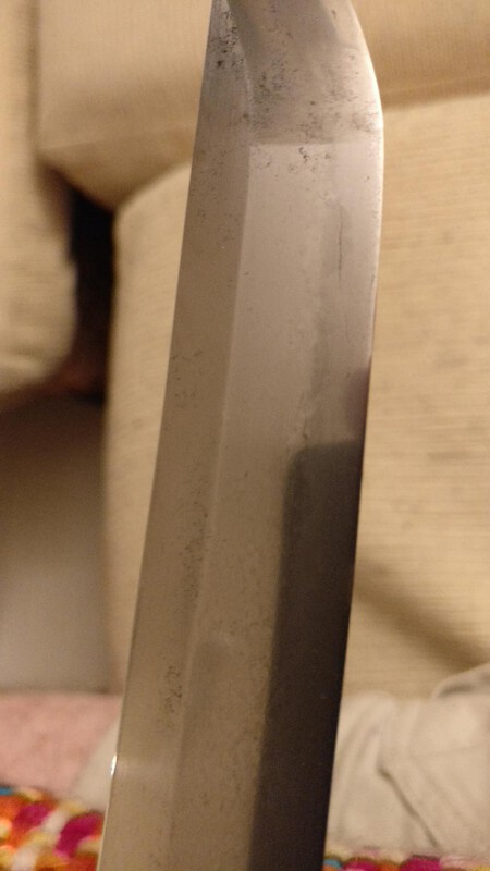

I've recently purchased a nice mumei wakizashi to aid in my study.
Close examination reveals what looks like a horizontal crack in the hamon just below the kissaki.
Where the crack terminates near the kissaki it seems to continue on the other side.
I didn't pay much for the blade so flaws are not an issue for me, I'm just wondering if a polish is a waste of time and simply make it worse?
Any help is greatly appreciated.

Hi John,
Unless there's something special about a mumei wakizashi it almost never makes financial sense to have one polished, even if there isn't a flaw.  Save your money for something better.
Grey

The fact it appears to go through the blade suggests a potentially serious problem. If it was on one side it is possible that polishing would make it worse but might still be worthwhile.
If it does go through the blade has been seriously compromised and weakened and polishing certainly wont improve it.

1. Ware in the hamon cannot be closed or made tighter, the metal cannot be moved/pushed around as it could be in the hada. The other problem with ware is the possibility of becoming larger, opening up, ouch. 2. Perhaps, additional images might reveal something unexpected, otherwise I do not see anything promising so far. 3. The possibility of finding a mumei wakizashi well worthy of polishing does exist, but that requires the skill and ability to recognize (kantei) a hidden gem in the rough, and a little luck.

John, I know you're excited about your new blade, but please listen to voices of experience. You're not going to learn a darn useful thing from polishing a mumei wakizashi with what might end up being a hagire. If you bring it to a reputable polisher, he'll tell you the exact same thing.

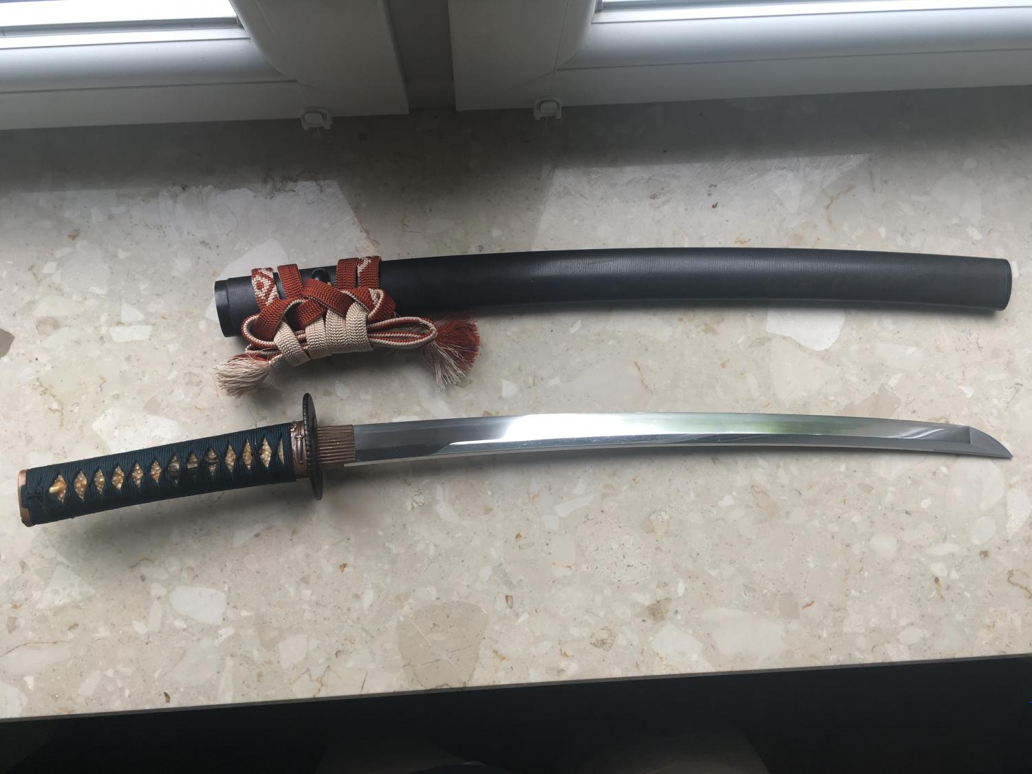

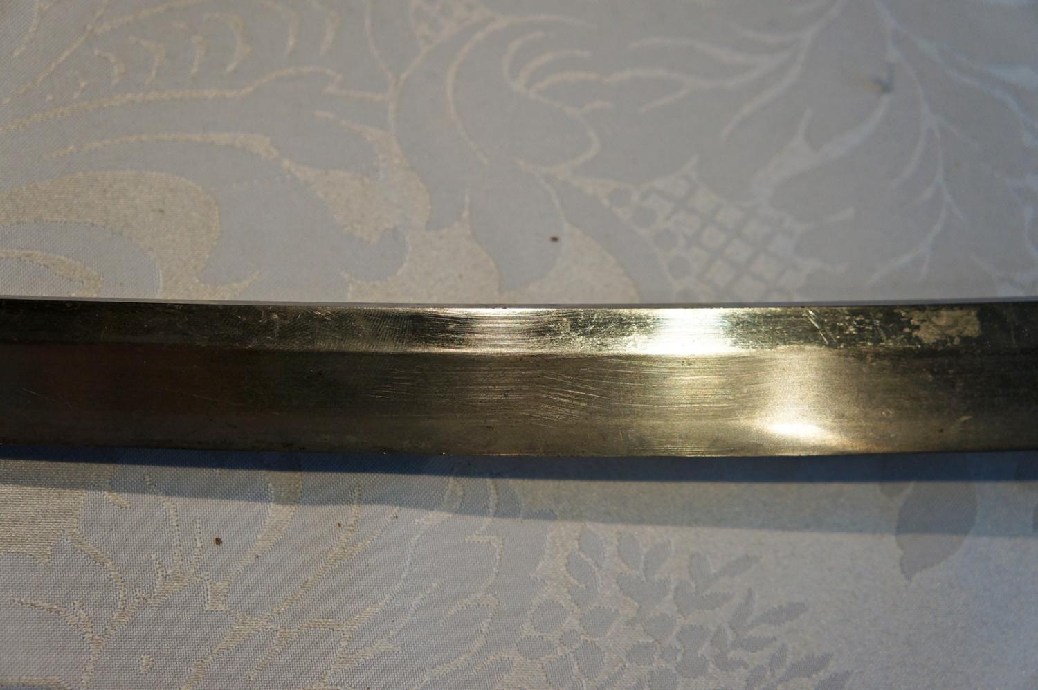

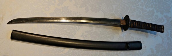

I understand exactly why would you want to polish the blade, it is a quite exciting journey bringing something to live and even if i think Grey is right that mumei blades are not worth all that then other side of me say go for it :) I did the same thing actually! I went for it and got the blades in good hands to be polished only because i have seen something in that blade that was telling me it would pay off + the fact the i bought the blade super cheap as someone though it was a junk. It was a gamble but  i am happy with all that journey and it gave me a lot more that just nice blade on the rack - and after polish bladees shows quite a lot of characteristics of Hizen Tadayoshi blades...will never know for sure though but who knows :) Have a look on the photos before and after and maybe that will help make your mind up :)
Lukas
Before:
After:
Stephen, unfortunately some 'brave' soul at soime point in time tried to 'clean' the nakago so apart from the shape all other possibly helpful information helping me identifying the sword has now gone.
