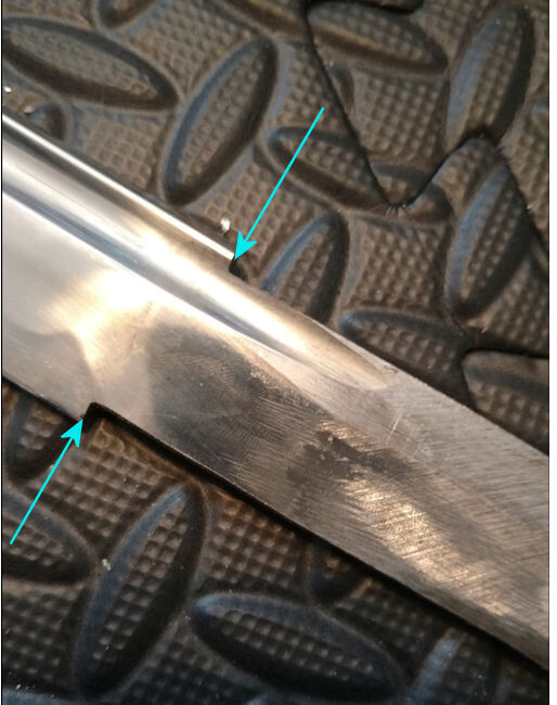

From those photos it sadly looks more likely to have been made in china from the fittings.
Close up, in focus shots of the tip and sections of the blade will help us identifying your sword.

two of them is a bit rare for a tsuka, I'm tending to concur with shogun that its Chinese. the hamon that I can see from the previous pictures looks etched, but it could just be the camera. Hamon is very difficult to capture properly with a camera.
I dont think its a Chinese fake. my guess its one of the swords that they sell in shops in Japan for display and to tourist. He bought it for you with good intentions to honor your friendship, No real value, keep it as a memento.

That does not seem to be an authentic Japanese sword (antique or modern).
Its Hamachi and Mumemachi do not look right.
Tshukamaki looks rather strange to me.
I dont think its a Chinese fake. my guess its one of the swords that they sell in shops in Japan for display and to tourist. ......
Sales of this kind of swords with steel blades is prohibited in Japan. There are many hints that this was not made in Japan.

But yeah, unfortunately this isn't a real sword, and value will be minimal. The sentiment and thoughts attached to the gift are priceless though. Sorry it won't help with the fund raising, but you get to keep the gift and the thoughts attached.
