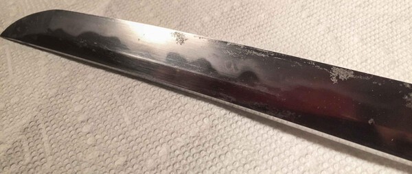

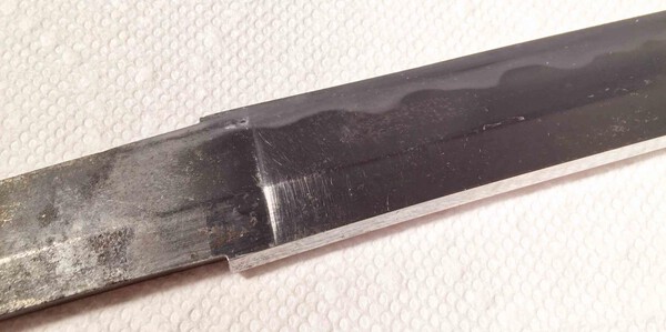

Okiiimo Posted January 14, 2016 Report Posted January 14, 2016 I am a new member and as promised on my new member introduction, I’ve provided a write up of a blade I recently acquired. Please forgive me if my usage of nihonto terms are incorrect. I do invite criticism and correction as I believe it is important to be open to them in order to gain knowledge and experience. I do not intend this blade for resale; I am interested in learning more about it and studying it further. Acquisition I purchased this sword at a local antique shop for $475. The shop specializes in estate jewelry, Alaskana (Alaska native artifacts, regional artwork and historical artifacts), firearms and general antiques. I went in with the honorable intent of finding a birthday gift for my wife (she likes antique jewelry) when I spied an officer’s gunto and decided to take a look at the blade. Although my distant relations in Japan have managed to keep a few blades hidden away, I’ve always regretted that they will never be handed down my side of the family line. Therefore, I’ve always wanted a gunto since my grandfather was an IJA officer, to serve as a surrogate for a family heirloom. On observation, the blade did appear to have a hamon and in the right reflected light, there appeared to nioi although it was difficult to tell because the lighting was poor and the blade surface was covered in old oil and finger prints. The blade did have patches of pitting but the lines looked nice and there didn’t appear to be any severe abuse to the blade. The mountings looked authentic to my inexperienced eye and the wear patterns between the parts seemed appropriate with each for lack of a better description (note I’m drawing on prior experience used to determine if USGI 1911 pistols are later assembled from parts or represents the reasonable wear patterns of an issued and used firearm). On the hilt were the remnants of a mon which I would guess is oxidized silver since it was blackened, that had been carefully filed down. I guessed that the sword was surrendered which the original owner did to prevent dishonor to his family clan. Although the mekugi was partially out, but I did not ask to remove it to take a look at the nakago. I figure the price was OK for what it appeared to be, I liked the historical aspect of it as a surrender sword and I was secretly hoping the blade to be traditionally made. The proprietor mentioned in passing that the blade was made in the 1930’s. Closer Inspection At home, after I received begrudging approval from my wife for an unauthorized purchase, I was allowed to inspect the blade closer. The mekugi easily slid out indicating that the blade had been inspected. The nakago was nicely patinated and it had a signature. It appears to have been chalked so I wouldn’t be surprised if another had studied this blade and may have further background on it. I was thrilled! I quickly snapped a photo and texted my mother for translation assistance and she could make out “Fujiwara” and didn’t recognize the other writing. I called another family friend and after a few minutes of research on their end consulting a Japanese dictionary passed on that the first few characters said, “Hoki no Kami Fujiwara…” but couldn’t make out the last characters correctly. I then set task to the wisdom of the internet using the same search words and came across what appeared to be a nearly identical signature which was translated as “Hoki no Kami Fujiwara Hirotaka”. Questions I’ve attached some photographs of the blade and fittings and I hoping for more information regarding this sword. My questions are: Are my impressions and observations correct? Preservation – the scabbard is pretty worn and probably doesn’t help with the long-term preservation of the blade. Any suggestions? I’m especially concerned with the pitting at the kissaki. Does it appear too deep for the blade to be considered for restoration? Thank you for taking the time to read my post. Regards, Allan N. Quote
Ed Posted January 14, 2016 Report Posted January 14, 2016 Your translation is correct. Can't comment on the legitimacy of the mei. Looks ok, but I have none to compare it to. Shinsa coming up in February. Good place to have the mei authenticated. Pitting in kissaki is a concern, but you would need to have a professional polisher take a look at it. Regarding the saya. I would oil the blade and leave it alone unless you decide to polish it. With polish you will have to have a new shirasaya built for it. But I wouldn't do it until then. Quote
Brian Posted January 14, 2016 Report Posted January 14, 2016 Congrats. It's real and likely traditionally made, and for the price, you did great.I don't think a professional would have a problem restoring that kissaki. Ed's advice is good. Brian Quote
Kronos Posted January 14, 2016 Report Posted January 14, 2016 Agreed, good advice from Ed. In regards to the pitting, it looks pretty deep, however a good polisher imho will be able to get rid of most of it or possibly elect to reshape the kissaki slightly and move the yokote down which would eliminate all the pitting (this is an extreme option as you're losing steel so a bit unlikely in this particular case). Overall the pitting is not a big problem and if any remains it will be very minor and only left there to preserve as much of the blade as possible. For $475 you've done very well even if gimei as it looks like a well made sword and the hamon does remind of Hirotaka although not really my area. The sugata/nakago/nakago-jiri/yasurime are also correct for this smith. Here's a mei comparison: Quote
lonely panet Posted January 14, 2016 Report Posted January 14, 2016 Im going to be a downer, sorry but I think the kissaki is lost. had a small pit on a gendaito, took it to a well regarded togi, and he said it will never polish out. but it cant hurt to try, regards Quote
SwordGuyJoe Posted January 14, 2016 Report Posted January 14, 2016 Im going to be a downer, sorry but I think the kissaki is lost. My opinion - which is worth one-half of what you're paying for it - is that I have to agree with Hamish on this one. Quote
Grey Doffin Posted January 14, 2016 Report Posted January 14, 2016 Not sure but if I had to guess I'd say the the kissaki is salvageable. Only a properly trained polisher can say for sure. Grey Quote
Stephen Posted January 14, 2016 Report Posted January 14, 2016 Agree with Grey, in hand is the sure way to tell. Quote
Greg F Posted January 14, 2016 Report Posted January 14, 2016 Great score Allan. Imho i think the blade is worthy of a good polisher to do what he can even if a few small pits are still visable. A shirasaya is necessary I think. All the best. Greg Quote

Kronos Posted March 3, 2016 Report Posted March 3, 2016 Nice one Allan, Did Chris mention the pitting at all or show it to a togishi who may of been at Tampa? Quote
Brian Posted March 3, 2016 Report Posted March 3, 2016 When a sword costs $475, and gets 76 points, then it really starts to become worth it to polish. I would. Maybe consult with the service mentioned here: http://www.militaria.co.za/nmb/topic/12772-sword-polishing-service-in-Japan/ Your initial outlay was minimal, so it is worth spending some money on it imho. Congrats, that is a surprise and welcome result. 2 Quote
Okiiimo Posted March 3, 2016 Author Report Posted March 3, 2016 Stephen - I have the same affliction of making decisions with the heart over head. Sentimental value is what I'm trying to convey to my wife. Suggestions from experience in this type of spousal negotiation is invited! Kronos - Chris said the togi-shi did take a look at it and said it was difficult to tell without taking it to the stone. Before shinsa is sent a photo of it to Mr Benson who thought it could polish out however I can appreciate the judgment is not based on in-hand observation. So far I take the togi-shi opinions it to mean restoration might be possible which is far better than an outright no. Brian - Great advice and justification. I'll have to borrow it. Better yet, may I have your number so I can have my wife call you? Perhaps start a nihonto spousal negotiation service? (Joking Regards, -allan 2 Quote
Kronos Posted March 3, 2016 Report Posted March 3, 2016 Personally if it were my sword I'd send it to Bob Benson to inspect in hand and if he thought the kissaki would polish out I'd get him to polish it and put in a shirasaya. There are always risk with a polish as it can reveal fatal flaws etc but from a purely financial perspective if it polishes ok it should easily be worth more than the $2-3k restoration would cost. It must be noted though that waiting lists are long so a 1-2 year turn around is expected. Quote
Stephen Posted March 3, 2016 Report Posted March 3, 2016 Right James, on one note ive never waited more than six to 9 months with Bobby, with the pitting that may take a little more time. Quote
J Reid Posted March 4, 2016 Report Posted March 4, 2016 I think bob works on a piece to piece basis. I had a kissaki repaired by bob for $225 and about a 2 month turn around. It's the full polish and shirasaya that takes time. 1-1 1/2 years. Kunitaros service is also efficient and takes a fraction of the time. Regards, Josh 1 Quote
