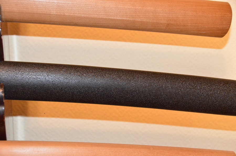

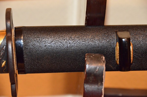

Back from restoration, the saya was beyond repair totally roten inside (it was the original one), Had a new one made, the lacquer was redone at the identical.
The tsuka was not the original one neither the tsunagi (close but not the blade tsunagi). Tsuka was unbinded, nakago split, recarved (small adjustment to adapt the Tametsugu) and rewrapped and rebinded, new mekugi ana drilled in the tsuka, same adapted, unvisible.
A friend of mine, John, he is very good for shirasaya, koshirae, tsuka binding and has learnt lacquer at the University with a Japanese teacher. He is the one who has made the koshirae for my Naoe Shizu :)
