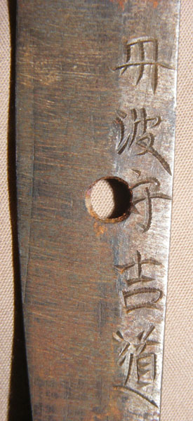

dankgus Posted February 11, 2009 Author Report Posted February 11, 2009 I resisted pushing out the wooden pin to remove the blade for a couple years now even though everybody has always told me that is the way to learn more about the piece. Well, today I went ahead and did it and it went smoothly. Attached is a picture of the engraving hidden inside the handle. THANKS! --Dan Quote

Jean Posted February 11, 2009 Report Posted February 11, 2009 Mei reads : Tamba no Kami Yoshimichi ...... Swing low, sweet charriot, coming for to carry me home .... Quote
Mike Posted February 11, 2009 Report Posted February 11, 2009 I will take the risk and say that the mei reads (at list to my untrained eyes ) as tamba (no) kami yoshimichi. If so, this is not the mei of the famous smith of course, but I don't know for sure whether it is gimei or just much later smith. I will add that to me the dagger looks like a tip of longer blade so the odds go towards gimei. Mike edit- while struggling the kanji here came Jean and bits me, at list I wasn't wrong reading Quote
Jean Posted February 11, 2009 Report Posted February 11, 2009 Hi, suspect that this tanto is the shortened end of a once longer blade. Not from the Hi (groove) It is not Gimei and not intended to be (for the ones who have seen the Kyo or Osaka Tamba mei) Quote
loiner1965 Posted February 11, 2009 Report Posted February 11, 2009 does tamba no kami yoshimichi favor sudare-ba hamon...or am i on the wrong track as normal Quote
Brian Posted February 11, 2009 Report Posted February 11, 2009 There is no chance this is by any Tanba (no) kami Yoshimichi. Nakago shape is rough and yasurime indicate WW2 manufacture. As seen previously, I think these types of mei are patriotic wishful thinking for soldiers. Brian Quote
Markus Posted February 11, 2009 Report Posted February 11, 2009 Often with patriotic sayings on them. At least the going-to-fade sayagaki reads "Namu-myôhô-renge-kyô ?-michi ??", probably stating "Yoshimichi". FYI: http://en.wikipedia.org/wiki/Daimoku Quote

John A Stuart Posted February 11, 2009 Report Posted February 11, 2009 The mei has been added as a honorary mei for tradition as some WW II swords had. It was not made in an attempt to copy the original Yoshimichi line style of signature. I think this is what Jean alluded to. John 1 Quote
kusunokimasahige Posted February 11, 2009 Report Posted February 11, 2009 @ Brian, thanks for the explanation, that was exactly what i meant. If it is a Yoshimichi, it would be better indeed to photograph the entire blade without the habaki The Namu-myôhô-renge-kyô ?-michi is an old Nichiren sect saying and the michi stands for the road of....... So it might well be a kamikaze dagger since on those these sayings were quite common... however!! we find the same saying also on WWII infantry officer blades... Hope that helps... please send us full pictures of the entire blade. KM Quote
Nobody Posted February 11, 2009 Report Posted February 11, 2009 At least the going-to-fade sayagaki reads "Namu-myôhô-renge-kyô ?-michi ??", probably stating "Yoshimichi". FYI: http://en.wikipedia.org/wiki/Daimoku The last four characters are 日蓮上人 (Nichiren shonin), which means The Venerable Nichiren. Ref. http://en.wikipedia.org/wiki/Nichiren Quote

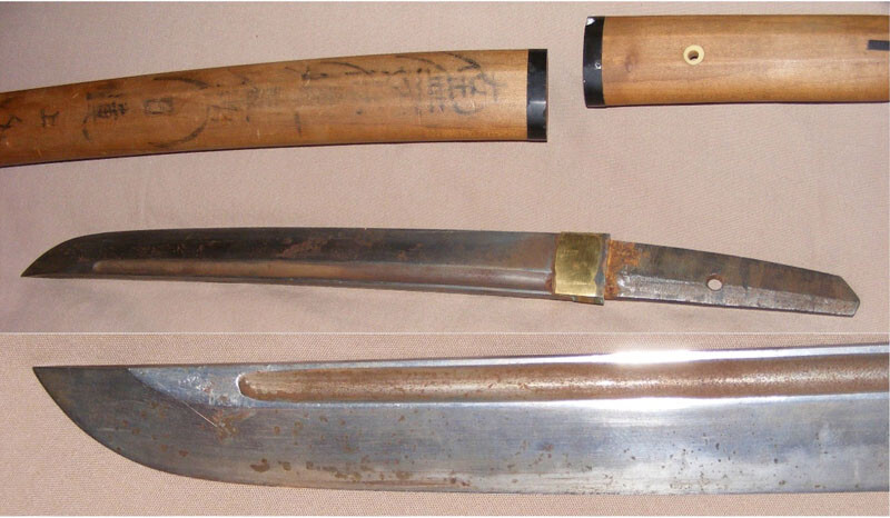

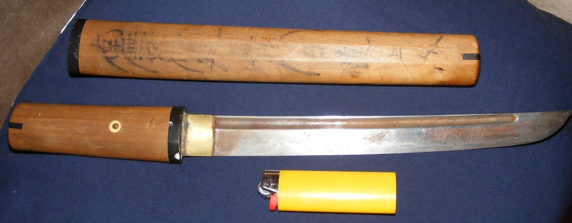

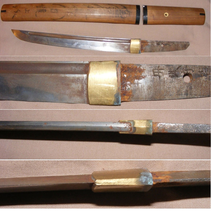

dankgus Posted February 12, 2009 Author Report Posted February 12, 2009 Sorry about that extended delay, as excited as I was yesterday about this knife I still managed to have more important things get in the way of taking more pictures. Here are the latest pictures taken this morning, let me know if I can be more specific in taking photos, I don't mind taking as many as necessary to discover new information about this piece. THANKS AGAIN! --Dan Quote
Brian Posted February 12, 2009 Report Posted February 12, 2009 Resized and re-uploaded to reduce file size. I don't think there is much more you can discover about this one. Still seems to me to be a generic Japanese soldier's tanto/knife carried during WW2. If you had to describe it, you could say ...of the type carried by Kamikaze pilots, but without the link that can't be proven. has the usual patriotic signature sometimes found. The groove seems to indicate it isn't shortened from a longer blade. I am unsure if it is traditionally made or oil quenched more mass produced, but I expect the latter. Nicer than many you see, but I don't think older than WW2. Nice item though, and you need to oil it and keep wiping to remove as much rust as possible without using anything abrasive. Oil that habaki too..and after a few days see if it will slip off without force. Possible it is soldered on there? Looks like there was some heat to the habaki in any case. Brian Quote
Stephen Posted February 12, 2009 Report Posted February 12, 2009 think the color on the habaki is from corrosion on the nakago, id want to stop that rust fast, mabye a good soaking in a oil bath, at least brush oil on the dark red rust by the habaki, needs some TLC Quote
dankgus Posted February 12, 2009 Author Report Posted February 12, 2009 If you had to describe it, you could say ...of the type carried by Kamikaze pilots, but without the link that can't be proven. Brian You made me laugh, by saying what you did you reminded me of the many times I have been annoyed by somebody saying something like "this knife was possibly used to defend the owner and his family from an attack by a rabid mountain lion while out picking berries." Do you get what I am saying? I mean, anybody can say things like "perhaps used to", "very likely", "possibly ejected from the wreckage as a kamikaze finished his final mission" and technically still not be lying or misrepresenting something. I would feel embarrassed if I described things in my life to be more than they really are. Anyway, I just thought it was funny. I really, really appreciate the input. Any more observations, please let me know, I am very interested and learning a lot from all of this. Thanks, --Dan Quote
Brian Posted February 12, 2009 Report Posted February 12, 2009 Yep..get your point. I only added that because with the patriotic saying also written on the outside of the saya, that gives it just that few extra % possibility that it might have been from a pilot. No way of knowing, and if I had to bet, I would say not. But they were known to do this kind of thing. However it is more likely that some officer or soldier carried this inside his tunic as a reminder of his past and as a morale booster. No definite texts on this subject as yet. Do a seach anywhere (even on this forum) for kamikaze dagger or dirk and you should pull up pics of the more typical type of soldier's knife. Here is one example: Brian Edit to add: I think there is a small chance that genuine pilot's daggers had a hole at the bottom for a neck lanyard. That will need more research though. Quote
leo Posted February 12, 2009 Report Posted February 12, 2009 Osaka Tamba you can probably rule out because neither tang nor mei looks like 17thcent. There were several Kyo Tamba though working in the 19th cent. but I do not know them well and indeed the hamon does not look like sudare-ba to me. Mei looks abit strange, too. Imho blade is earlier than Showa(sorry to contradict you there, Brian), so everything, including shortening and resigning is possible. Greetings to all, Martin Quote
leo Posted February 12, 2009 Report Posted February 12, 2009 Sorry, was feeding my dogs and missed page 2. Realized now that you were far beyond the Yoshimichi theme. The new photos look different. Martin Quote
