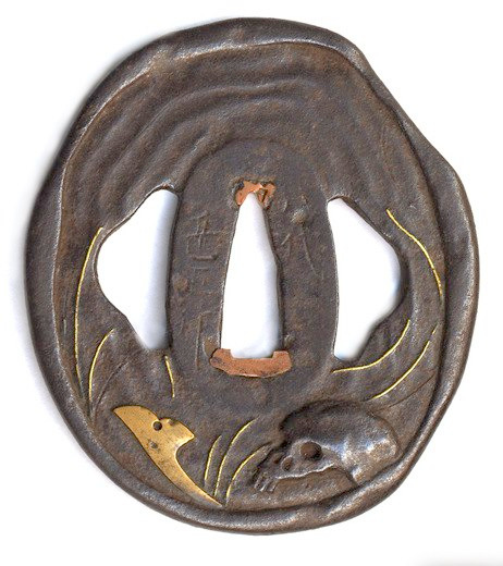

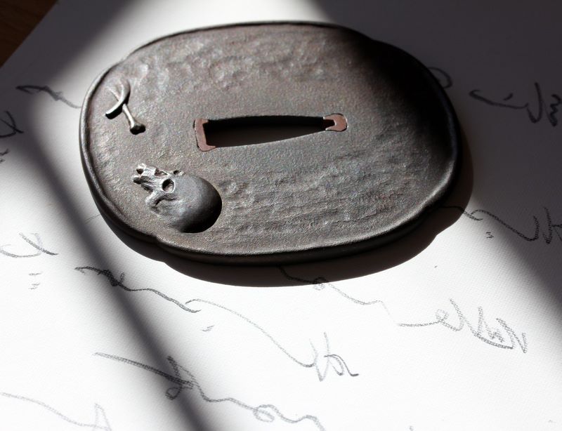

This is one of my favourite versions of this motif. Shimizu Jingu IV, if memory serves.
And it's interesting that Malcolm cites the Basho haiku he does...I'm actually busy at the moment inlaying it on a tsuba, the other side bearing my own interpretation on the 'skull and bones' theme.
Very much still a work in progress.

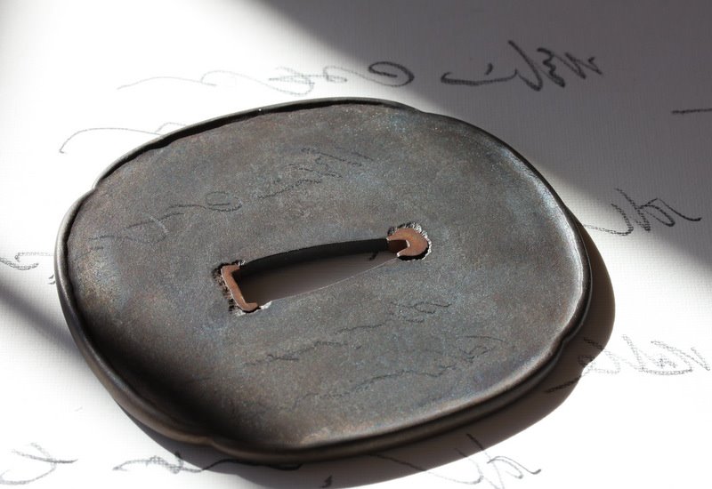

May I please request from Sebastien some details re his lovely kinko tsuba, including an image of the reverse side? With many thanks,John L.
Sure, here are the other side.
It was the n° 80 of the Lecuire collection's auction sale in Paris 2012.
The description give it to 18th century. H. 8,5 cm.
With reference: similary tsuba in Mène collection, Charpentier & Lair-Dubreuil sale, 1rst Sale 1913, n°421.

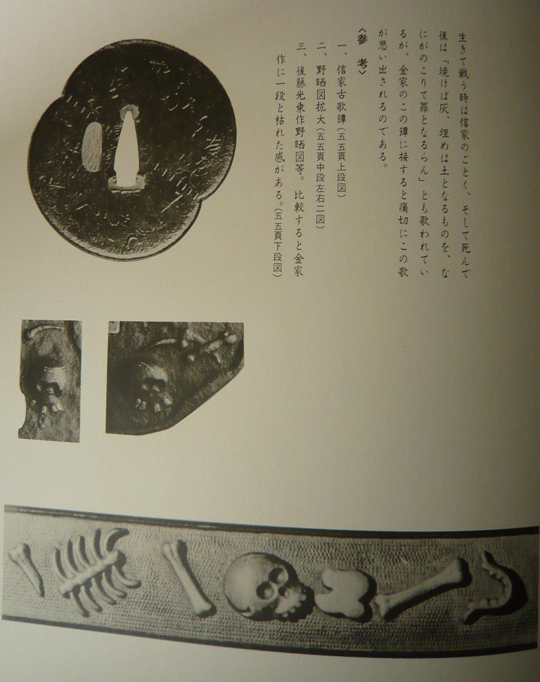

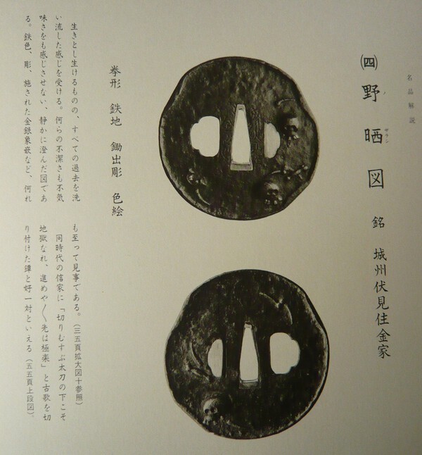

Below are tsuba by Kaneie and Nobuie with the motif of skulls. They are from the Ikeda books and I have done a translation of any text. (Sorry about the bad pictures and the bad translation).
I wonderf if Kaneie was the first to use this motif?
野晒 図 Field Bleach Motif
生きとし生けるものの、すべての過去を流す,流した感じを受ける。何らの不潔さも不気味さをも感じをせない、静かに澄 んだ図である。鉄色、彫 、施 された金銀象嵌 など、何れも至って見事である。
同時代の信家に「切りむすぶ太刀の下こそ地獄 なれ、進めやー先は極 楽」と古歌を切り付 けた鍔と好一対 といえる。
This tsuba gives a sense of time passing of all living things. There is nothing unclean or weird about the motif, it is peacefully clear.
The beautiful iron, the carving and the applied gold and silver inlay are all extremely pleasant.
It is from the same period as this Nobuie, that has a well matched old poem carved on it
"To be cut under the long sword is hell, to advance forward is paradise"
生きて戦う時は信家のごとく、そして死んで後「焼けば灰、埋めは土となるものを、なにがのこりて罪となるらん」とも歌われているが、金家のこの鍔に 接すること痛切にこの歌が思い出されるのである。
Nobuie's tsuba gives a feeling to live through battle and then to die later, "To burn to ash, to become earth, what remains becomes guilt". Kaneie's tusba touches on this feeling.
一、信家古歌鍔  1. Nobuie old poem tsuba
二、野晒 図拡大 2. Field bleach magnified image
三、後籐光乗作野晒図。 比較すると金家作に一段と枯れた感じがある。3. Goto Kojo Bleached Field work. Compared to Kaneie work, it is much more developed.
Below is a Nobuie with the similar theme. There are no notes with this picture.
