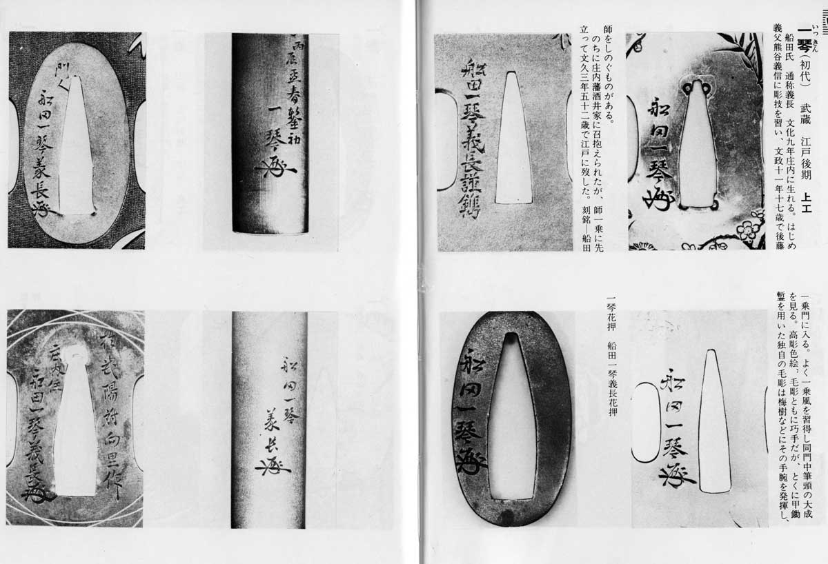

Kinkō Meikan lists IKKIN (First Generation) on pp.13a – 14d, and IKKIN (Second Generation) on pp.15a – 15d. It notes that the first artist used the gō of Yoshinaga, and the second those of Yoshiyasu and Yoshimori. Also that the work of the second master resembles that of the first, but that there is a ‘slight difference’ in their kao. Indeed, the kao illustrated for these two artists are quite different, and I would personally question the reliability of these attributions.

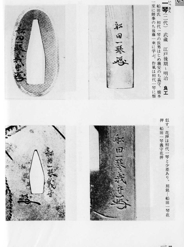

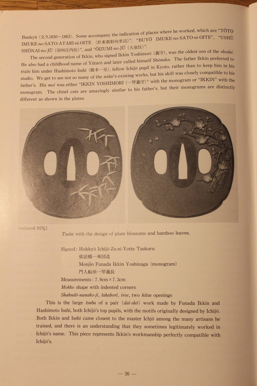

There is an excellent article on Funada Ikkin on pp.25-29 of the English edition of the Token Bijutsu, 1991, No 48. In this it is stated that ‘the chisel cuts [of Ikkin I] are amazingly similar to his father’s, but their monograms are distinctly different ….’ These are reproduced, and show the same differences as are illustrated in Kinkō Meikan.
If these illustrated kao are indeed those of the first and second master respectively, there should be no difficulty in distinguishing between the work of these two. Although I have found no suggestion that Ikkin I changed his kao during his lifetime, I do wonder if the current literature makes the distinction between the two masters too simple to be true?

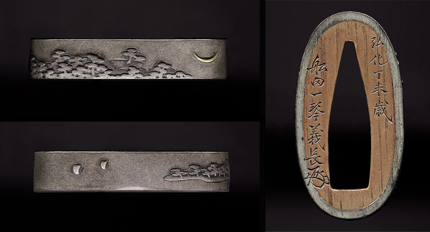

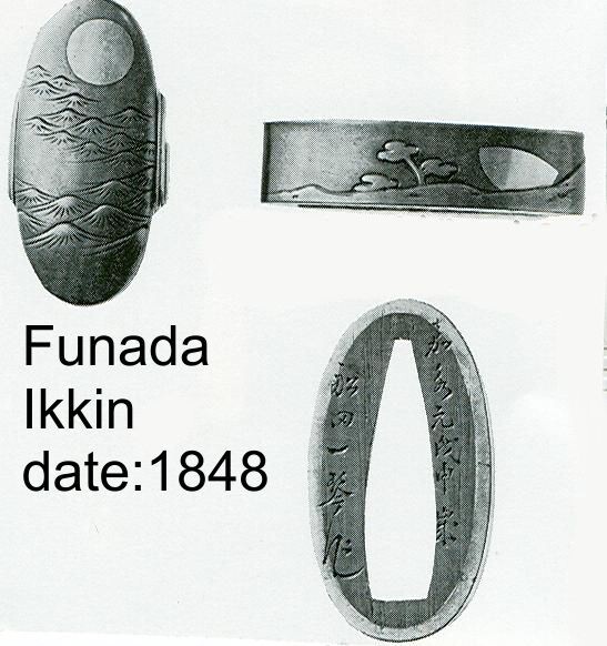

What do you make of the fuchi on Boris' site that has an alternative kao and a date too early to be the son? Surely such an obvious mistake wouldn't have been committed on a deliberate fake.
For ease of discussion I've added an image here. I hope you don't mind, Boris.

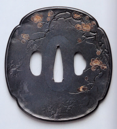

he he...Bob, I was keeping this one back 'til later :D I was intrigued by this mei when we first looked at it. It seems to embody a paradox.
The kao appears to be that which is generally considered to that of the first master, ie; Ikkin I yet included in the mei is the Go (art name) Yoshimori, supposedly one of the Go of the son. Looking at the workmanship of the example you link to (and which I was most desirous of ;) ) we can easily recognise that this is not the work of an "also ran". This particular tsuba is easily the equal of any number of highly praised contemporaneous works. The sculpting of the figure's face in particular is quite exceptional.
What are we to make of this?
I look forward to reading the Token Bijutsu article sometime soon, if Paul is good enough to scan it for us. Merci Paul. :)
Boris’ fuchi is very interesting. The date of 1847 clearly places it in the period of Ikkin I (1812-1863) rather than in that of Ikkin II (1840-1885). While the kao differs from those normally associated with either of these masters, both the quality of the work and the mei suggest that this is probably a genuine work by Funada Ikkin I. Does this suggest that this artist may have used an alternative kao during his working life?
Please correct me if I am mistaken, but I see no paradox in the Bonham tsuba. The kao is that generally attributed to Ikkin II: an attribution supported by the use of the gō of Yoshimori.

I pleased you agree that Boris' fuchi appears legitimate and that we may now have identified a second Kao as used by Ikkin I. As I mentioned at the start there is a similar example in the Baur collection. I'd suggest that if we accept Boris' one as genuine, and obviously quite rare, then it's likely the Baur example is genuine also. Why fake a relatively unknown kao?
Paul very graciously emailed me a scan of the Token Bijitsu article and the differences in the 2 generations kao is quite marked. There are, once again, far more examples of the Sho-dai and here we see yet again some significant variety on essentially the same mei.

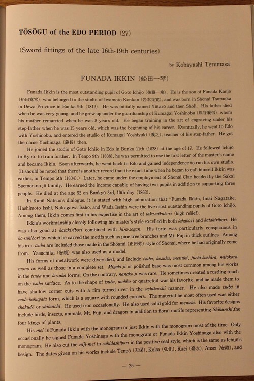

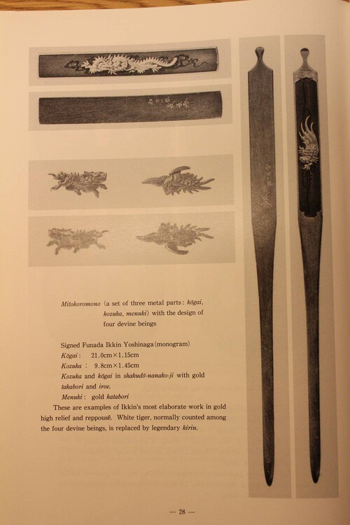

(Sorry-just now read about this inquiery...here´s the requested info
Page 25-29 TBJ 48/1991
hope this helps?
(if larger size needed-let me know...)
Christian
