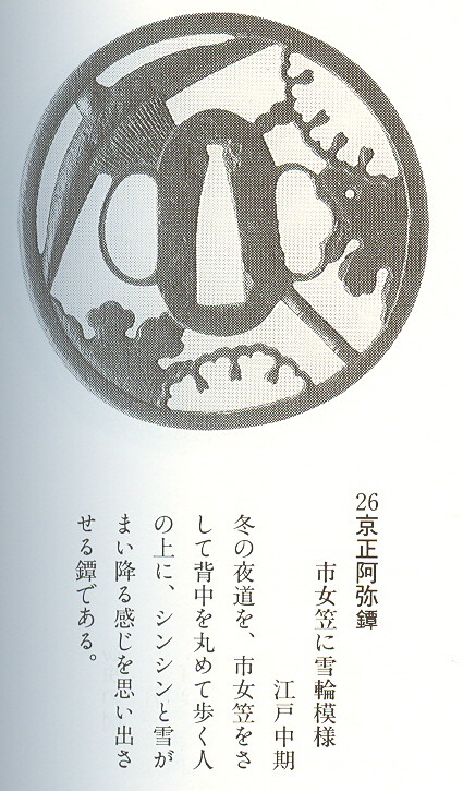

Pete Klein Posted March 2, 2007 Report Posted March 2, 2007 I had a feeling I'd seen this somewhere recently. It is in Tsuba-no-bi. I've also seen it with the nunome but I can't find it in my references yet. Possibly it was on a sales site at some point. This is attributed to mid-Edo. Quote
Rich T Posted March 2, 2007 Author Report Posted March 2, 2007 in fact my tsuba was sold with a copy of the book, but they are not the same. The most basic difference in my Karegane ( geese ) and this has a snowflake or goard or something in it's place. Also, mine has sekigane, the punch marks are different, and more subtle differences, but yes, it is very close. I used another scanner and came up with a different result, the colour is closer here and also the tusba is slightly Migaki-ji so the uneveness in colour is a result of that. The darker patches at the bottom on the mimi (left hand scan) are more like the natural colour in hand. Cheers mate Rich Quote
Pete Klein Posted March 2, 2007 Report Posted March 2, 2007 Are you sure it's not chidori? Awful small for karigane. Quote
Rich T Posted March 2, 2007 Author Report Posted March 2, 2007 but I think Karegane as it is winter related. If it were an Owari tsuba or earlier (Muromachi/Momoyama), the size may be an issue but it feels like the bird is high in the air to me, and small as a result. That might just be my over active imagination of course :-) Rich Quote
Pete Klein Posted March 3, 2007 Report Posted March 3, 2007 High huh -- methinks birdie tis not alone! LOL Quote
Nobody Posted March 3, 2007 Report Posted March 3, 2007 I had a feeling I'd seen this somewhere recently. It is in Tsuba-no-bi. I've also seen it with the nunome but I can't find it in my references yet. Possibly it was on a sales site at some point. This is attributed to mid-Edo. As for the motif, the explanation for the attached image says "Ichimegasa (市女笠) and Yukiwa (雪輪)". However, I think that the explanation is incorrect. Ichimegasa is a something like a hat shown on the 2nd photo. And I think that the parasol may be more like Nodategasa (野点傘), which is a sunshade usually used at outdoor tea ceremony. See the 1st photo. Quote
Rich T Posted March 3, 2007 Author Report Posted March 3, 2007 Hi Koichi, thank you for that information. The papers have been translated with Yukiwa Kasa Sukashi Tsuba 雪輪傘透鍔 I agree it is obviously a Parasol or Umbrella. Cheers Rich Quote
