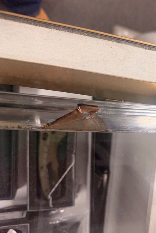

The Japanese military group on Facebook seems to be mixed with one guy insisting it was a copy, another said legit and no one quite knew what was going on with the blade peeling. Whether it was chromed or if that’s cosmoline?
Looks good to me Nick.
Either chromed or very highly buffed (unfortunate either way).

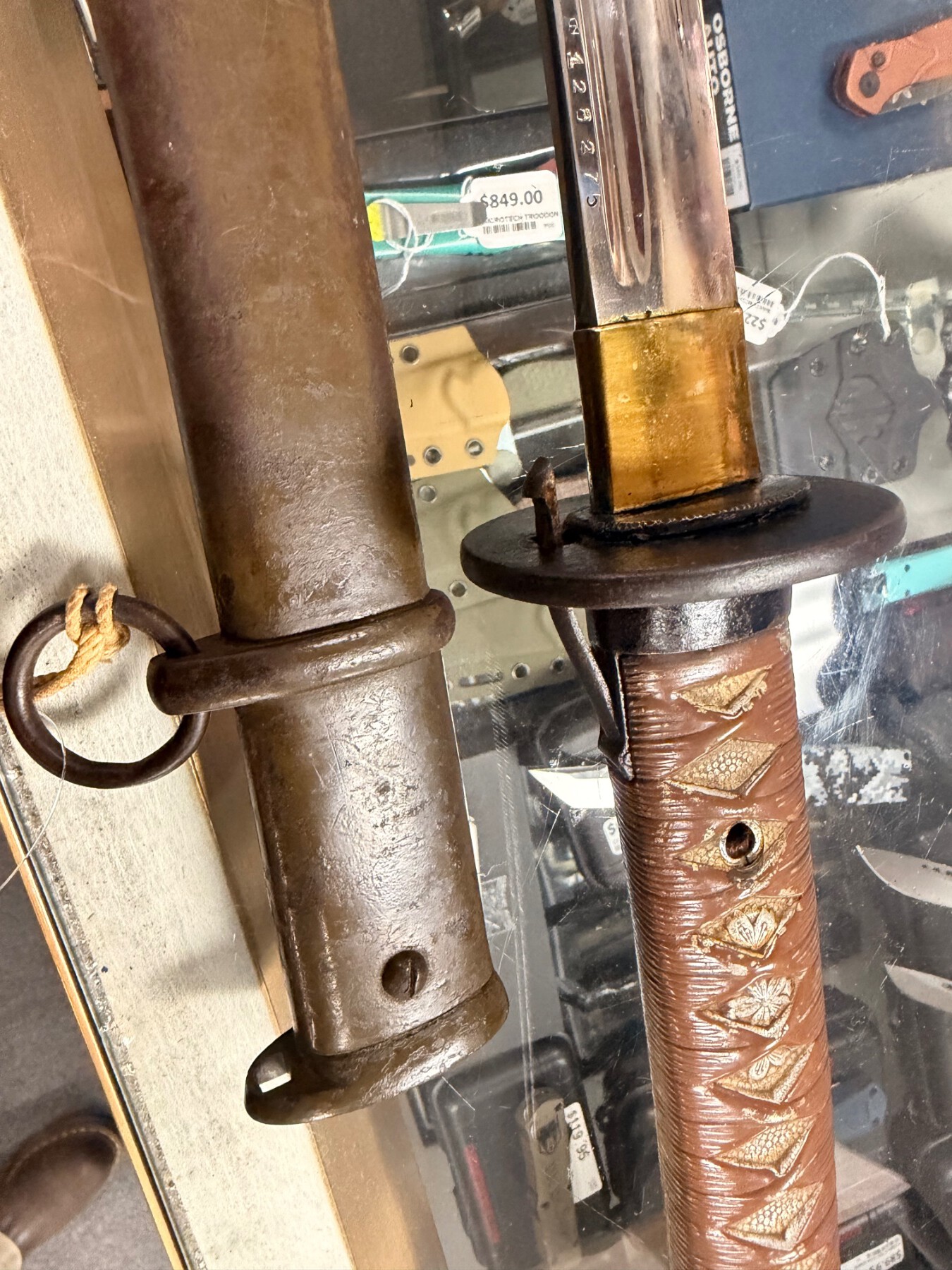

Missing the mekugi screw and its highly unlikely you will ever find an original.  One option would be Ebay seller 'Bobby Military Store' who sells chinese 'replicas' but no idea about the quality.
If the blade is peeling then its bad chrome not cosmoline.
1 hour ago, Jetblack2013 said:
What is this? Chromed?
If that’s damage to the blade and not something stuck to the blade, I definitely would not buy it. It’s too easy to find nicer examples out there.
It’s like it was chromed and is peeling in that spot.

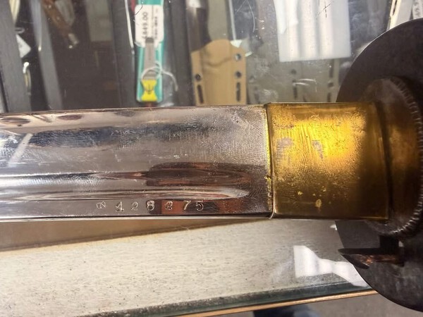

1 - All nagoya stamped blades have the serial number oriented this way, with the edge up. This is standard and not upside down.

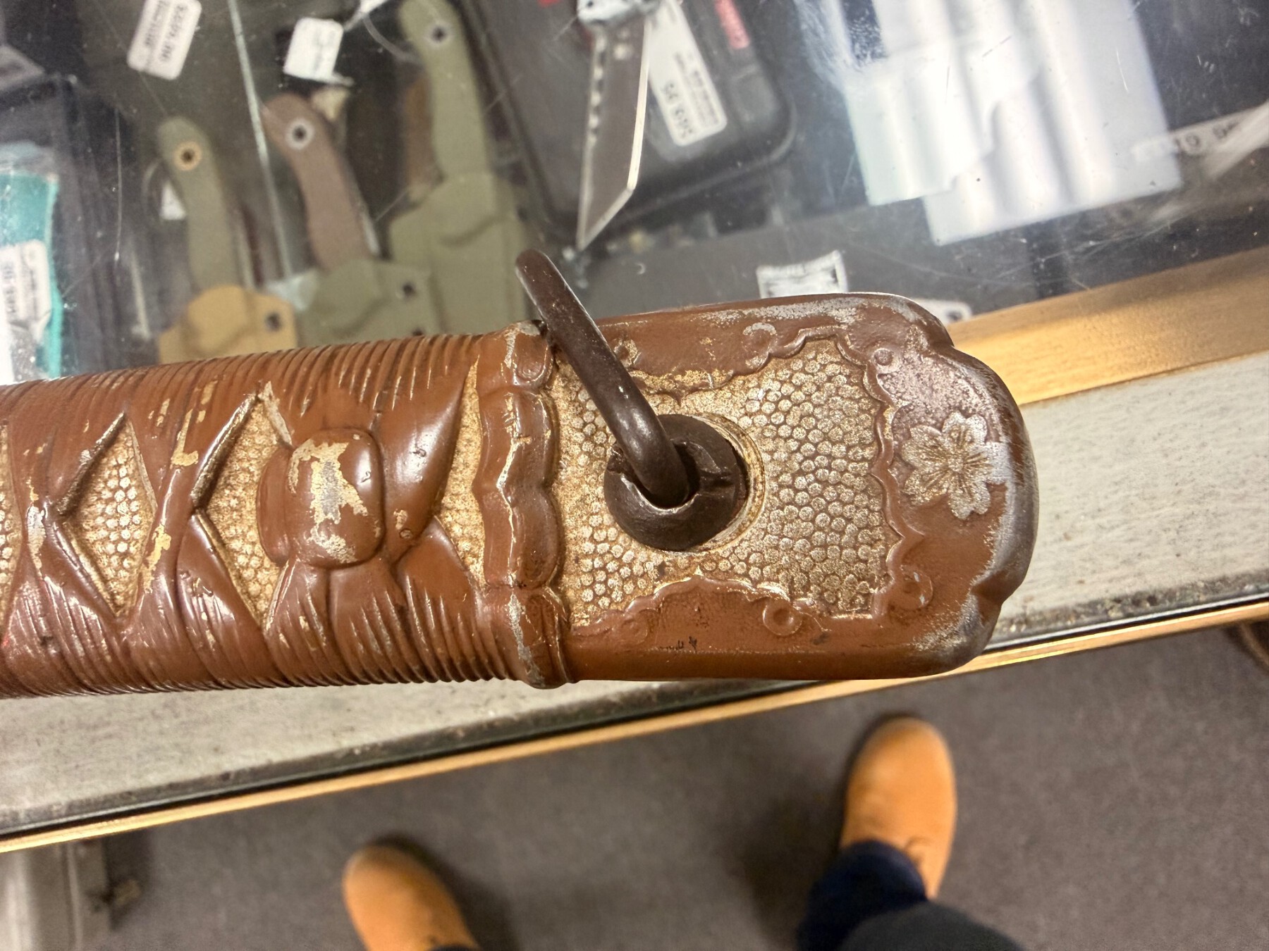

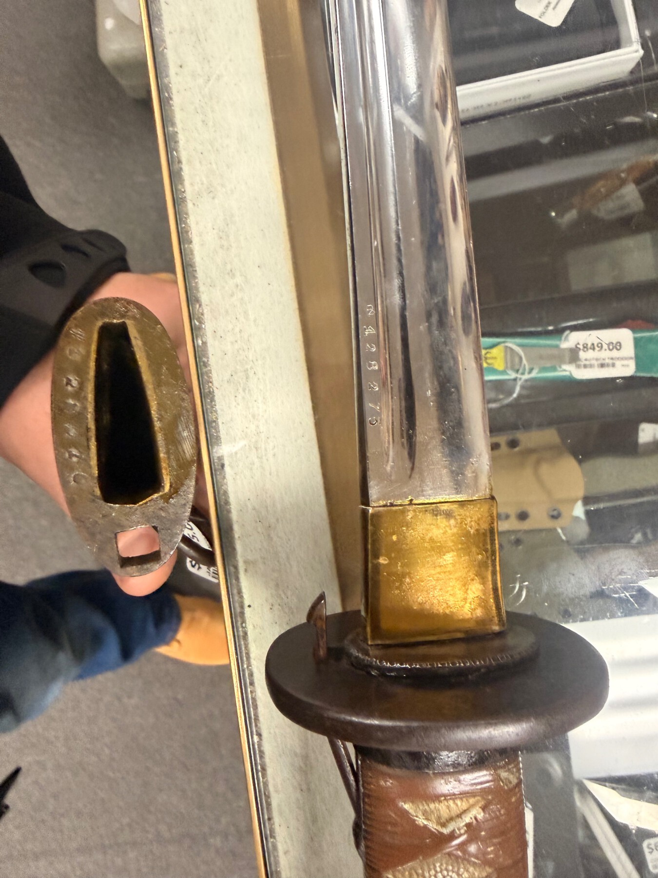

2- The iron ferrule did not take stamps particularly well, and this specific range of Type 95s is known for weak or poorly struck markings.
3- There is some variation in serial number fonts, and the one shown here looks consistent and correct to me for this range.
4- the Nagoya blade stamp does look very shallow, but that’s also been observed before, and could be exaggerated by whatever has been done to the blade.
What I think we’re looking at is an example that received some buffing, and then maybe been chromed; although I’d like to see better pictures of that spot for any level of confidence diagnosing what that is.

Looks like a thin film peeling off the blade. Doesn't looked chromed to me but more likely polished with compound and wheel. For $895, like others said.....hard pass is the right choice

He said the “Nagoya stamp is fake” and thought the ferrule was “shameful”. Another said “Oh God that pawn shop got ripped off”. I’m not sure what that statement was based on since everyone here seems to think it’s authentic and we don’t know what the shop paid for it.

This is a legit Nagoya 95, but the blade has been chrome-plated, and the handle screw is missing. Interestingly, the 名 inspection stamp is stamped sideways.

I don't like the blade and the habaki. The Habaki is shinny and looks like the same as on the polish replica.
Maybe it is assambled together from parts and the blade is fake whatever.
Or it is what it is.
Looks like the habaki was painted gold and some got onto the blade. I suppose that could be a reflection though.

suspect the blade was buffed before being chromed.
