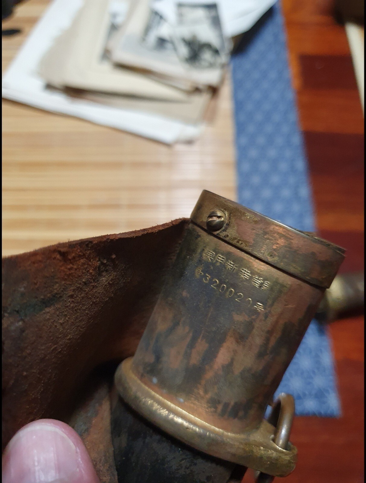

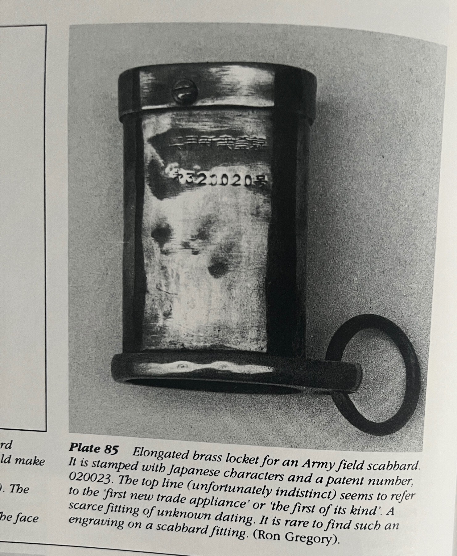

John C Posted October 5, 2025 Report Posted October 5, 2025 I have not seen this before, however the sword itself looks legit. https://www.ebay.com/itm/167833814915? John C. 2 1 Quote
Kiipu Posted October 5, 2025 Report Posted October 5, 2025 Maybe a registered utility model number? Quote
Mikaveli Posted October 6, 2025 Report Posted October 6, 2025 Is it: 実用新案登録 I'm not sure about the fourth and last characters? 1 Quote
Rawa Posted October 6, 2025 Report Posted October 6, 2025 (edited) Definitely patent. Here you go another one. You can pick tsukamaki color It's patent for saya only? -no metal parts [leather cover?] -both examples have mumei blades https://www.liveauctioneers.com/item/215034172_japanese-katana-sword-w-saya-willoughby-oh Edited October 6, 2025 by Rawa 1 Quote
Bruce Pennington Posted October 6, 2025 Report Posted October 6, 2025 Well, call me surprised! Never seen patent numbers on saya before! 1 Quote
robinalexander Posted October 6, 2025 Report Posted October 6, 2025 Another on a very nice old blade with a sword guy in Melbourne. 2 Quote
Mark C Posted October 6, 2025 Report Posted October 6, 2025 Hi All, Is the number for the Ashi attachment or the whole saya? Regards Quote

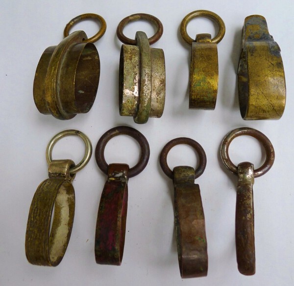

Rawa Posted October 6, 2025 Report Posted October 6, 2025 (edited) 3rd example in cover with similar wood black lacquered saya. Imo for entire saya with cover. Adding picture with mix of hangers. Edited October 6, 2025 by Rawa Quote
Rawa Posted October 6, 2025 Report Posted October 6, 2025 @robinalexandercould you get picture of entire saya? Wonder if there is any "horse shoe" ending. It could have same number. Quote

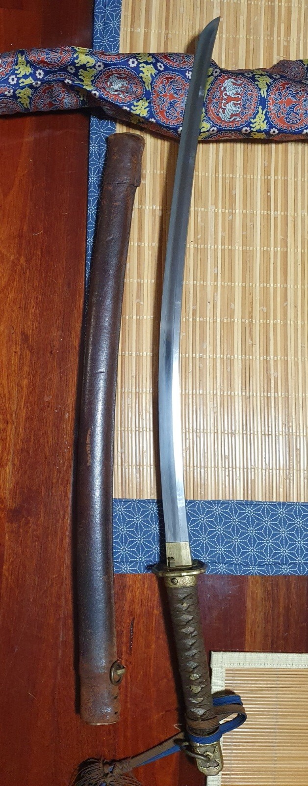

Mark C Posted October 6, 2025 Report Posted October 6, 2025 The first picture and your example both have a wooden saya. I've owned something almost the same without the numbers on that fits the top end of a wooden saya. Regards Quote
Rawa Posted October 6, 2025 Report Posted October 6, 2025 (edited) 36 minutes ago, Mark C said: The first picture and your example both have a wooden saya. I've owned something almost the same without the numbers on that fits the top end of a wooden saya. Regards But his have leather cover so could be complete. Edit. I found 4th example. https://docs.prod-indb.io/2019/11/14/115915_670647078_1c797384ff244e1a6d564edc798667ce.pdf Edited October 6, 2025 by Rawa 1 Quote
Kiipu Posted October 6, 2025 Report Posted October 6, 2025 19 hours ago, Mikaveli said: 実用新案登録 I think the characters are a bit stylized and the last one is hard to see. I do think that what you have is correct though. 第320020号 = No. 320020. Maybe a second opinion is in order. @SteveM 1 Quote
robinalexander Posted October 7, 2025 Report Posted October 7, 2025 15 hours ago, Rawa said: @robinalexandercould you get picture of entire saya? Wonder if there is any "horse shoe" ending. It could have same number. Sorry Marcin, not possible BUT if it ever comes into my possession...I will be happy to post. Provided I was able to safely remove the combat cover which is unlikely. Quote

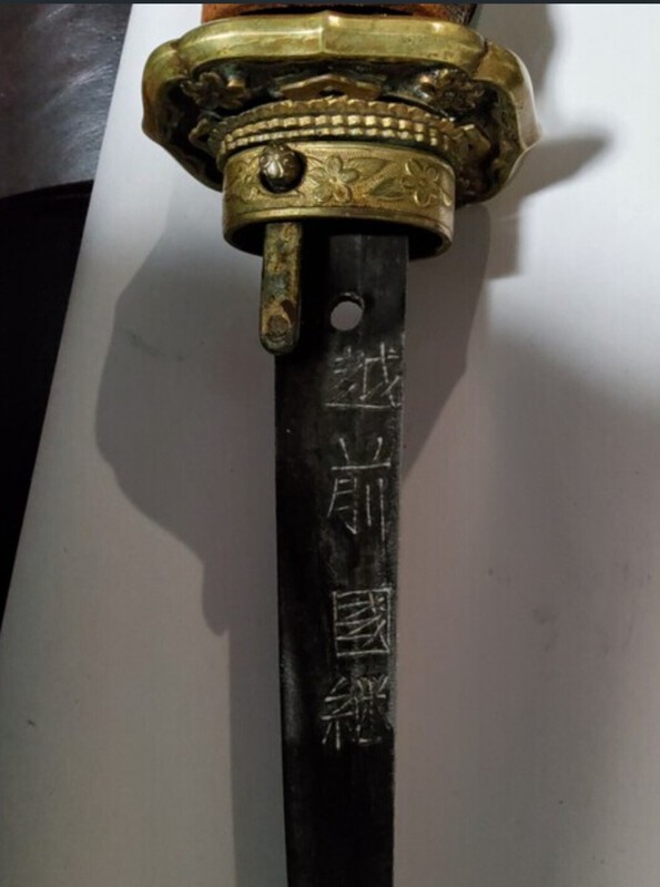

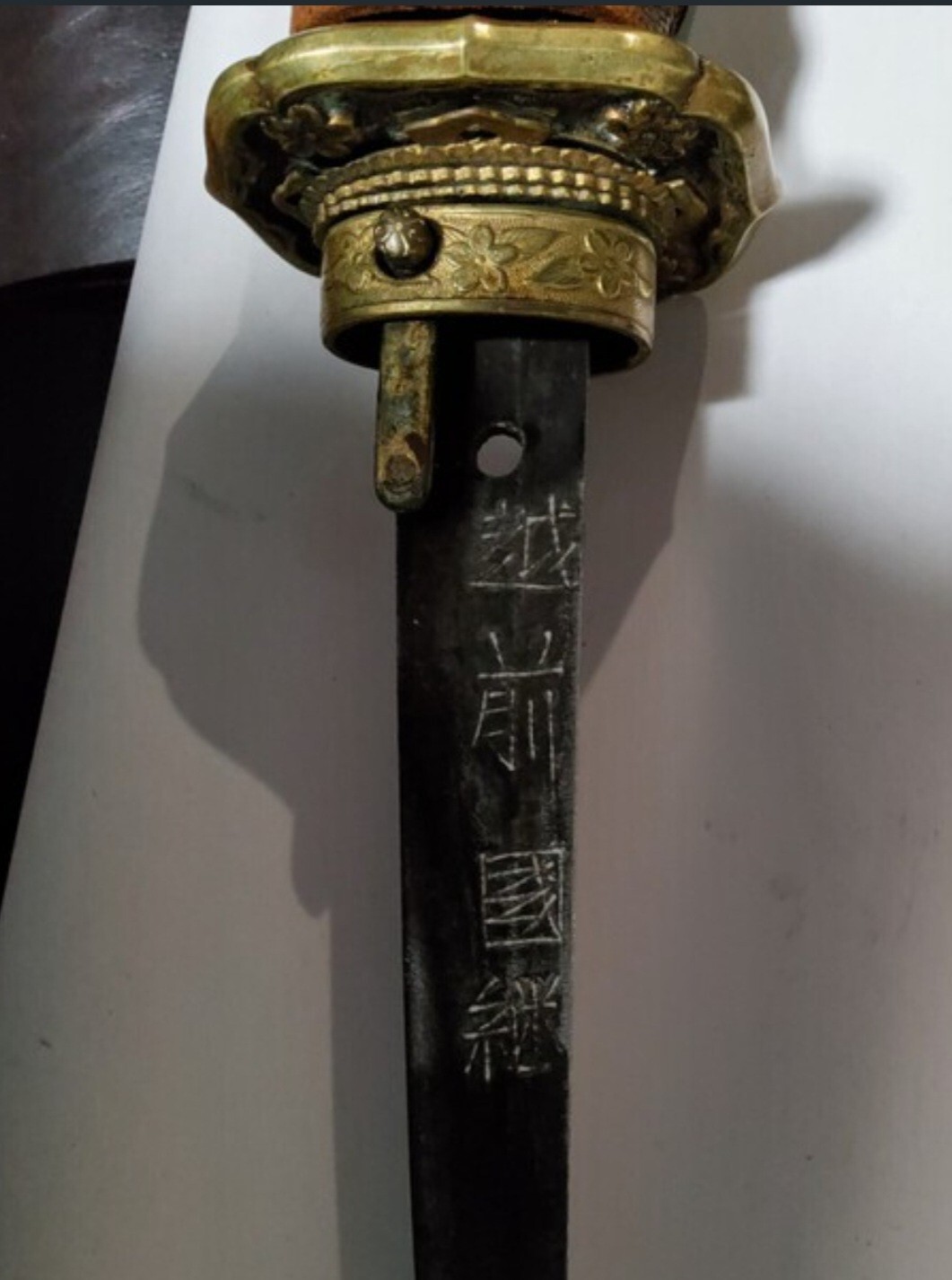

vajo Posted October 7, 2025 Report Posted October 7, 2025 Robin that gunto picture looks strange? Did you take it? It looks on the picture like that cigar 1 Quote
robinalexander Posted October 7, 2025 Report Posted October 7, 2025 Lol ...yes Chris I took it. Could be optical illusion ? For interest, it's 越前國継 - Echizen Kunitsugu 1 Quote

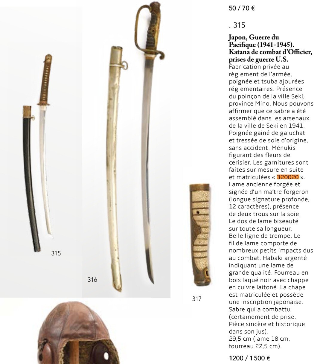

Kiipu Posted December 23, 2025 Report Posted December 23, 2025 Cross-Reference Sword Indentification 1 Quote
japanesewarriors Posted December 25, 2025 Report Posted December 25, 2025 I have one with out the wood saya, same numbers etc its a registered fitting for the Gunto, allows for securing catch etc. Quote
Rawa Posted March 30 Report Posted March 30 Fuller & Gregory page 66. It’s hard to remember all pictures. 1 Quote
