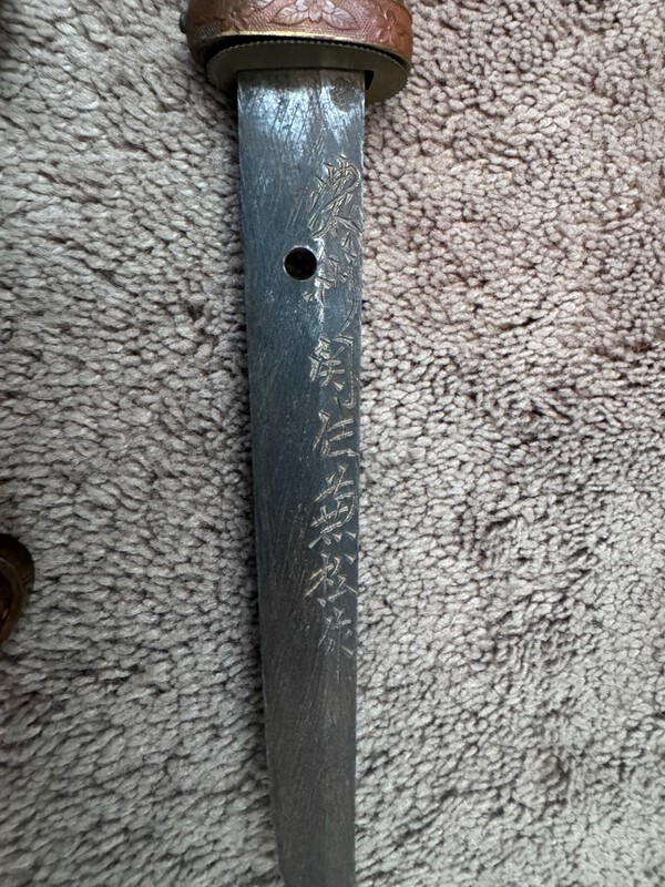

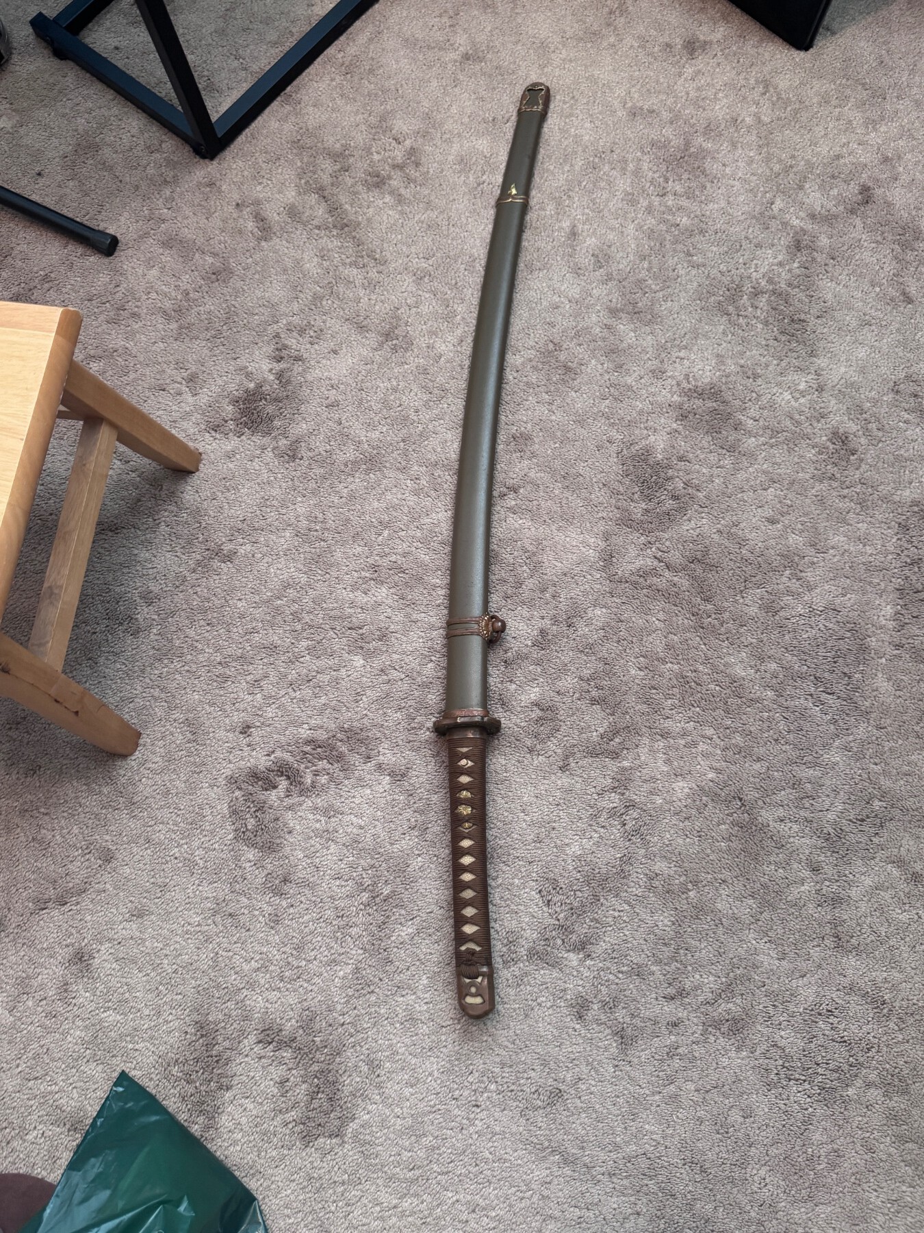

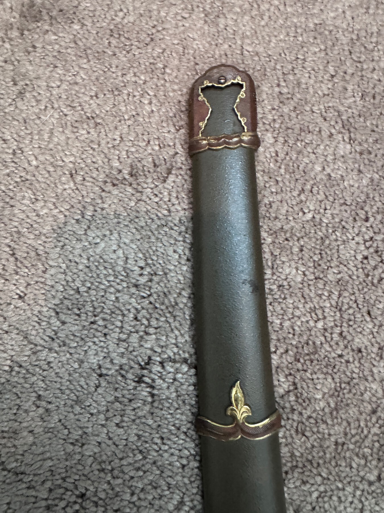

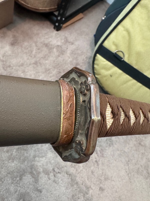

I’m hoping for some assistance with translating and identifying the mei on a katana in my possession. It was my father’s that I pulled out of his safe.
The blade is signed, and the mei appears to reference a Seki Kane-smith, but I would greatly appreciate confirmation, correction, or any additional insight.

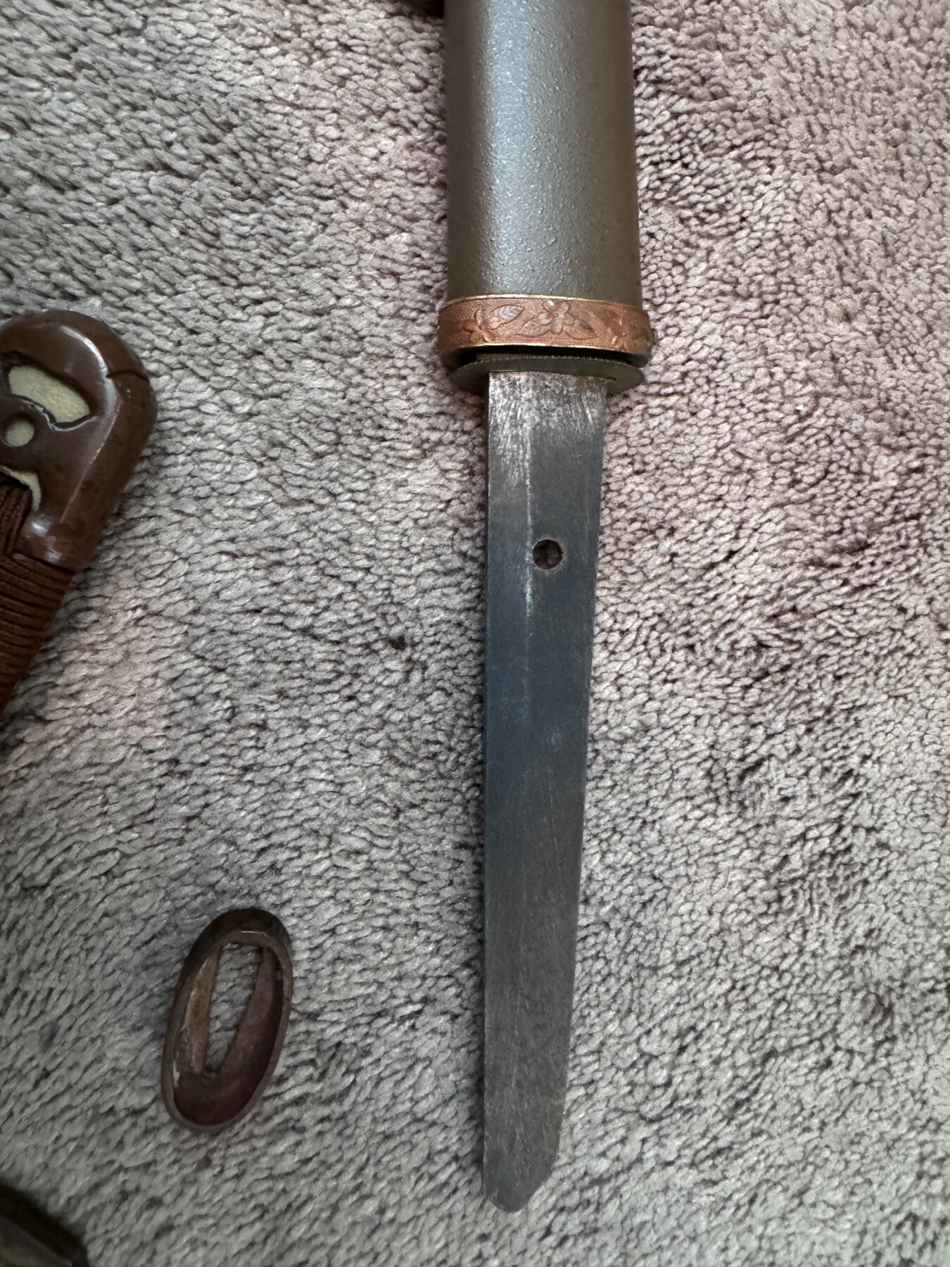

The tang has a dark, natural patina with one mekugi-ana. The blade is mounted in traditional koshirae. I do not have papers for this sword.
I have attached photos of the full blade, both sides of the nakago, close-ups of the mei, and the koshirae.
Any help with reading the mei, possible smith attribution, time period, or whether the signature may be gimei would be sincerely appreciated.
Thank you very much for your time and expertise.
Will:

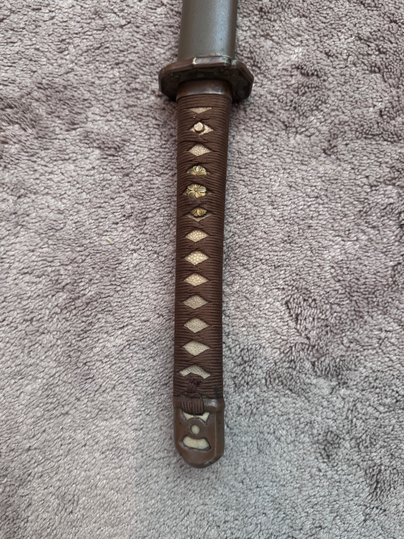

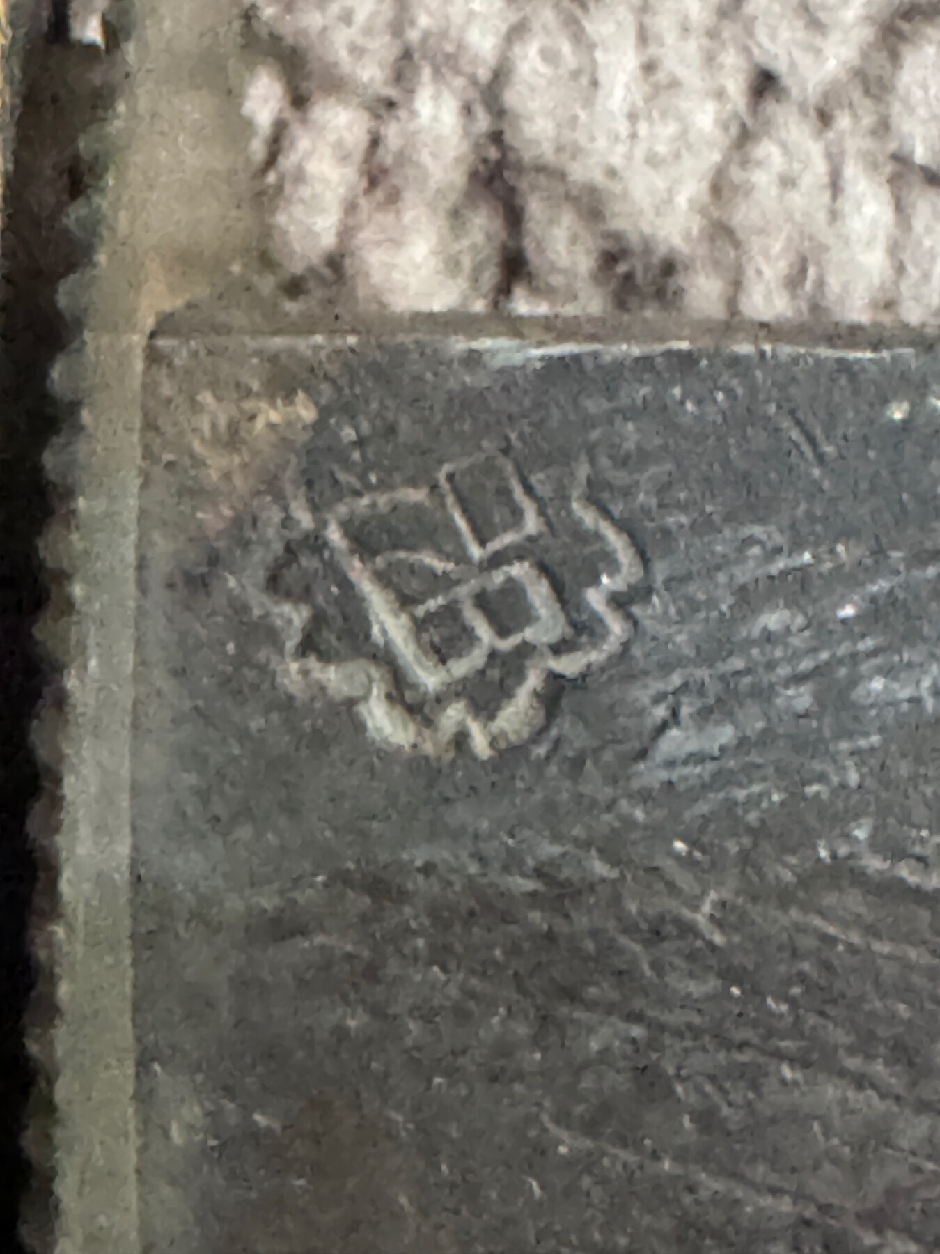

In addition to the translation, the Sho stamp indicates it is a non-traditionally made sword and was made during WW2. The mounts are referred to as type 98 and would have had a tassel originally (either blue and brown company grade or red and brown field grade).
John C.
Will, as Jan notes mei is Nōshū Seki-jū Kanematsu saku.  However, its a bit confusing as there is no  Kanematsu registered in WW2 Seki, but there are several with Kanematsu as given name.  Also some signed Kanematsu Kanetatsu.  It was earlier though it may be joint  work, but could be the one smith.  Not fully sure, but check out earlier posts.
I have a blade on file signed Kanematsu Kanetatsu, but none with just Kanematsu.  Could be one of those guys that changed their mei over time.

This is an interesting gunto, in that the tsuka (handle) might be a replacement.  There was no hole drilled through the eyelet in the kabutogane (end cap) and there is no chuso (locking latch).  It appears new and unused.  Also, the kabutogane has little of the fine detail normally seen, which is something we often see in late-war fittings.  In an article about the field repair teams, they stated that the majority of their work was due to broken tsuka, so I think this is possible in your case.  Unless, of course, the gunto was simply missing the tsuka in years gone by and someone along the way found one to put on this.
