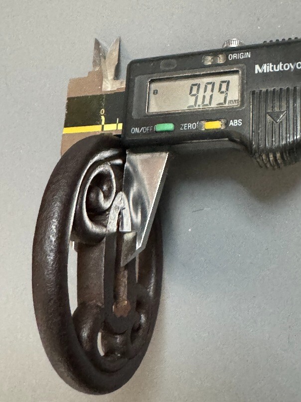

DKR Posted August 21 Report Posted August 21 This one is probably 3gen Akasaka . Seppa dai 9mm thick. Inside of the nakago ana you can see traces from the chisel. 4 1 1 Quote

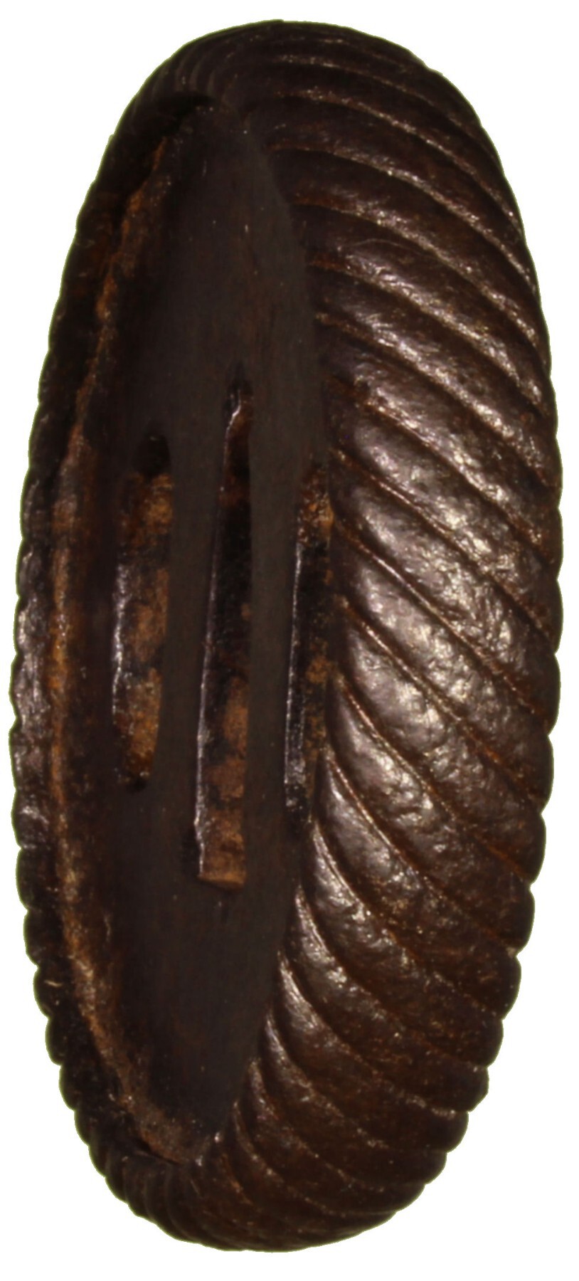

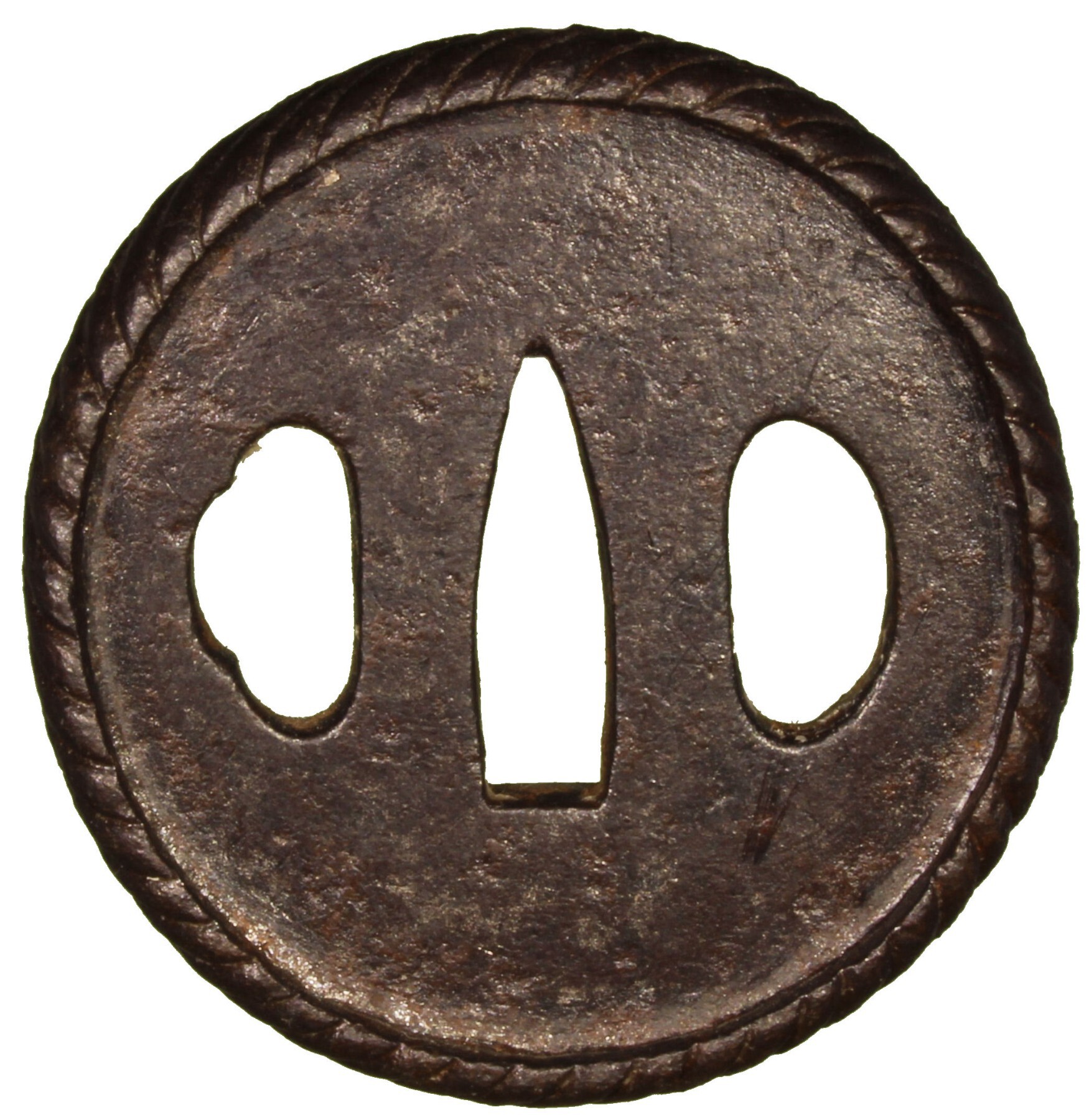

kissakai Posted August 22 Report Posted August 22 Thickest one I have 66 x 67 x 12.5mm. Why so thick? 3 Quote
