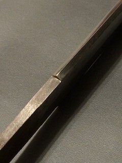

DocTheRoc Posted February 19, 2025 Author Report Posted February 19, 2025 Here’s an additional picture that hopefully shows the Shinogi-ji down the length of the Nakago. (I think?) Quote

ROKUJURO Posted February 19, 2025 Report Posted February 19, 2025 9 hours ago, DocTheRoc said: Here’s an additional picture that hopefully shows the Shinogi-ji down the length of the Nakago. (I think?) Thank you Vincent, that looks genuinely Japanese now, please excuse my wrong assumption. But as others wrote, the blade may be quite late. 1 Quote

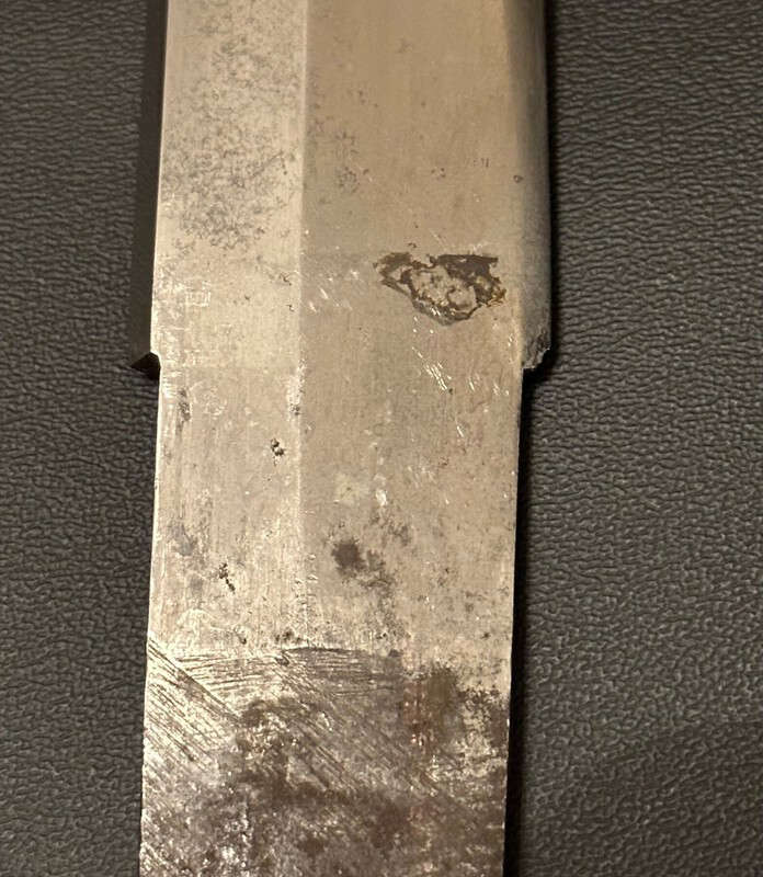

Tohagi Posted February 20, 2025 Report Posted February 20, 2025 Bonjour Vincent, I think the stamp place is uper just under the habaki, there is a like "rust hole"... I see a star when I close up. Honestly, my first blade was not as good as this one, so just feel happy with it. The blade seem tired but overall healthy. Kind regards, Eric Quote
ROKUJURO Posted February 20, 2025 Report Posted February 20, 2025 I don't see a star, but remains of a SHOWA stamp. Quote
Guest When Necessary Posted February 20, 2025 Report Posted February 20, 2025 12 minutes ago, ROKUJURO said: I don't see a star, but remains of a SHOWA stamp. Hi Jean! To be honest, I'm still not seeing a removed stamp. The mark you indicate is on the opposite side to the mei which would be unusual for a Showa stamp. Also, when they are removed it's pretty obvious - just take a look at this old thread I found (apparently this one even got papers): Gunto with NBTHK Hozon - Military Swords of Japan - Nihonto Message Board Quote
Brian Posted February 20, 2025 Report Posted February 20, 2025 This looks like a removed Seki stamp to me, and it's exactly where you would find a stamp. Quote
ROKUJURO Posted February 20, 2025 Report Posted February 20, 2025 17 minutes ago, KungFooey said: Hi Jean! To be honest, I'm still not seeing a removed stamp..... Deanna, you may be correct, it is not very clear. But on a TACHI MEI signed GUNTO, there could be a (SEKI - Brian is correct) stamp in this spot, and there are several - more or less competent - ways to try to erase it. So I should have correctly written "I believe I see". And then there are still my old eyes.... Quote
