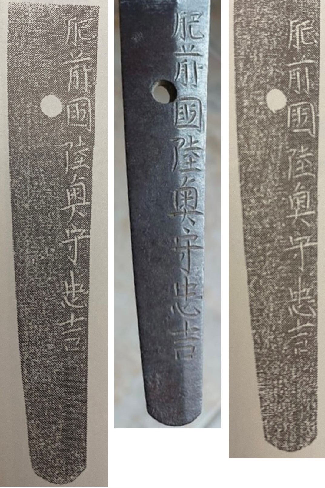

2devnul Posted June 2, 2023 Report Posted June 2, 2023 Hello everyone, I'm new on the forum so nice to meet everyone. I recently bought this wakizashi and would like to hear any comments about it from the experts. Nagasa = 45,5cm Motohaba = 30 mm Motokasane = 7,5 mm Please check the photos, thank you. Quote

Larason2 Posted June 3, 2023 Report Posted June 3, 2023 The signature looks like others from the same smith online, which suggests its not gimei (unless they're all gimei!) 1 Quote
paulb Posted June 3, 2023 Report Posted June 3, 2023 The shape and the hamon are not typical for the smith. The finish on the nakago and the way the mei is cut also look a-typical. My first reaction is that I doubt it is legitimate. Mutsu no kami spent most of his short life (died when he was 50) making daimei for his father who outlived him. His works are rare and much sought after therefore a target for gimei. For a more definitive answer the blade needs to be submitted to shinsa. 8 1 Quote

Ian B3HR2UH Posted June 5, 2023 Report Posted June 5, 2023 Hello Adam , I agree with all that Paul has said . To say that it looks like others by the same smith online is pretty unhelpful . You need to look at lots of genuine examples in books and to compare the way each character is cut on the genuine ones with the way that the same character is cut on yours .For example if you look at the Kami character on genuine ones the " box" part of the character on the real ones is generally much longer and narrower than the "box" part on yours . The absence of visible filemarks on your tang is also a worry . These mainline Tadayoshi nakago are always really well finished and you would expect to see yasurimei on the real thing . Ian Brooks 2 Quote

Jacques Posted June 6, 2023 Report Posted June 6, 2023 Gimei at 99%, from memory the bottom horizontal stroke of the kanji Kuni is engraved the wrong way (must be engraved from right to left) 1 Quote
2devnul Posted June 6, 2023 Author Report Posted June 6, 2023 46 minutes ago, Brian said: Most gimei were done waaay back, usually at the time of manufacture or not far from it. There are modern gimei, but I think the ones we see are proper antiques and it doesn't affect quality. Shinsa is the only way to really tell. IMHO it is still a nice blade, even if it isn't Tadayoshi's workshop. I hope it is antique blade. 7 minutes ago, Jacques D. said: Gimei at 99%, from memory the bottom horizontal stroke of the kanji Kuni is engraved the wrong way (must be engraved from right to left) Do you have by any chance a picture of mei that is confirmed/legit so I can compare it? Also, I would like to ask all of you about how much this sword can be worth? I'm not planning to sell at the moment, but just wonder if I didn't overpay. As most of you judge it's gimei, then let's focus on the price of a gimei (I'm losing hope that it is true Tadayoshi). How much it can be worth in current koshirae (Tsuba suppose to be from Edo period too, fuchi/kashira/menuki are modern Japanese manufacture). I will do my best to upload better hamon/hada pictures later today or tomorrow. Thank you again for all the help. Best regards! Quote

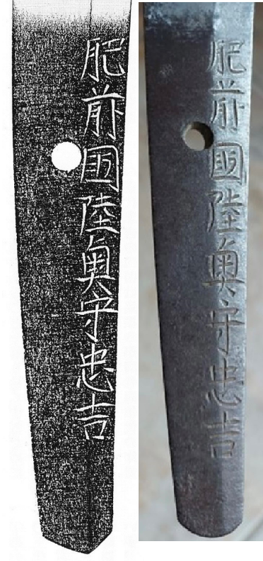

Mark S. Posted June 6, 2023 Report Posted June 6, 2023 Two mei’s to compare (on either side of mei in this thread). Both are from the: Hizento Handbook by Eguchi Soshin with translation by Gordon Robinson page 215 and attributed to the 3rd Gen Tadayoshi. No judgements… just for reference. 5 Quote
Mark S. Posted June 6, 2023 Report Posted June 6, 2023 And one from Markus Sesko’s Shinto-meikan, page 318. 3 Quote
Alex A Posted June 6, 2023 Report Posted June 6, 2023 The trouble with trying to identify blades by mei..................Its not like they are mass produced and punched on a machine. Looks close to me, not like one you normally see that looks like to be done by a blind man on a galloping horse. Always the possibility of Dai-mei. If it fails NBTHK, send it NTHK, you never know 1 Quote

Alex A Posted June 6, 2023 Report Posted June 6, 2023 Hi Adam, true. Though i mention due to Hizen school, just see it as a possible coincidence. Cheers. Ps, the one thing i notice most on yours compared to the examples put on by Mark and Jacques The lack of slant on the horizontal strokes. Though il be honest, stating its gimei is beyond me just by looking at a mei. I don't have NBTHK resources. As said, its not one of the obvious examples that you may come across. A short story. I once showed one of my Hizen blades to a well known expert and he remarked on the mei standing out as not being quite the norm. He was surprised to find out it was Papered by NBTHK. So i guess if folks with his kind of knowledge get the odd surprise, then that gives it some perspective. 1 Quote
Jacques Posted June 6, 2023 Report Posted June 6, 2023 50 minutes ago, Alex A said: The trouble with trying to identify blades by mei................ For someone with a good experience, it's easier to judge a mei based on a photo, as oshigatas aren't made for dogs. On the other hand, even for an expert, it's impossible to judge a nioiguchi based on photos showing only the hadori. The same applies to hada, of which only the most visible grains are visible. 2 Quote
