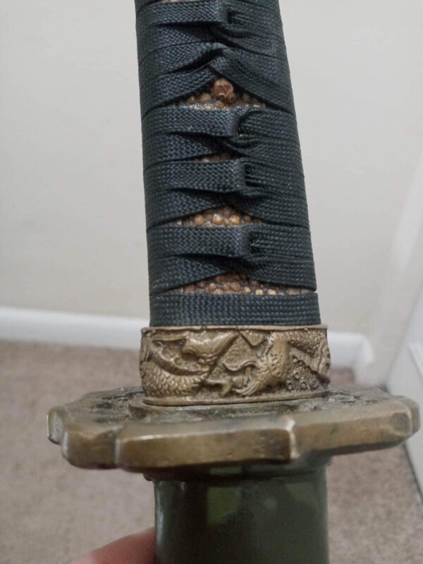

Lewis D Posted June 6, 2023 Report Posted June 6, 2023 Hi guys, sounds like I might have found the right forum. I’ve been interested in buying a military katana for some time and found this one online. Is there an expert that can confirm if this looks legit? Or a Chinese made fake? Quote
Brian Posted June 6, 2023 Author Report Posted June 6, 2023 a BAD Chinese copy. Not even close. Much more study needed. Quote
