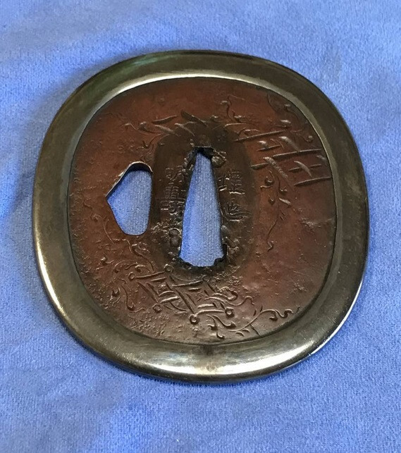

Curran Posted February 6, 2023 Report Posted February 6, 2023 Some nice comments so far. A recent example: https://page.auctions.yahoo.co.jp/jp/auction/m1080865027 Very important name and signature. The aesthetics of this particular tsuba don't do much for me, though some of his other works do. That signature is a big part of the context of the value. 1 1 Quote

Curran Posted February 7, 2023 Report Posted February 7, 2023 Umetada Myoju tsuba. 1.68 M yen An artist of significant skill, but also great cultural relevance and influence. To put it one way, he was a great experimenter with artwork at a pivotal time in Japanese history. Given that this one is only TH and 1.68M, imagine what price his many Juyo tsuba fetch. I wouldn't call this one a masterpiece, but that authentic signature is worth a large amount. Tea aesthetic, but not my cup of tea. It seems relative to this thread. If unsigned and mistaken for a ko-kinko, it would fetch significantly less. 1 Quote

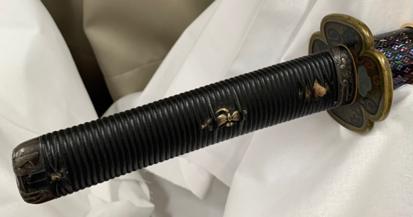

vajo Posted February 7, 2023 Report Posted February 7, 2023 Curran, Piers made some nice shots of Bizen Osafune Koshirae with a Tsuba that looks like the style of the Myoju Tsuba you post. 1 Quote

Soshin Posted February 8, 2023 Report Posted February 8, 2023 On 2/7/2023 at 6:51 AM, Curran said: Umetada Myoju tsuba. 1.68 M yen An artist of significant skill, but also great cultural relevance and influence. To put it one way, he was a great experimenter with artwork at a pivotal time in Japanese history. Given that this one is only TH and 1.68M, imagine what price his many Juyo tsuba fetch. I wouldn't call this one a masterpiece, but that authentic signature is worth a large amount. Tea aesthetic, but not my cup of tea. It seems relative to this thread. If unsigned and mistaken for a ko-kinko, it would fetch significantly less. Thanks for sharing, Curren such a wonderful and expensive tsuba. This tsuba is worth every yen. This is another great tsuba that is far beyond my means. I love the aesthetics of Umetada School. I have two Hozon level tsuba works by the school one is in forged iron (tetsu 鉄) and the other in copper-gold alloy (shakudō 赤銅). Quote
