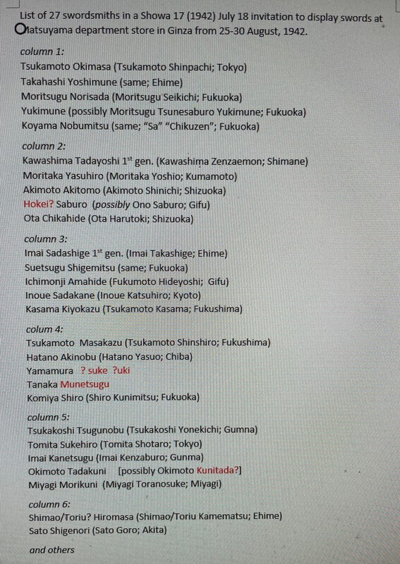

mecox Posted March 11, 2023 Author Report Posted March 11, 2023 I used the wrong link for item below......it should be Thomas' post: Mal, I thought you might enjoy reading this post by Nick Komiya. 1941 IJA Weapons Prices in today's values, Post #14 Source document can be found at the link below. 全国現代刀匠作刀日本刀展覧会開催の件 I found this mail from Thomas and the original from Nick Komiya very interesting, especially the list of 27 swordsmiths invited to display swords in July 1942. Seems to be a selection of better tosho of the time, so I tried to translate and identify. Got most of them but we got stuck of some. Any assistance / correction is most welcome. 3 Quote
