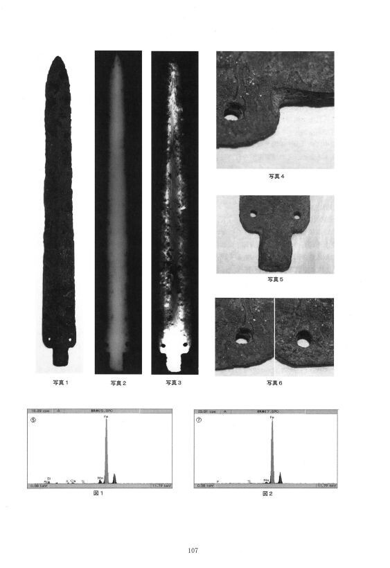

I found that the sword was excavated at Otake-nishi Renains in Yao city. The sword was found at the 3rd excavation (1996-1997) and documented in a report in 2008. It is the first sword which was recognized as a cast iron sword in the area.
Ref. 大竹西遺跡 - Comprehensive Database of Archaeological Site Reports Japan (nabunken.go.jp)
Also an archaeologist studying on iron cast in ancient Japan mentioned the sword in his paper (in Japanese).
Ref. KAKEN23520946_Nojima.pdf (hiroshima-u.ac.jp)
  • Like 8
Professor Nojima is quite specific that it is/was cast, and that it is unusual, thus worthy of the iron-casting background research which he undertakes in his paper, kindly linked by Moriyama San above.

You might note on the sword in question the two small holes at the base of the blade and the relatively short tang. Compare it to this example of a bronze weapon with the handle riveted onto the blade. [example on the right] Same technique just "new" material.

For example, Chinese claim of decarburization from cast iron being the dominant process is very complex and multi-faceted. The underlying economy would greatly benefit from reliance on excavated coal, which is what we see in late medieval/early modern age parts of Europe when its experimented with or adapted a similar method. Chinese historians do claim transition to excavated coal took places. Carbon dating such blades would be then rather difficult, and this method is relatively seldom used with satisfactory efficiency - for this and other reasons. When it works well, it gives you a reliable range of possible dates, when it does not, it does not.
Proving the "cast sword" is cast is a duty of article's author. I can't for the life of me be of much use here, besides stating my opinion regarding the past history of similar claims, for a number of technical reasons, and that the current claim seem to emanate from publications which are technical reports rather than proper journal articles. I personally don't see much evidence the opinions given were defended against a qualified and well, hostile (admitting that in Chinese literature "cast" is indeed one of the key terms), peer review process. The language in which the corrosion report is written, the phrasing chosen, they are unfortunately consistent with a report format, rather than a proper article. Which is what it is.
If its indeed cast, the proof provided would be an important milestone for understanding of the early (Chinese?) metallurgy.
12 hours ago, Dan tsuba said:
.....So, let’s say a sword was cast in iron.  Would it then be “hammered” to further flatten and shape it?  Would that be considered “cast iron” or “hand worked” or both?.....
Dan,
in the meantime, there has been written a lot about the properties of cast iron. I will repeat one of them for you: You cannot forge cast iron! Even if heated well, it will break like a cookie under the hammer. There is no shaping and flattening in the forge - I have tried it myself.
And to expand a bit on this: Cast iron (there are several types of it) in general has a very coarse inner structure (= "grain") compared to forged steel, that will not allow to grind a workpiece down to the desired shape.  To give you an idea, image a cake with whole hazelnuts. You cannot cut a fine slice off it without the hazelnuts breaking out. If you transfer this picture to cast iron, it can never achieve a satisfying (fine) cutting edge as the coarse inner structure does not allow it.
Just basics.
