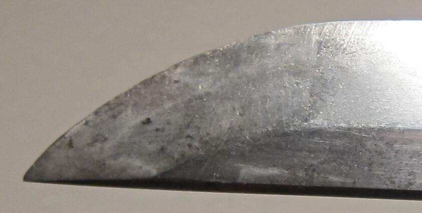

george trotter Posted January 25, 2022 Report Posted January 25, 2022 Hi all, I have a 1944 RJT blade by Nagao Kunishiro of Aomori Ken. He worked in Bizen style. I would like your learned comments on this boshi (sorry the polish is so dirty). I have previously considered this pattern but am uneasy about its correct name - can members help? I have now called it togari ko-maru (pointed small circle return)...is this accurate? Also, what to call the "abrupt" end to the return? Also - as you will notice, there is muneyaki a but further down - blade also has tobiyaki and hitatsura. regards, Quote

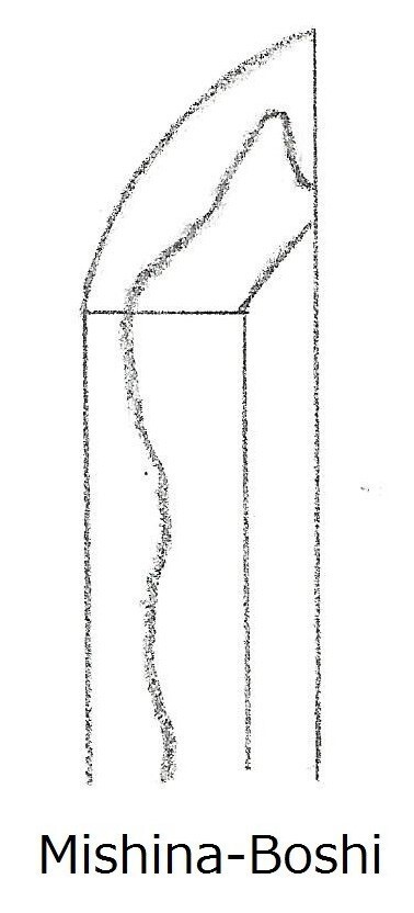

george trotter Posted January 25, 2022 Author Report Posted January 25, 2022 Hi Jimmy, thanks, Yes I have checked the Sesko site and observed both Mishina and Jizo boshi, but wonder if this one fits either one exactly? What would members name this? Sorry about the polish...sword was in a shed for decades and had been a bit mis-handled by kids...but still OK. I never got it repolished as I am not happy with modern polish...rather have a dirty original than a 'post war trend' polish...just doesn't fit IMHO. 1 Quote
george trotter Posted January 25, 2022 Author Report Posted January 25, 2022 I have had another look through the books and as you say Jimmy it looks like a Mishina version of a Jizo-boshi. I had considered this before and am happy to return to it now....but before I make a final decision, maybe the members could offer a comment or two? Regards, Quote

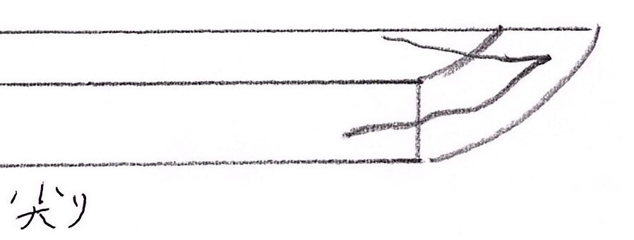

george trotter Posted January 25, 2022 Author Report Posted January 25, 2022 Thanks John...just to clarify, if I have got you right, you have classified this picture?...the photo above is not really notare....closer to this drawing of a non-notare togari example. In fact, mine is really this one but with the shorter, abruptly ending kaeri (except that mine is not this togari (pointed), but closer to a small headed Jizo)...see my problem? Quote

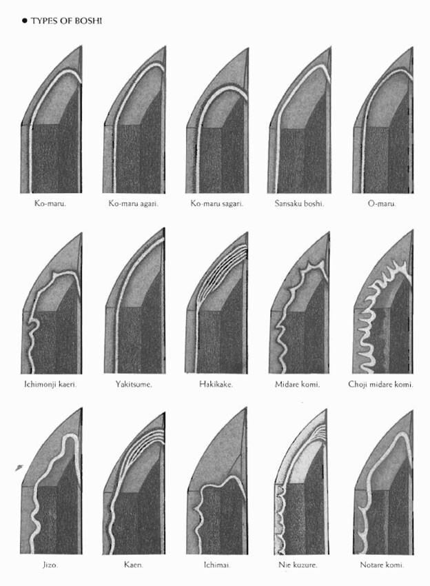

george trotter Posted January 25, 2022 Author Report Posted January 25, 2022 Thanks Brian, I am leaning much loser to classing it as a Mishina version of a Jizo-boshi....which is what a Mishina boshi is - just the Mishina school version of a Jizo. Although my guy is a Bizen oriented smith, there is no reason why he would always stick to the Bizen boshi - mostly versions of the sansaku boshi (your chart top row 4 from left). So, thanks again. Always happy to hear more opinion folks... Quote

george trotter Posted January 27, 2022 Author Report Posted January 27, 2022 Hmmm....not much happening here, so may I annoy you one more time? I think this might be the answer I'm looking for. Here is a boshi from Iimura's 'TOKEN YORAN. 1980 p.347. The description just says Kaeri Katashi (return tight)? Can this be called ko-maru kaeri katashi (small circle with tight return ? (blunt/short return?). Any comments? Thanks Okay - several hours have passed - I think I have it (slow I know - duuh!). Anyway, simplest classification is from Nakahara 'Japanese Swords' p.160 fig 238 Ko-Maru, Kaeri-Yoru = small circle, kaeri ends abruptly (rather squarely) see new sketch. This fits Mishina and others discussed. I think I'll stick with this...I'll leave now. 2 1 Quote
Bugyotsuji Posted January 27, 2022 Report Posted January 27, 2022 Have enjoyed following your thought processes, George. It is important to remember too that Japanese texts will often avoid absolutes, and if a definition box does not fit precisely, add softening or escape words like 'a touch/suggestion of, somewhat/rather/...x,y,z-like', etc. 尖り心 togari-gokoro, for example. Quote
george trotter Posted January 27, 2022 Author Report Posted January 27, 2022 Thanks Piers, yes, an interesting little journey...a bit unusual for me to 'open it up' for NMB discussion, but I thought it would be of interest to members and I was interested to hear members' opinions. And yes, regarding the Japanese text avoidance of absolute statements, I did this little exercise with that in mind... I think I am happy at last with this classification 'ko-maru kaeri-yoru' as it is factual, but still leaves room for discussion of 'ko' and/or 'togari' and Mishina, midare etc..on other boshi compared with this one. So fun for me (sorry to bore other members)...and yes, I know some must be thinking the blade deserves a polish, but you know my paranoia about modern polish. Oh and speaking of modern polish, I have seen references to boshi with togari-gokoro but the kesho polish makesit hard to see. The several I saw were all different, but all termed as 'becoming togari-gokoro...maybe a pic/drawing or 2 Piers? (just to help us learn). Thanks again to all who commented. 3 Quote

Brian Posted January 30, 2022 Report Posted January 30, 2022 Not sure everything fits into neat little boxes, or if there are names for every random feature. I think sometimes you just have to squeeze it into one of the generic terms in the pic above. Quote
george trotter Posted January 30, 2022 Author Report Posted January 30, 2022 Thanks Brian, Yes, I think you are right. You and Piers have both pointed towards remembering that Japanese texts often differ from each other. I think it is pretty obvious that the membership also is reluctant to make any BOLD statement on it as any firm declaration is almost certain to be contradicted in existing or future publications....wise choice. Probably wise for me to be wise too. I think then, after more searching and thinking, I will keep it simple and class my boshi as: Ko-Maru with short, sturdy Kaeri-yoru. I think that covers it.... Thanks, I'll let it rest now... Quote

ROKUJURO Posted January 30, 2022 Report Posted January 30, 2022 George, a firm classification would of course be much easier if the blade was in good polish. As it is now, there could remain a little doubt, whatever term you use. And if I may ask: Looking at your last photo, is there MUNE-YAKI going some way down? May be an effect of the condition of the blade or the photo? Quote
Jean Posted January 30, 2022 Report Posted January 30, 2022 Taking into account the size of the kissaki, the question should be: can a togishi polish only the kissaki (and not the boshi). The answer is yes of course. Quote
george trotter Posted January 31, 2022 Author Report Posted January 31, 2022 Thank you guys....interesting comments. First Will...yes I think George Boshi is OK, after all there was a guy down your way who collected Bushes, and they made him President of the USA...ha ha. And Dan...I understand what you ask, but even without a 'window' I can see enough of it to assess it (as I have)...only the 'varying' vocab of 'correct terms' is the hangup. And Jean, yes, it would be great if it was in clean WWII polish, but sadly, it is dirty (sigh). And yes, definitely a patch of muneyaki there behind the end of the kaeri. The very active blade has tobiyaki and hitatsura, also. So guys, good stuff, I appreciate your comments. Regards, P.S. On re-polish. I think maybe one influence on my 'attitude' to re-polish is that post-war hadori is sooo 'out of place' with the characteristics of WWII polish. I think my distaste for 'out of place' polish etc is partly due to the fact I collect WWII RJT gunto - to me they are high class weapons of war (the last sword actually made for war), so they, and their polish is history (You can see I was 30 years at local State Museum here) so I prefer a 90% perfect WWII polish over a 100% perfect hadori...To me, hadori is like putting a solar panel on a 70 year old Sherman tank. Hope this all makes sense (I'm not crazy). I collect the beauty/quality of WWII era gendaito, and that includes keeping it in original polish if possible...if in dire need of a repolish, I would stick with sashikomi. (note: this is not to say other views on hadori are wrong, just what I think...I can certainly tolerate different views ...as my mother would say "I'm sooo tolerant, I ache". One last PS...feel free to say what you think the little 'kinked/crooked circle' feature in the ko-maru is called (several of my books show it, but do not name it). Regards, Quote
