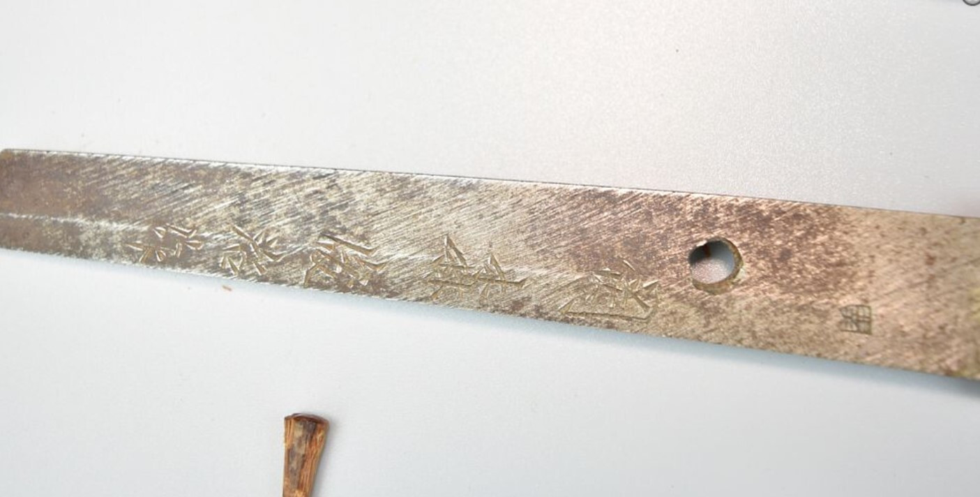

Top one looks like
関森俊治作 Seki Mori Toshiharu saku
(Toshiharu Mori, from the town of Seki, made this)
Bottom one is the hot-stamp of 関 (Seki). WW2 sword.
Thank you, sir. I suppose it’s still a piece of history, though not as old as what they claimed. It’s honestly a little embarrassing. I probably shouldn’t bid on lots I don’t know enough about to spot a false or misleading description…I’ll do my homework next time.

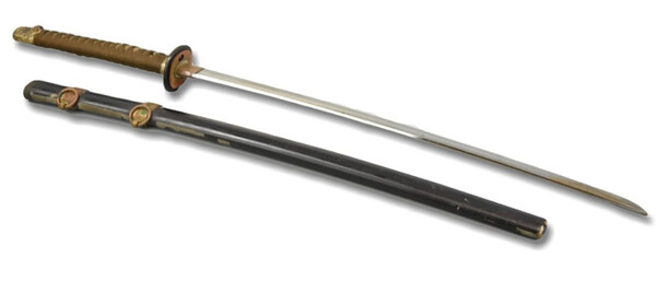

I’m afraid you’re right about their rider. I am going to call them tomorrow. I’m not necessarily after a 17th century sword, I’m just a casual collector. That being said, this experience does make me want to learn more about Nihonto and possibly becoming a more educated collector. It does make me wonder, however, how they could have been 300 years off. Seems fairly blatant. I will be interested to hear why they listed it as 17th century…
Big reason: profit. They (the auction co. or the original owner) figured more money could be had for an older blade over a WWII blade. It only takes a cursory search on their part to verify this blade is WWII.
Of course, their defense will be "We only say what we were told.. etc etc." So you could argue that they're being lazy too! But that's most auction companies these days. Preying on misinformation is very typical.
I think Brian says it best in the what to do when buying a sword or something links. You're 1st 3 or 4 swords should be books.  I did not follow that philosophy and wasted thousands of dollars.

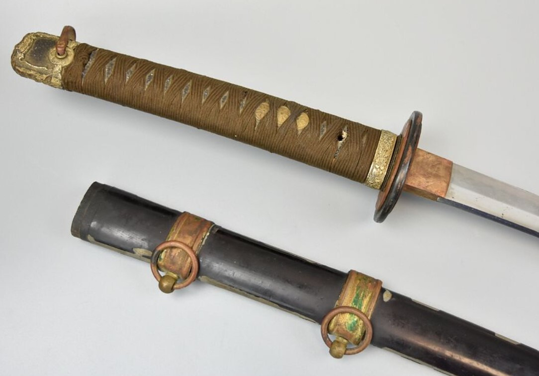

Although undated, the large Seki stamp puts the most likely date as 1942 as the massive majority of dated blades with this stamp are '42s.  But he stamp is seen less frequently from 1940-1944.  The fittings are made to have the leather cover over the wooden saya.  These are quite often found on late war kaigunto, so this could point to a '43-'44 date.
