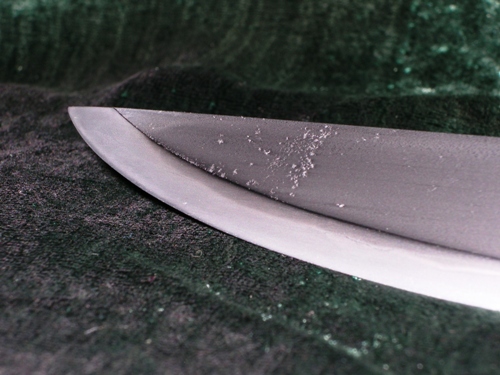

I inherited this blade recently and am wondering if the Kissaki is restorable?

Is that kiri-ha on one side and shinogi zukuri on the other? :shock:
You realise that if so, you have something quite unusual there?
It's bad damage, especially at that angle. On the kiri-ha side the bevel would have to be extensively reshaped. Can't see the boshi on that side, but on the other, if I am seeing it where it is, then yes, possibly. These opinions are always depenant on a professional togishi examining it in hand, but from the look of it, then it might be.
This one, even more than usual, requires a good polisher though. I would send it to Bob Benson in Hawaii and ask for his opinion.

Is that katakiri-ha on one side and shinogi zukuri on the other?

An example (if it is indeed like this) http://www.ksky.ne.jp/~sumie99/Uda.html
Most I have seen have hirazukuri on the other side, but of course there are examples with both.
Yes, it is indeed like this, but reversed. Would this mean that it was made for a left-handed person?

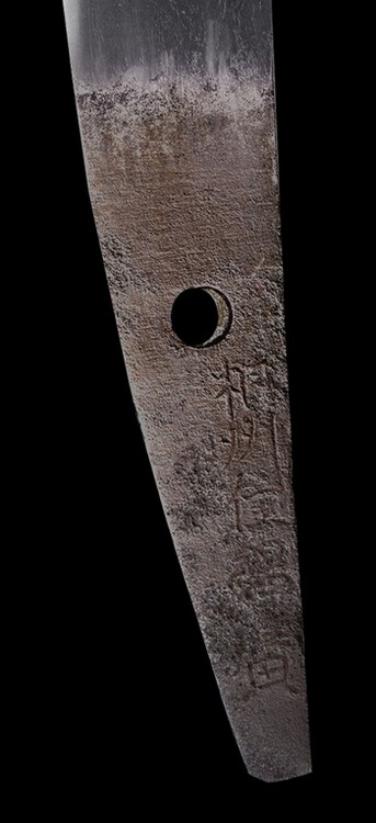

Hello again all, having difficulties in finding out much about the mei & nengo, so I'm throwing it open to yourselves for any help and discussion that may throw some light:-
Mei: "Soshu Ju Tsunahiro"
3171527135_2a9e3efe92.jpg?v=0
Nengo: "Tem-Bun Hachi-Nen Ni-Gatsu Hi"
3171393815_4bdb82b0f7.jpg?v=0
What do you guys think? I've not managed to see any hi-res images of 1st (or 2nd) gen Tsunahiro mei to make a comparison with. Although it does look similar to this example in the V&A museum which was signed as 1st gen, but attributed to 3rd gen. Why would he do this???
Regards,
Dick Tait
