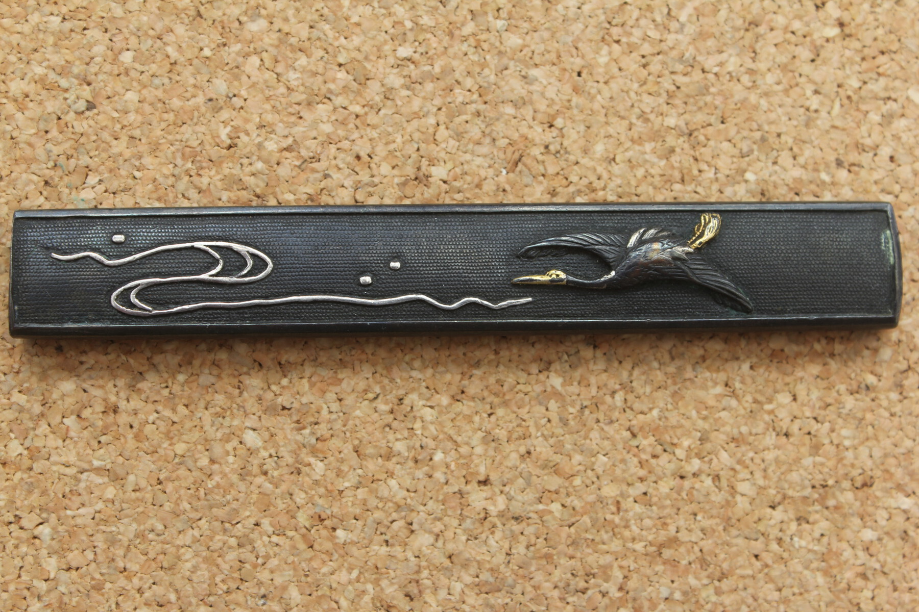

Item No. 54 - Three Kozuka in shakudo / shibuichi with gold & silver highlights
54A - crane flying over water - signed
54B - Shishi
54C - Gathering crops
Acquired as part of a larger lot from a European auction about 4 years ago.
Interesting to compare the qualities of nanako on display here

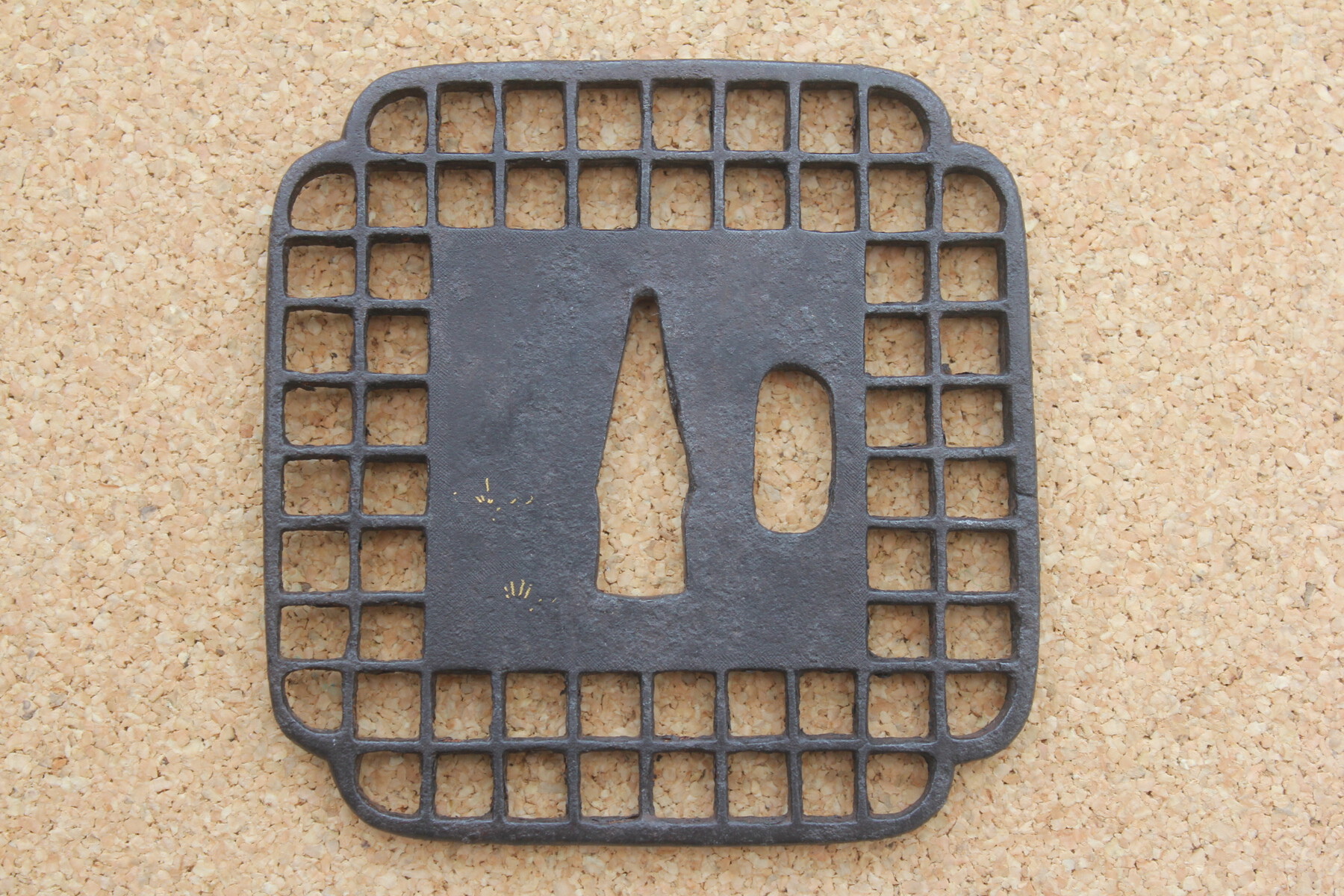

Item No. 55 - Iron Tsuba with remnants of gold highlights -  7.93 cn x 7.74 cm x 0.39 cm
For lovers of Old Iron -described as Ko Shoami from Muromachi Period (1393 - 1575 ) - The surface showing very fine tekotsu and a lot of nie.
I believe these are referred to as drain cover tsuba ?
Acquired about 12 years ago from a U.S. dealer.

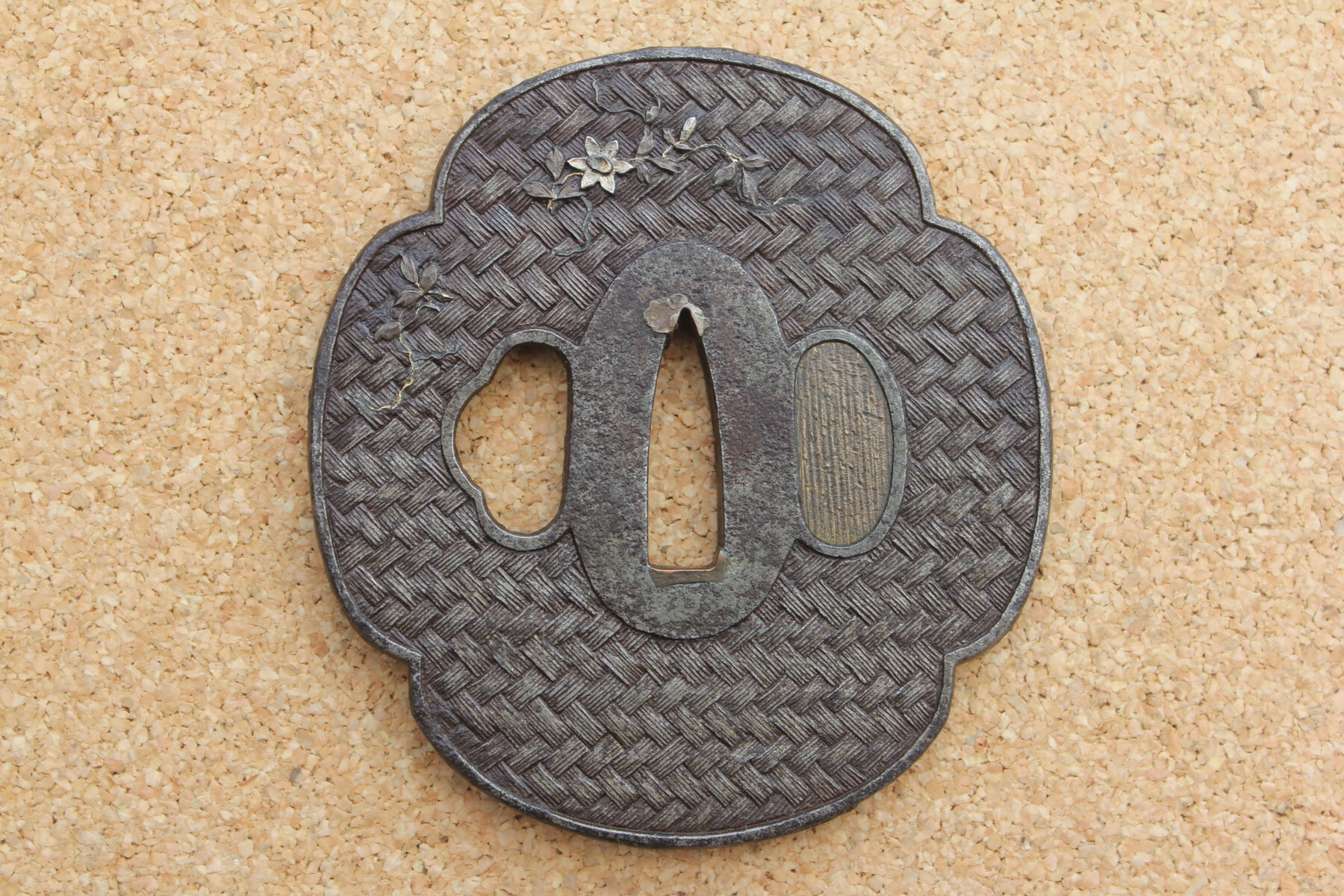

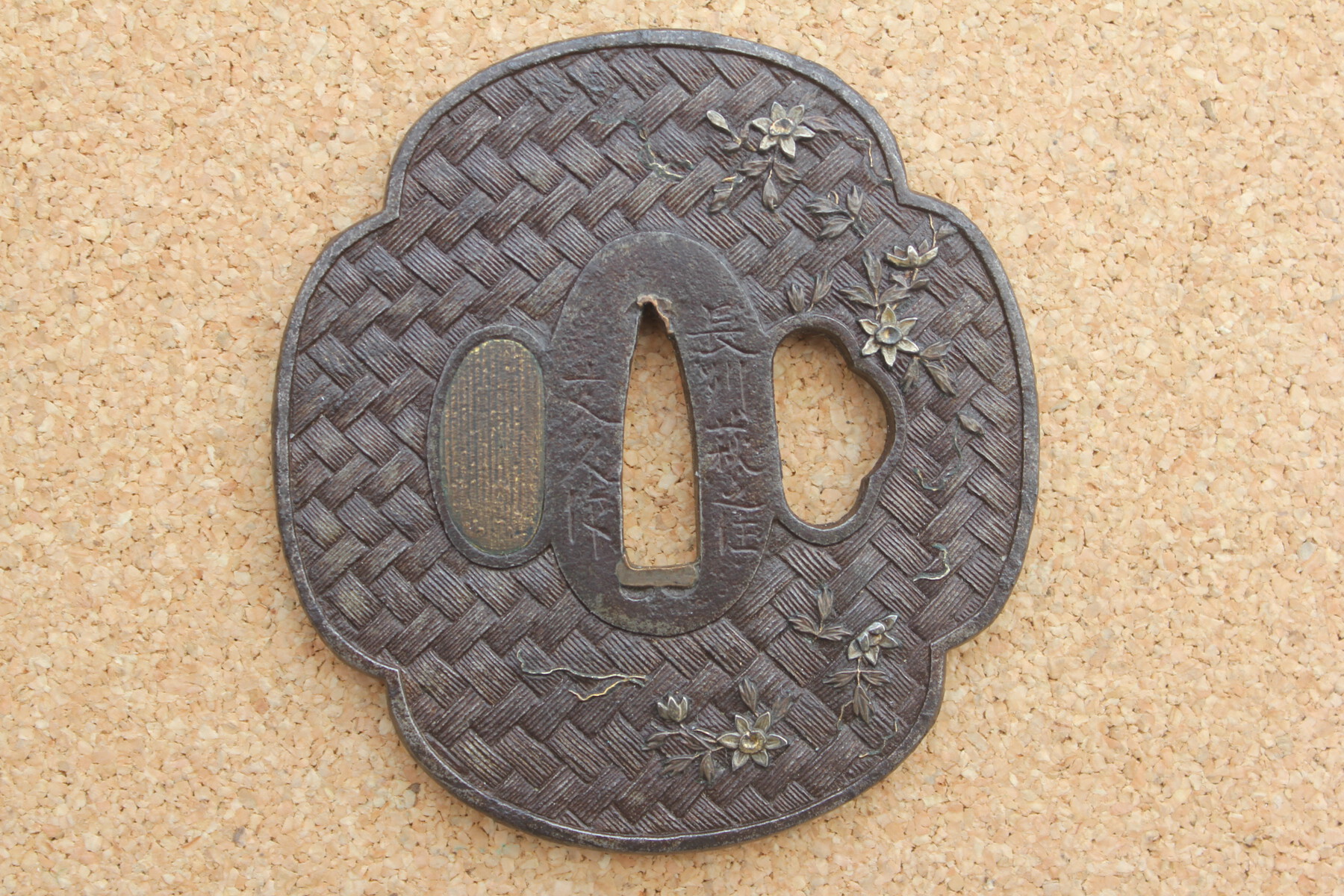

Item No. 56 - Iron Tsuba  Mokko Gata with silver and shibuichi detailing  7.5 cm x 7.3 cm x 0.48 cm
Subject of Basket weave design with flowers.
Signed  Choshu Noju Tomohisa Saku? which would date it to around early 18th century.
A nicely made quiet and understated piece .

Wow. That is a FINE example. Used to seeing that basketweave pattern. But don't see them with that level of detail to each "weave"
I'm impressed at how organic that looks. Lovely!
The basketweave in iron is difficult. If you live in a humid environment like Florida or Hawaii, it seems determined want to rust.
Attached should be one I sold like 15 years ago.
I was a bit surprised with the way the NBTHK papered it.
I've seen several types of attributions for these basket weave and clematis themed tsuba.
This is the one I got on mine. With the cloissone, I expected something else. It was confusing to me as a younger collector.
Basically- with the basket weave ones it seems they just toss it into whichever category most fits a particular tsuba. No particular school associated with the lobed basketweave design.  The concentration seems to be largely in Choshu, Bushu, and various Shoami schools.

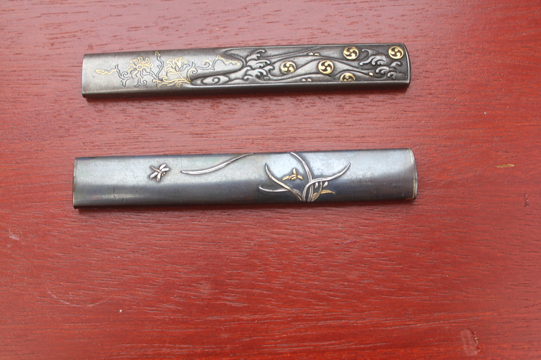

Item No. 58  - Kozuka in Shibuichi with gold inlays
Item No. 59  - Kozuka in dark Shibuichi with gold and silver inlays
Subject ( 58 ) Mons inlaid over turbulent water with plant detailing - unsigned
Subject ( 59 ) Iris and dragonfly - unsigned
Both pieces quite nicely made  - a bit above the average  , I think.
Bought as part of a larger lot about 4 years ago.
Comments , anyone ?
