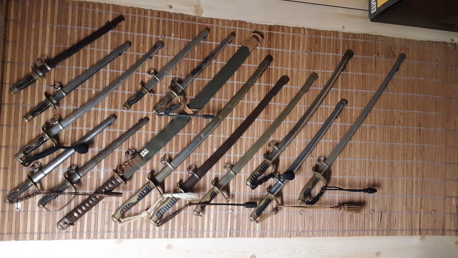

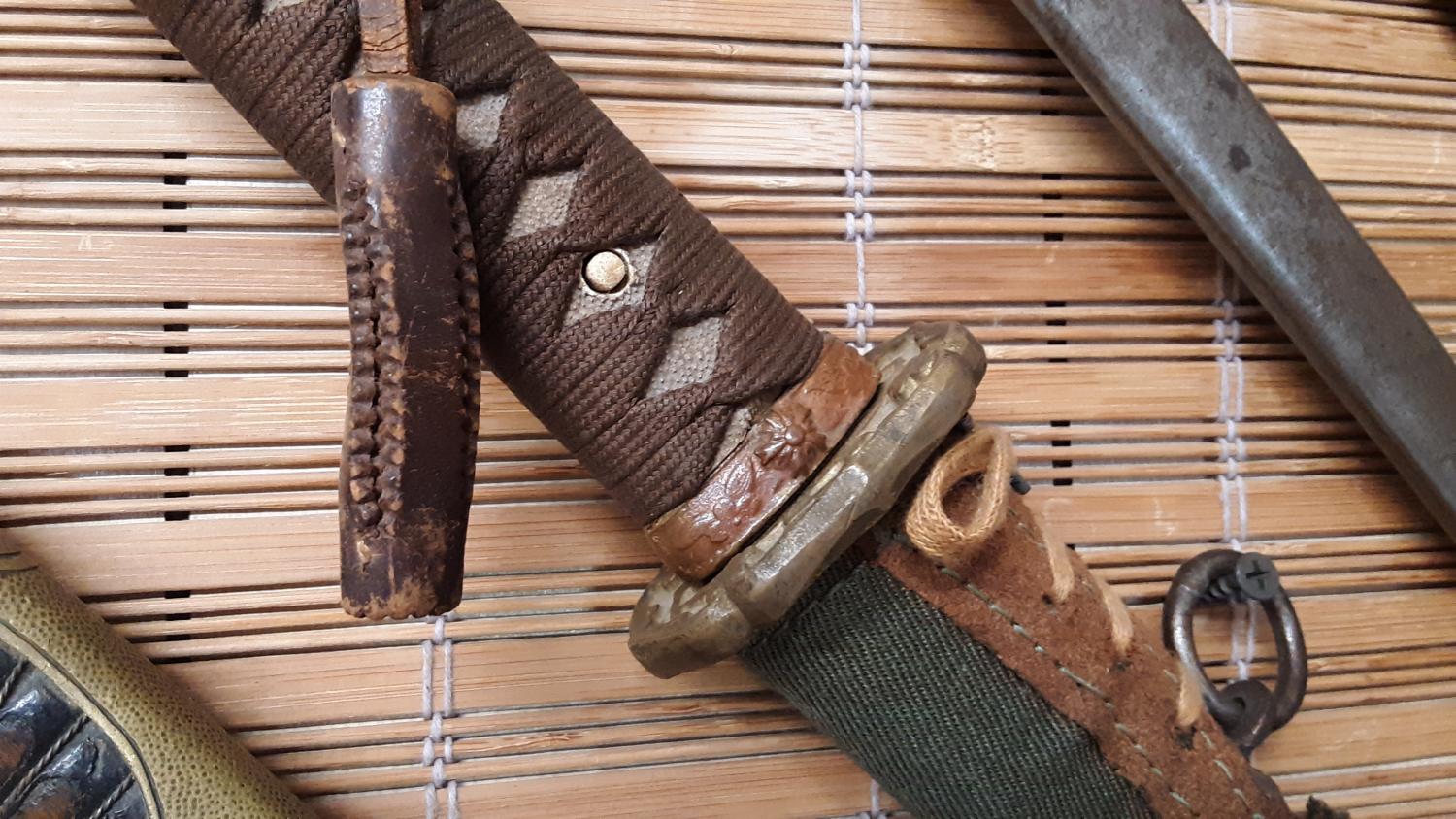

Thought this was interesting. "Trenchwarfare" at Gunboards posted a set of police swords, and right in the middle is a large, Type 98 styled sword with a police badge on the fuchi.
Dawason covers this model on page 321, and says the style seems to be a very late war model, as the detail-work on the metal fittings is poor and the saya is a very coursely made wood painted black. The blade in the Dawson example is made in 1945. Trench's is mumei. The canvas says cover was added by the current owner.

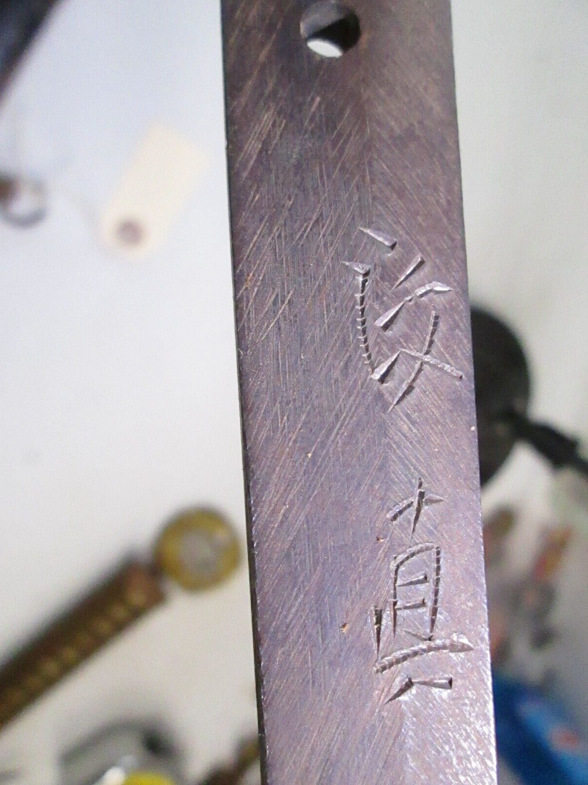

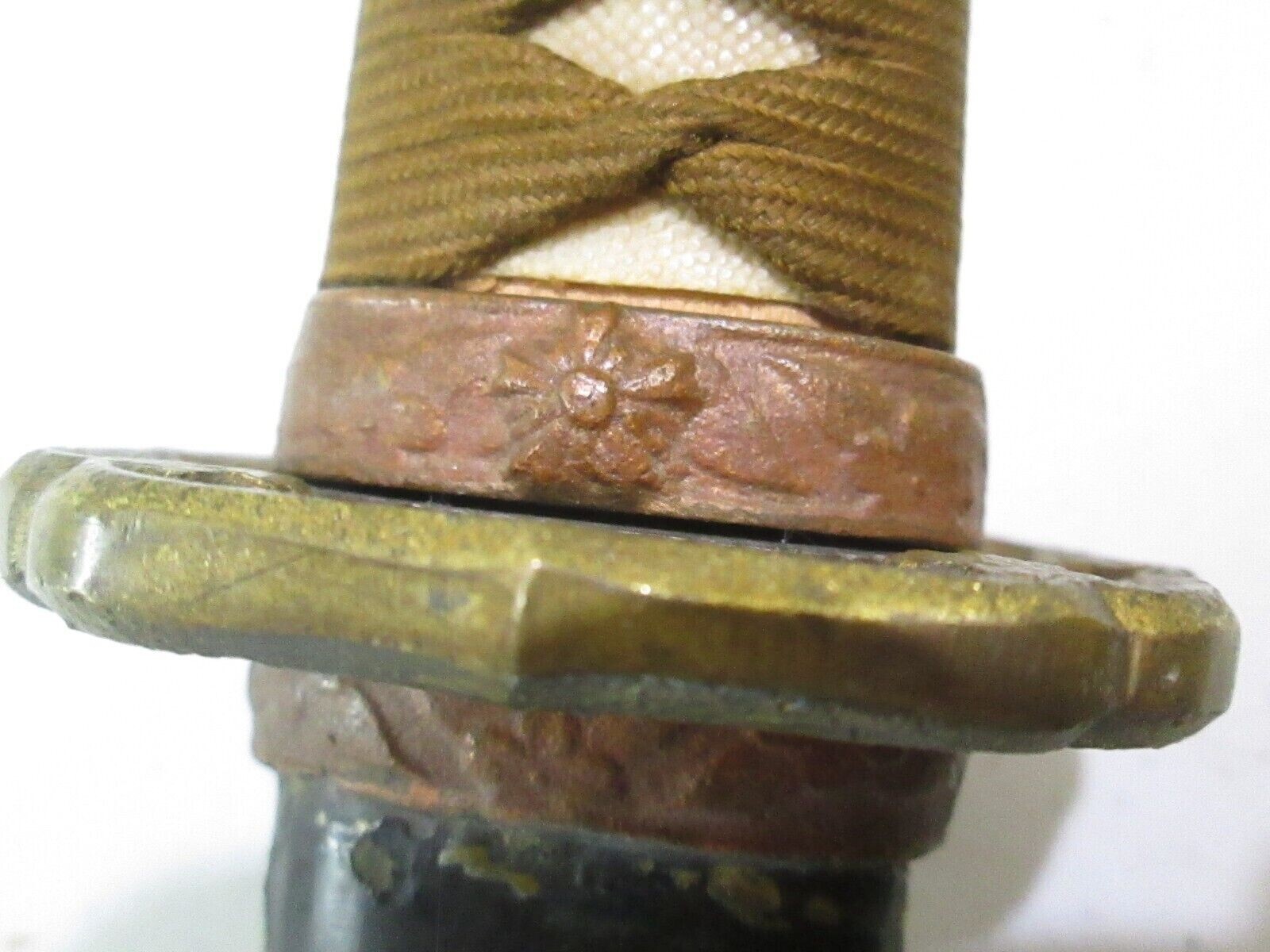

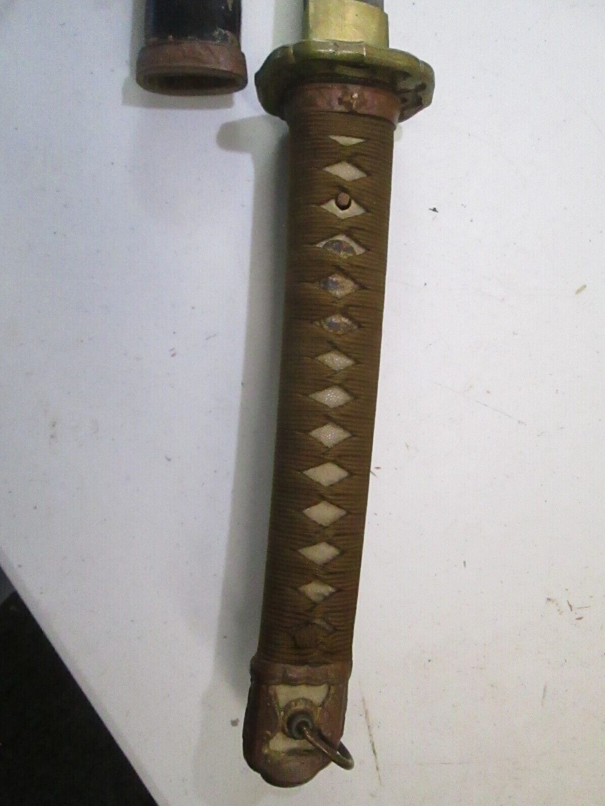

Found another being sold by Showa22 on fleabay:
s-l1600(1).thumb.jpg.8d1a2c4bdee2cd4a608c233dde1da9cc.jpgs-l1600(2).thumb.jpg.0d828eb96ab54c3d5704ffc837d7fb12.jpgs-l1600.thumb.jpg.28f0ea76c08f03f0375b8f43871597af.jpg
s-l1600(1).thumb.png.5152b597395754c5c1ee5c9739c136ae.pngs-l1600.thumb.png.0342a5cf6421f5ea3289fc93397e9b66.png
He says it's signed "Masazane".  Sesko lists smiths using "政" for Masa, but "zane" in all the names I can find are "真".  The don't have that added vertical line on the left side.  What do you think @SteveM @Kiipu @BANGBANGSAN?

i'm not sure it's the same guy tho
Oops, forgot to check Slough.  Good link, thanks Manuel.  Looks like the same guy to me.
38 minutes ago, SteveM said:
真 is a valid variant of 真. So 政真 is fine for Masazane. But... I can't find this smith when I do a quick search online.
Thanks Steve!  Those variants always trip me up.
