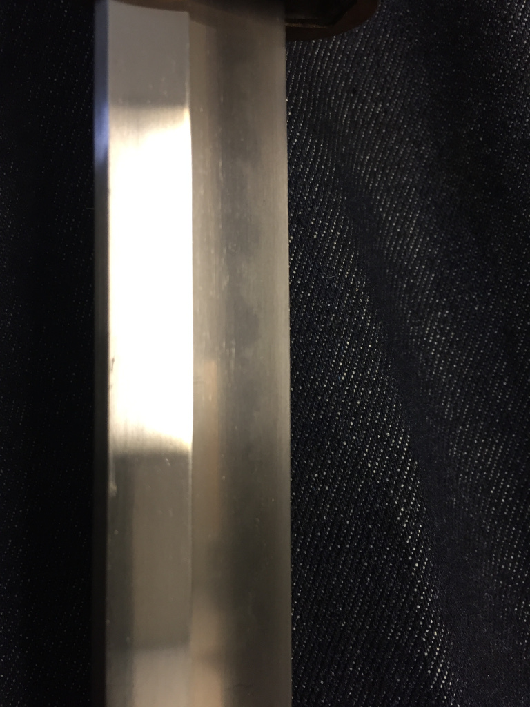

tbonesullivan Posted December 16, 2019 Report Posted December 16, 2019 I've got a mid 17th Century Shinto Blade in a Gunto setting, probably put back into service for the war and cleanedup. It has a polish from the Showa that doesn't bring out the hamon or other blade characteristics at all. You can barely see it in the right light. Makes me wonder if it would be worth it to send it out for a real polish. Quote
djcollection Posted December 16, 2019 Author Report Posted December 16, 2019 I've got a mid 17th Century Shinto Blade in a Gunto setting, probably put back into service for the war and cleanedup. It has a polish from the Showa that doesn't bring out the hamon or other blade characteristics at all. You can barely see it in the right light. Makes me wonder if it would be worth it to send it out for a real polish. If it’s a Shinto blade, I reckon you should get it a proper polish. I was just reading a book on modern Japanese swords, and it mentioned about women polisher during the war period. A Shinto deserves better. Quote
16k Posted December 16, 2019 Report Posted December 16, 2019 If it’s a Shinto blade, I reckon you should get it a proper polish. I was just reading a book on modern Japanese swords, and it mentioned about women polisher during the war period. A Shinto deserves better. No necessarily. If the blade is in great shape, worthy of being at least Hozon, by a well known smith, not suriage, then, yes, maybe. Otherwise, you may end up spending more than the purchase value. Age doesn’t necessarily dictates quality. 1 Quote
djcollection Posted December 16, 2019 Author Report Posted December 16, 2019 No necessarily. If the blade is in great shape, worthy of being at least Hozon, by a well known smith, not suriage, then, yes, maybe. Otherwise, you may end up spending more than the purchase value. Age doesn’t necessarily dictates quality. Thanks for point it out JP, you are right; it all depends. Quote
Bruce Pennington Posted December 16, 2019 Report Posted December 16, 2019 "Worth polishing" is something that depends on you. If you're planning to sell, then, yes the cost may put your expenses higher than market value. If you're keeping it, then the decision is really based on your taste. Some folks love the aged look while others want to bring out the full beauty of the blade. Just depends. 1 Quote
