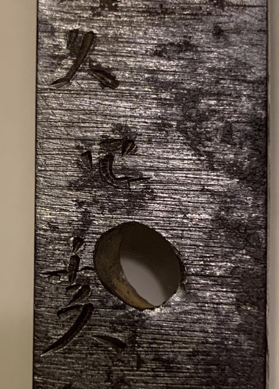

Hate to throw myself upon your generosity, but can anyone figure out the date here?
The registration paper says 文久口亥八月
The Kantei says 文久己亥八月 but this does not correspond with any of the three years of Bunkyu...?
What are we really seeing?
What might fit is: 文久亥八月......?!
Admittedly hard to imagine that the character in question is indeed Mizunoto  :doubt:
I agree with the above. 囗 (unreadable) feels like the best choice, so the tokorosho feels more accurate than the kantei sho.
I don't see how it could be 己.
It should be 癸 as everyone mentions, but... somehow, its very far from 癸.
It kind of looks like 以 or 北 or... 地 (none of which make sense)
I might find some hints, but I still cannot see the whole picture.
This 2019 is the year of 己亥 (Tsuchinoto-I) in the sexagenary cycle. I found that the year is also 地亥 (Earth-Boar) in Tibetan calendar.
Ref. https://www.mmba.jp/archives/24682
Ref. https://en.wikipedia.org/wiki/Tibetan_calendar
So, it is probable that the chiseled year on the tang is 地亥.
However, a question remains. (Mizunoto) does not seem to correspond to (Earth).
I already thought so, but then forgot to dig after.... :doh:
Here some other (alternative) writings: 参 = 3 (弎, 叁, 叄, ???? ).....not really a match, I think!
Hi,
Japan isn't Tibet- Buddhism country.
The date says 文久四亥八月 (Bunkyu 4th year,8th month).(1864).
But,Bunkyu 4 was until the 2nd month.
Did this sword smith forget that a name of the year changed?
Followed by “元治” with “甲子”......so he simply made a mistake?....  :o
No reliance on the old sword makers...... :laughing:

This morning I was discussing this with someone knowledgeable who said it was quite common for smiths to cut the outline of their Mei in advance and choose either 二月or 八月, even though it might have been a year earlier. He said he has seen many examples of this phenomenon.
Many thanks, Morita San. Always something more to learn, but an enjoyable process.
But still the Eto is wrong...

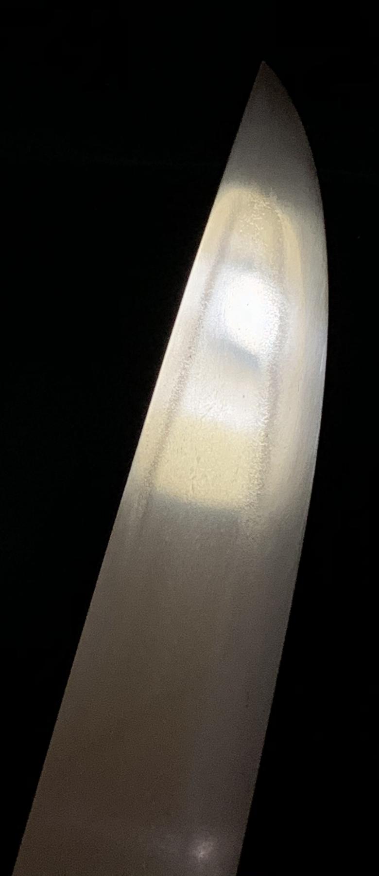

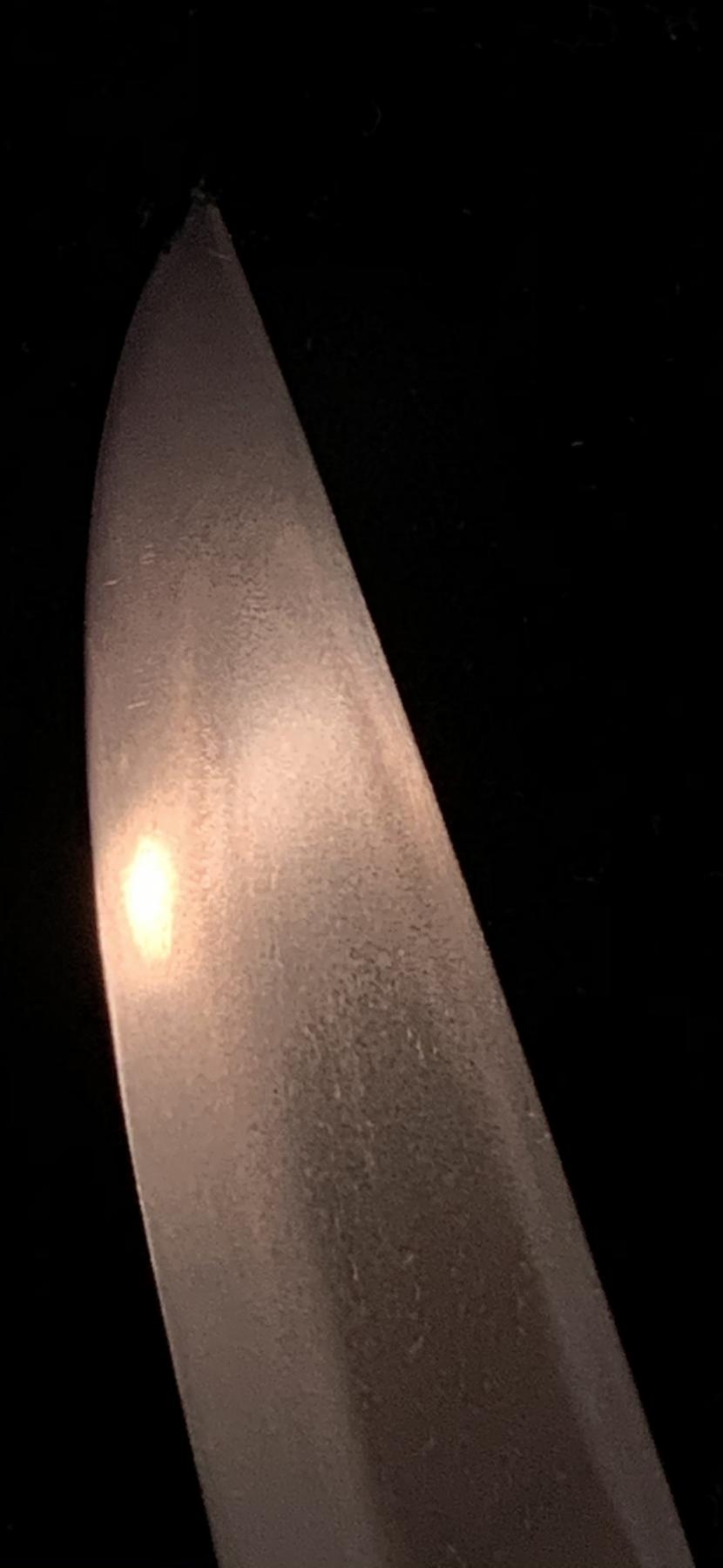

Finally had a phone call. This Bakumatsu Yoroidoshi is coming back from the Togishi and I should be collecting it tomorrow evening at the NBTHK meeting.
Made by 貞秀 Sadahide of the Dewa Gassan school, disciple of Gassan Sadayoshi. He seems to have had several names or titles including Unzenshi, Sugimoto, Konoshin Sadahide; I think the same smith may be listed twice, as two different people SAD 328 & 329 on the linked JSS.org database on the NMB. (?)
This blade was made for someone called Oshin, which may be the painter Kano Oshin, 1842-1907, who had once worked in the Ministry of War, (Hyobusho) 1870-1872.
Interesting story of the later school and swordsmiths here, despite some editing problems:
https://www.nihonto.com/the-dewa-gassan-school-%E5%87%BA%E7%BE%BD%E6%9C%88%E5%B1%B1%E7%B3%BB/

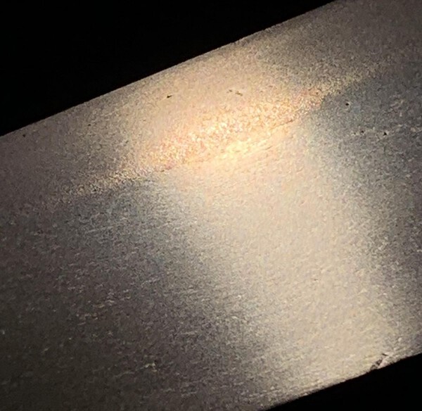

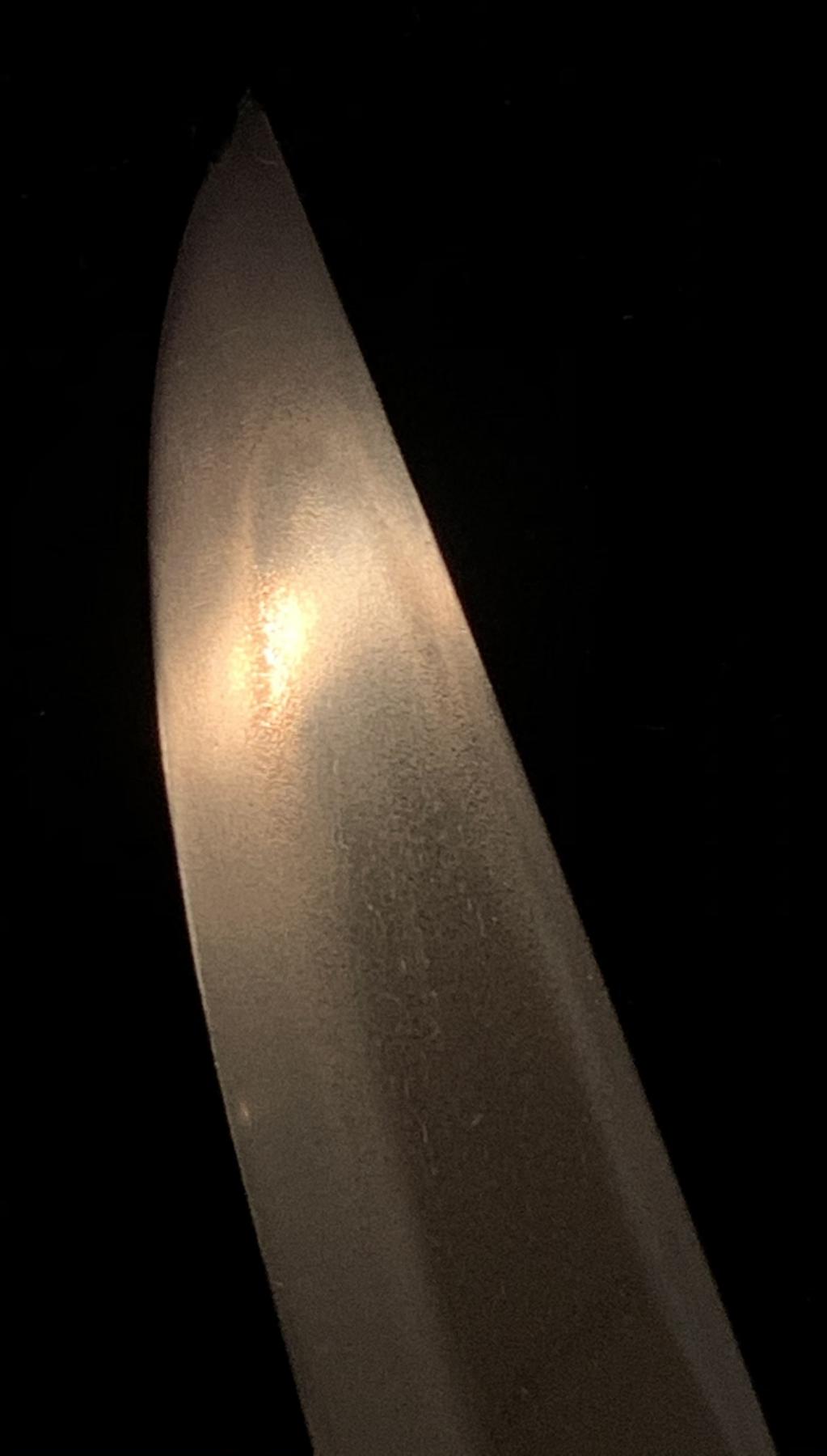

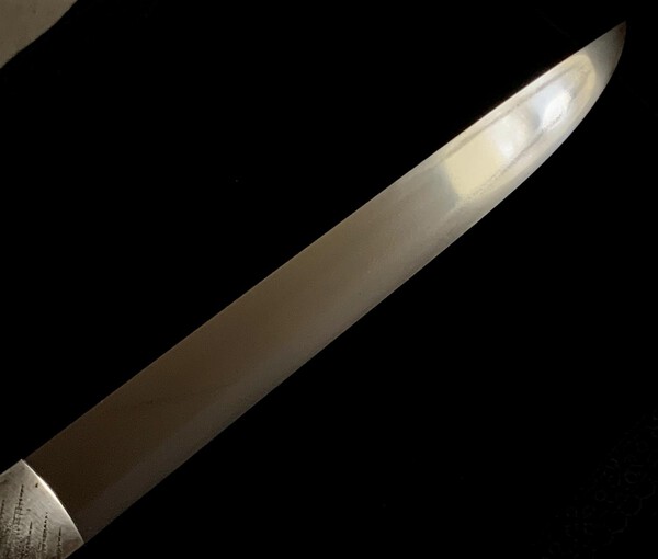

Very pleased with the job he has done.   :thumbsup: More sashikomi than hadori, but the nie-deki has come up beautifully, and those distracting grazes and rust spots have gone. He has managed to keep the thick kasane appearance of the yoroi-doshi.
Stupidly I mentioned maybe having a Shirasaya made for it, and got some blastback  :steamed:  from above.
"Why didn't you get the shirasaya made first? You do realize, don't you, that most shirasaya-shi, shirogane-shi etc., do not like working with newly-polished blades?"
Well, I do now.  :(
Hmmm... the spirit is willing but the flesh is weak, Brian.
It just so happens that I do have some secret ‘before shots’ of the nasty bits, but the quality of my photos is nowhere near the standards of your site. And to catch how it looks now would be asking me to up my game considerably.
