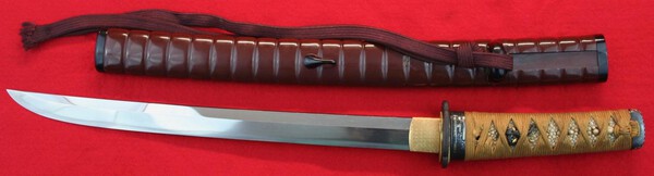

Seeking translation and comments about this Tanto

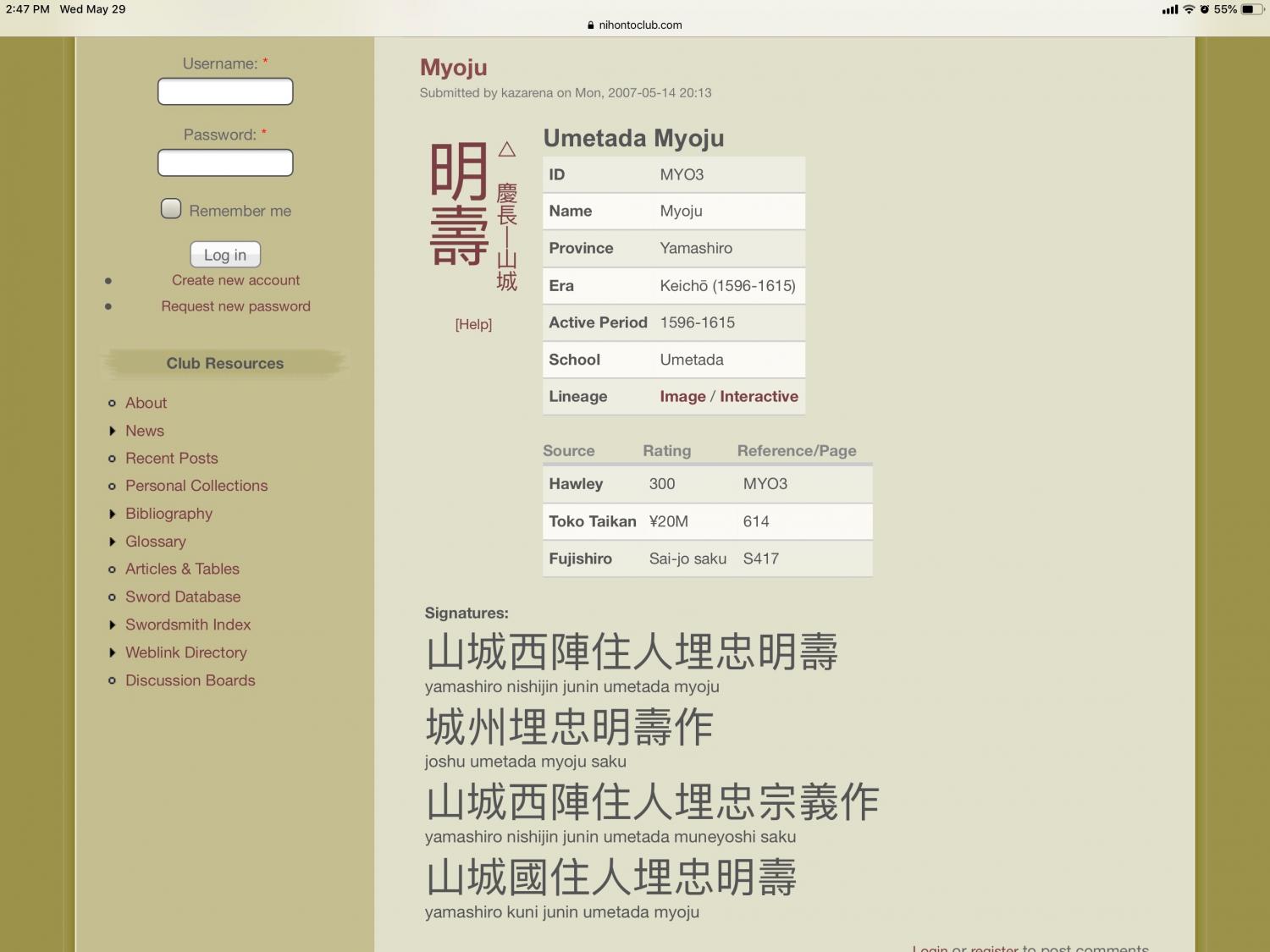

This is a recent addition. Most of what I know about it comes from the seller who described the Mei as "Yamashiro Koku Seitin Jyuu Umetada Myoujyu Saku Kanei 3 year". And he thought it ~395 years old. I've included a screenshot from the sword smith DB which is the closest match I can find based on name. Any help with the translation is much appreciated. The Fuchi, Kashira, Menuki set are Shakudou with fine minute gold highlights. I invite comments. TIA!

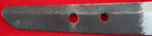

The signature is written without any elegance and with an uncertain hand, and also some really weird cutout made in the nakago just above it.
I would say not only the signature is bad, but also the nakago is essentially damaged in this appearance.

Maybe someone at some time thought it the real deal.  The habaki especially looks VERY interesting and I'm guessing it is gold foiled with a unique surface design (= originally expensive).  The seppa appear to be likewise.  What I can see of the fuchi suggests something interesting.  So, Harry, could we please see closeups of the fittings - habaki (blade collar), tsuba (guard) and the handle fittings, not forgetting the menuki, the little ornaments under the handle binding.  Oh, and do you have the kozuka, the little knif and handle that fits into the slot at the handle end of the scabbard???  Never mind gimei (false signature on the blade), a nice looking overall "package".

Kiril, I don’t see the cutout you are referring to on the nakago. I suspect that I don’t have enough experience to see it. Both sides of the nakago have writing and I am not sure which is the signature? Would collectors consider it a fatal flaw? A mutual friend of ours (Alex C.) pointed out a forging flaw near the hilt which I noticed but did not consider significant. Is that what you are referring to? I have much to learn here.

Not junk..a perfectly reasonable antique. But I don't think the signature is genuine of course. Still a nice package.
The patina around the signature does not match the rest. I think it was altered and re-signed. Not sure that is a forging flaw on the top of the nakago, but not sure what it is either.

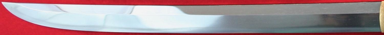

All in all, a nice blade in good polish it seems.

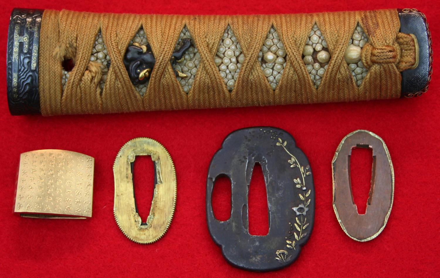

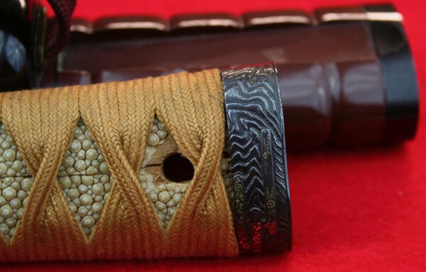

Here are a few photos of the fittings. The knife came without a Tsuba, Kogai or a Kogatana. I figure I can add them later like I did the Tsuba. It may take a while to find a good match. I think the fittings are Shakudou with gold highlights. I am impressed by the fine miniature detail. I've a couple antique Indian Dhal (shields) with excellent miniature gold and silver work, but this rivals or bests that. Thanks for your help!
Harry

One is date another one is signature, and where the signature is (ending in saku, the one before last image in the first post) the transition from the polished steel into the nakago right above the signature is unusual, its almost like a step. There are other things as well, which make one wonder what was done to the nakago.
Kirill R.
Kirill R.
Thanks Kiril. That bit of transition between polished steel and nakago is suspicious. Maybe done to hide a flaw or other signature?

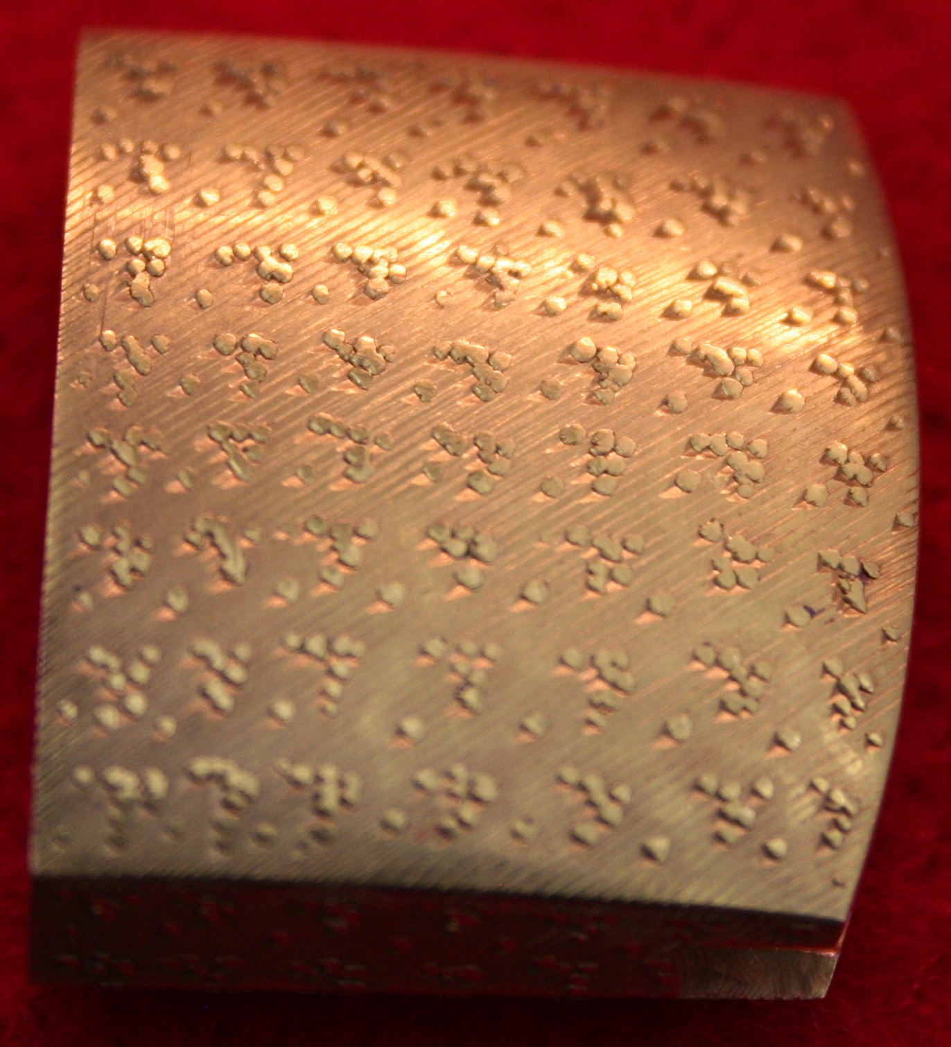

Harry,
is that HABAKI gold foiled or is it really solid? It is difficult to determine from the photos. In any case it is a nice one, as is the whole KOSHIRAE.
Harry,
Hi Jean,
I am not sure. It seems solid but it could just be plate. I'll post some better photos later today. I think I could see what's under the surface by scratching the inside if that is not a bad idea? I have those from time to time. :)
Harry,
I think it is plated, over copper or a copper alloy.
Harry,
you are probably correct. It is a nice (and valuable) HABAKI, but with gold foil (or even solid!), one would have to think about the value of the blade. Often, high-end blades are equipped with suitable components.
Harry,

Is there a signature on the fuchi?  If there is not one on the top surface, perhaps is there one on the inner surface?
It is unsigned. On the upside - the spot on the blade just before the Habaki I thought might be a forging flaw is just a deep scratch.
