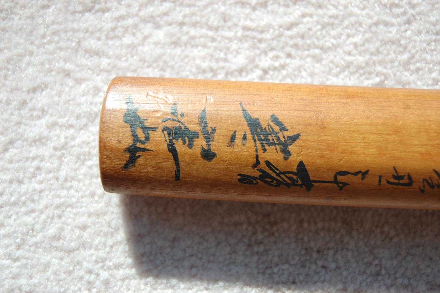

Surfson Posted April 21, 2019 Report Posted April 21, 2019 i realized a while back that over the last few years I have bought a few swords that have sayagaki by the famous Kanzan Sato a leading expert on swords and cofounder of the NBTHK after the war. I thought that I would share a few photos of the sayagaki and hopefully start a conversation about Sato sensei, who played a key role in saving Japanese swords from certain destruction at that time. 8 1 Quote

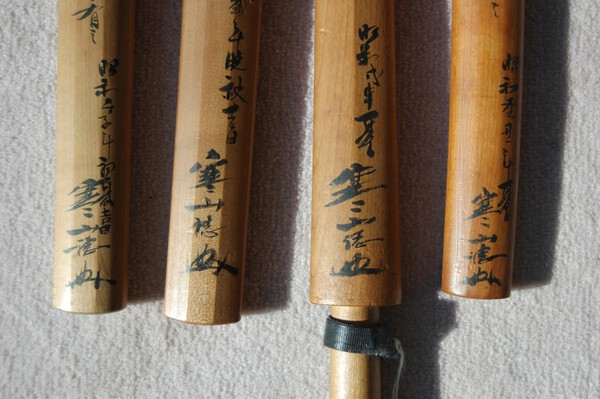

Surfson Posted April 21, 2019 Author Report Posted April 21, 2019 Here are closeup photos of his signature on each. The order of the blades is Sukekane, Fuyuhiro, Shimada, Muramasa. 3 Quote

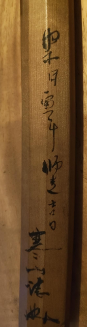

BIG Posted April 22, 2019 Report Posted April 22, 2019 Here is the 1968 Sato sensei sayagaki for the Naotane katana.. 1 Quote

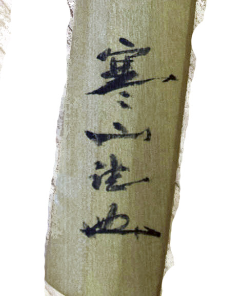

Cola Posted March 31 Report Posted March 31 Apologies for gravedigging an old topic, but am I correct in reading this as a signature by Kanzan Sato? 1 Quote
SteveM Posted March 31 Report Posted March 31 Yes, 寒山誌(花押) Kanzan shirusu (it means "written/recorded by Kanzan" with his monogram at the bottom). I don't know if its authentic or not. There are a lot of fakes out there. 2 Quote
Cola Posted April 1 Report Posted April 1 11 hours ago, SteveM said: Yes, 寒山誌(花押) Kanzan shirusu (it means "written/recorded by Kanzan" with his monogram at the bottom). I don't know if its authentic or not. There are a lot of fakes out there. Yes, I read about the fakes, it seems all the examples in this topic all have some differences so it's very hard to tell I think. Quote
SteveM Posted April 1 Report Posted April 1 If you show the whole script we might be able to make an educated guess. It's tough to tell from just the signature part. @MauroP is a pretty keen collector/admirer/student of Kanzan's writing, so he might be able to give you an opinion also. 1 Quote

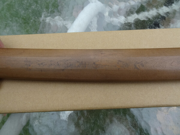

Oldman Posted April 2 Report Posted April 2 This may not be quite on point, but I have a sayagaki question. I have a rather old sword which has writing on the shirasaya that I would like to have translated. Unfortunately it is quite faded. I've tried photographing it in various light conditions but without much success. I'm including one of my efforts to illustrate the problem. Can anyone suggest a way to improve the contrast so that the characters are more readable? Would blacklight help? Or? Any ideas will be appreciated. Thanks! Michael BC Quote
Julien Posted April 2 Report Posted April 2 One technique I use is to invert colors. It is best to take a clear picture of each character and invert them one by one. It does not work everytime but this is really useful. You can also use it on fadded signature (nakago or tsuba)... The first two kanji as exemple Quote
Cola Posted April 2 Report Posted April 2 On 4/1/2026 at 3:04 PM, SteveM said: If you show the whole script we might be able to make an educated guess. It's tough to tell from just the signature part. @MauroP is a pretty keen collector/admirer/student of Kanzan's writing, so he might be able to give you an opinion also. Sure! Is this clear enough to make a guess? Quote
ROKUJURO Posted April 2 Report Posted April 2 I think I can read NORIMITSU. Probably a KANZAN HAKOGAKI. Quote
