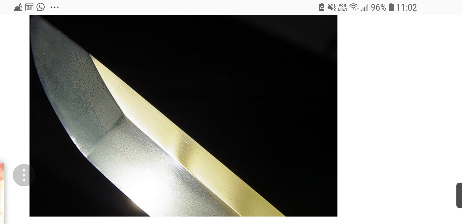

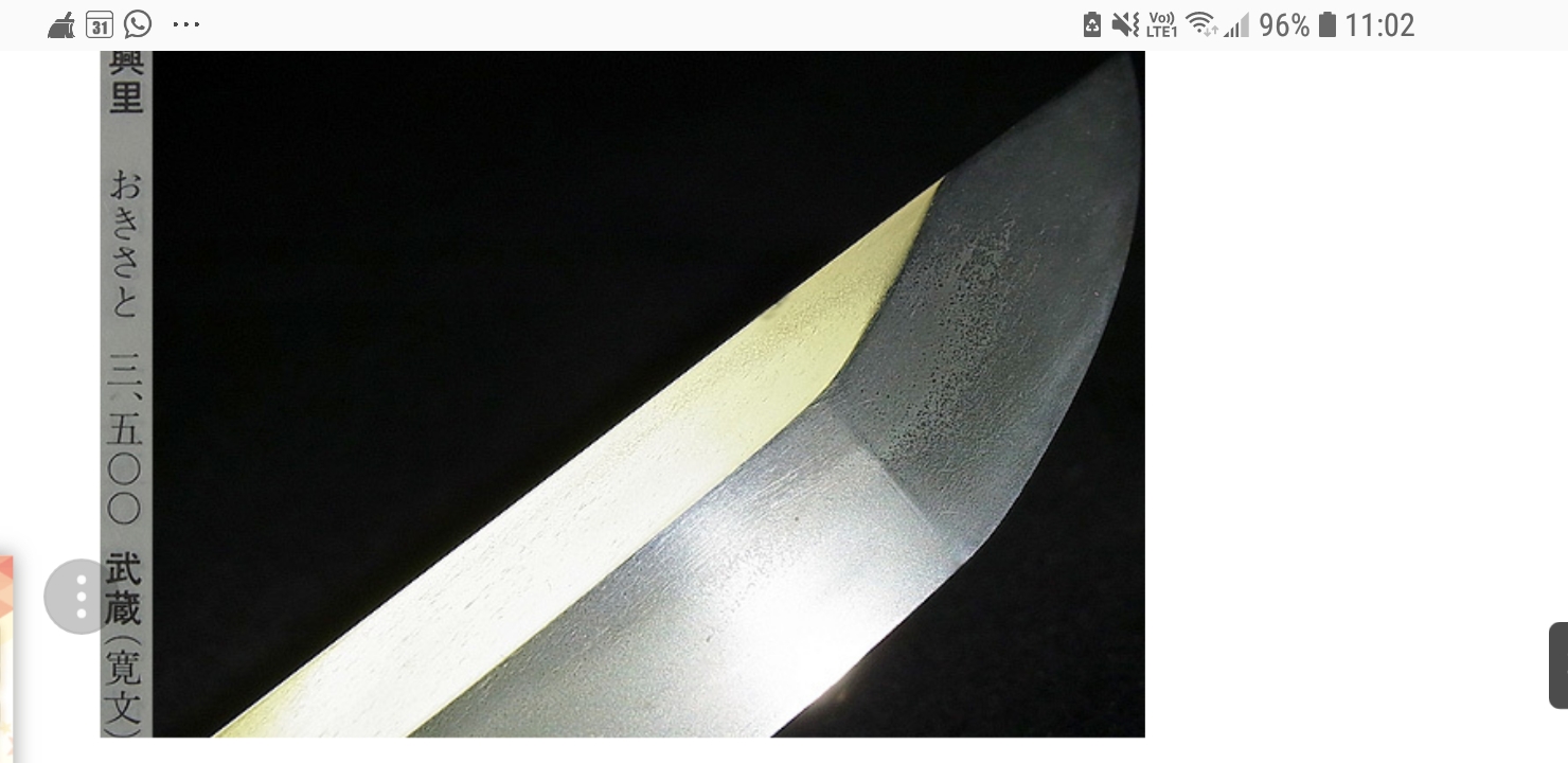

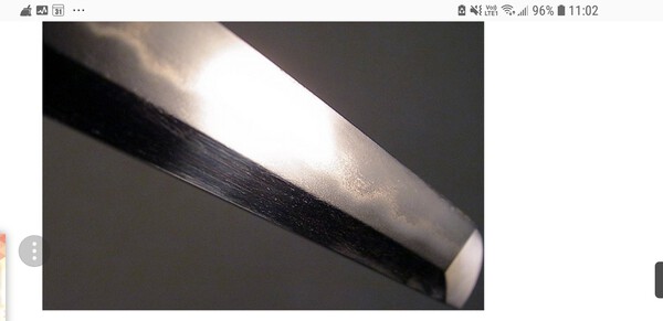

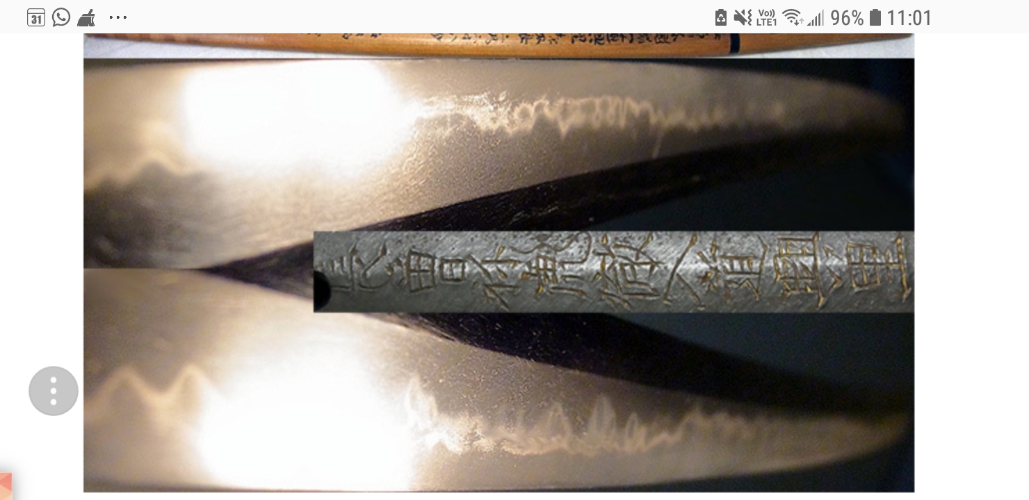

Fung Posted January 20, 2019 Report Posted January 20, 2019 Gentlemen, authentic Nagasone Kotetsu in your professional opinion? Quote
paulb Posted January 20, 2019 Report Posted January 20, 2019 Dear ? I am afraid I can not offer an opinion certainly not a proffessional one, but consider the following: Nagasone Kotetsu is one of the most copied smiths in history. There is a large number of swords carrying his signature circulating around the market. Some of the forgeries are extremely good and have fooled many people for a long time. Some that have been authenticated in the past are questionable today. The problem is made worse by the range of and differences in his signature throughout his working life. To establish the authenticity of your sword would require a great deal of study of the mei and I for one don't have the skill to make that determination. If this sword is coming out of Japan unpapered or with old papers be very cautious. If it is a local find that is unpapered then put it in for shinsa. without an up to date paper it is unlikely that anyone would be confident in establishing it's authenticity. 4 Quote

BIG Posted January 20, 2019 Report Posted January 20, 2019 hmfung325, please tell us more about the sword and its history. What about the measurements? Have a look at Markus book Shinto & Shinshinto-Kantei and check the authentic Kotetsu. Esp. the mei is different to your sword. Best and welcome on board Quote
Stephen Posted January 20, 2019 Report Posted January 20, 2019 Peter from the pix id say its o Yahoo auction. 1 Quote
CSM101 Posted January 20, 2019 Report Posted January 20, 2019 It is one of those auctions on ebay Japan: https://www.jauce.com/auction/m309813516 We discussed it many times, so when the question comes: Good or bad? I give a short answer. And then I would expect a followup question: Why? And then we can start to explain. Uwe G. 2 Quote
PNSSHOGUN Posted January 20, 2019 Report Posted January 20, 2019 A good looking sword regardless but one highly doubts it's a Kotetsu. Quote
Fung Posted January 20, 2019 Author Report Posted January 20, 2019 Hi all, thanks for your valuable comments, much appreciated. I’m not sure whom I can ask so I come to ask the question on this forum, my first thought is the Mei looks good and near the original one provided by the seller with his sword reference book. but when it comes to Hamon I could find no information. Actually I faced some difficulties to do my research on the subject of Japanese swords here because in my city there is no book and only very few studies Japanese swords. I tried to research on Kotestsu online but too bad I can’t find good info. Quote

Tom Darling Posted January 26, 2019 Report Posted January 26, 2019 Neither mei is good. Hope you have better luck. Tom D. Quote
