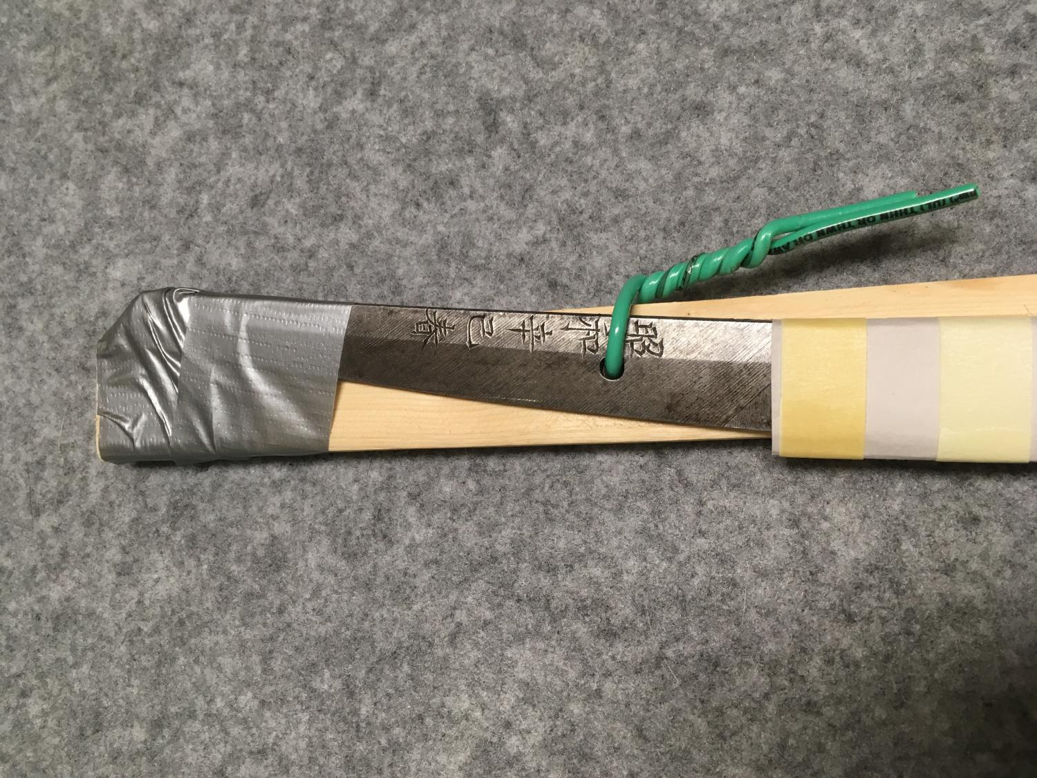

Bruce Pennington Posted October 2, 2018 Report Posted October 2, 2018 Chris, I understand your hesitation, however many of us send and recieve blades regularly, and it works out fine. I've used both US Postal and Fedex with no problems (only problem was with USPS to Australia. They contract with Emerates, who refuse to accept blades). Mailing a blade without koshirae, requires care. I use David Hofine's method of wiring the blade to a 1x2 board, then paper, packing tape, and good padding in the box. I'm posting a pic of mine that I sent for polish. Quote

Chris A Posted October 3, 2018 Author Report Posted October 3, 2018 Chris, I understand your hesitation, however many of us send and recieve blades regularly, and it works out fine. I've used both US Postal and Fedex with no problems (only problem was with USPS to Australia. They contract with Emerates, who refuse to accept blades). Mailing a blade without koshirae, requires care. I use David Hofine's method of wiring the blade to a 1x2 board, then paper, packing tape, and good padding in the box. I'm posting a pic of mine that I sent for polish. I thank you Bruce. Still trying to breathe here, and moving very carefully. Conferring with family after while. My guess is one of us will be going out of state for a few days for an appraisal. Mailing may be a less expensive option. This is why I would like to know what potential value could be. Quote
